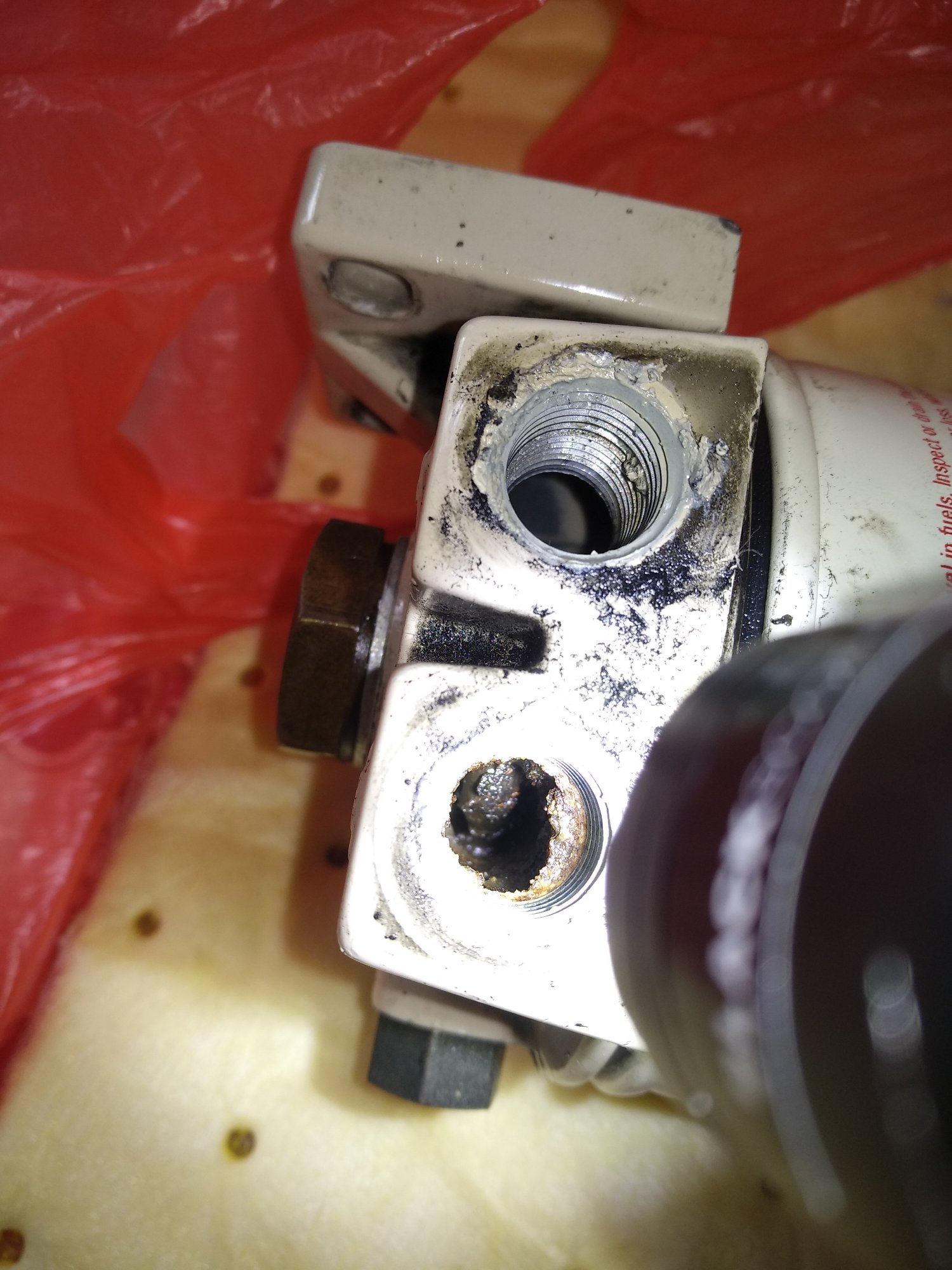

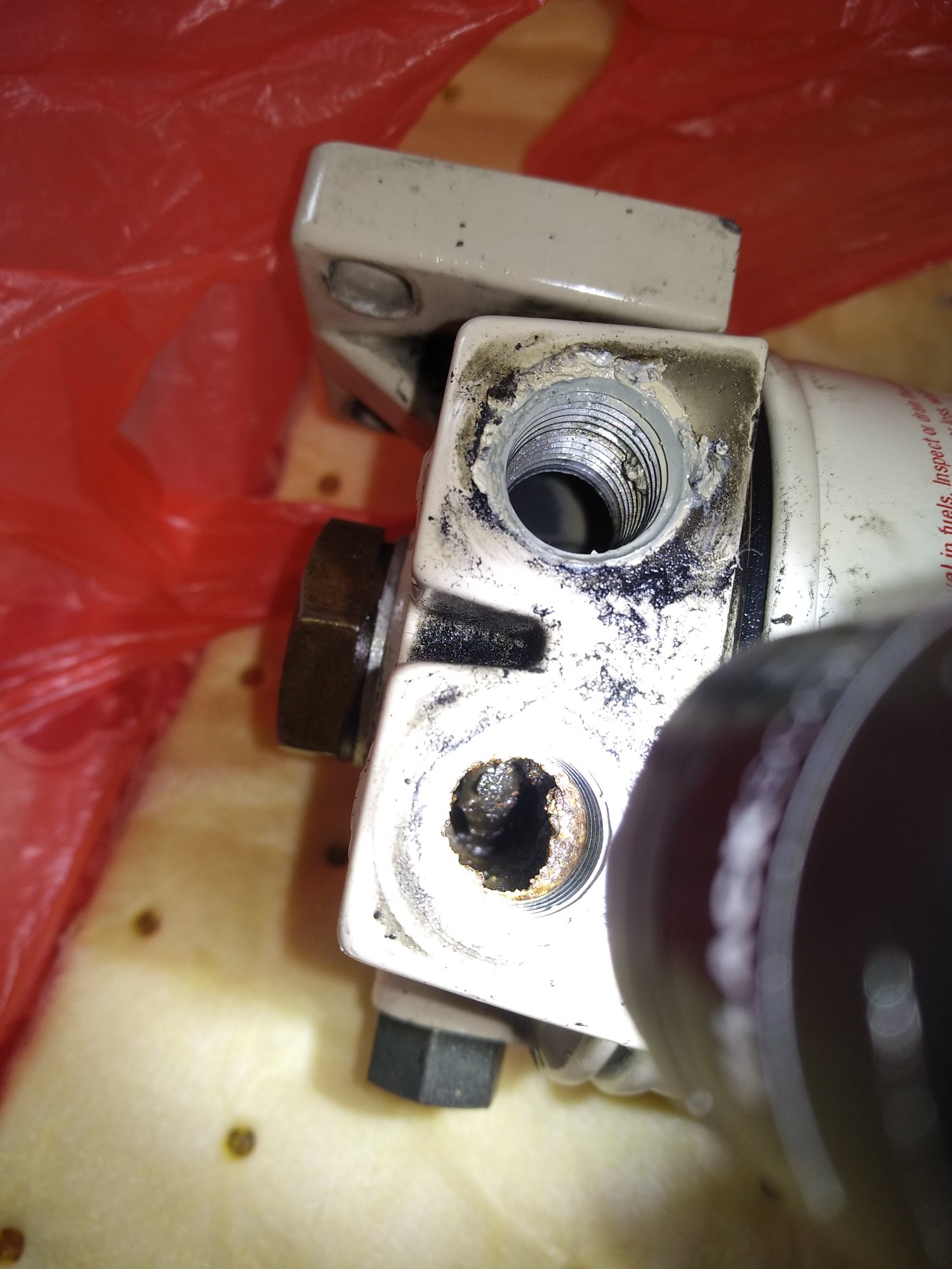

Racor filter head could be fouled. That's what happened to my engine. I polished fuel, changed brand new filters 3 times for just in case, changed Fuel Lift Pump, changed fuel hoses, send for service both Injectors...all to no luck. Was planning to dismantle high pressure pump but decide to disconnected fittings for Racor filter head, surprised to find little fuel flow out. Found lots of gunks foul the head.
Yours may differ but worth a check before you start doing other bigger stuff like I did.
See photo. One side is fouled up.
Ken Y
Likes: Ziggler
