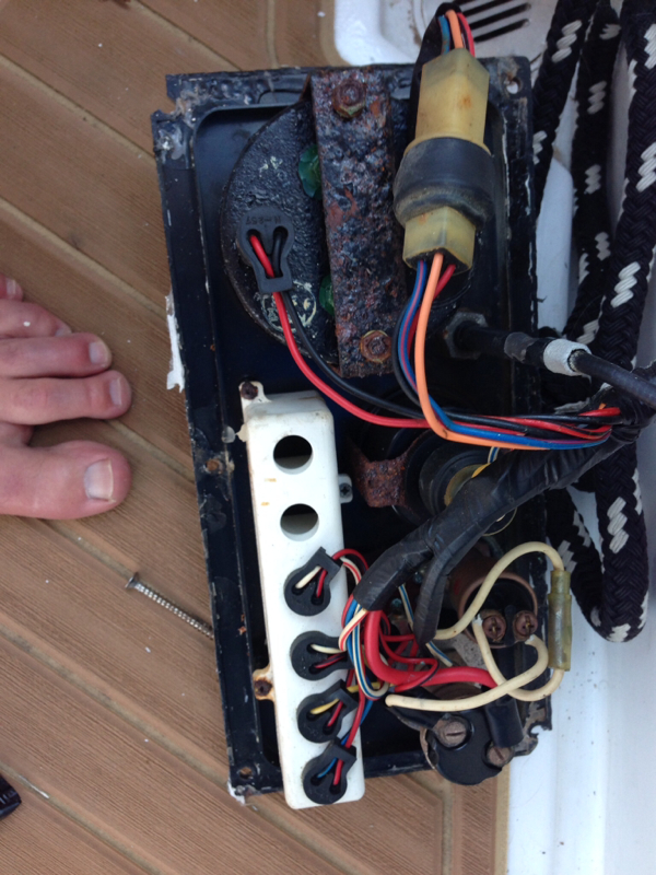

I put in a new panel for aesthetic reasons (and it was falling a part). Once you get the panel off the bulbs are easy to change. I would check the connections there before I ran around chasing things in the wiring harness, mine worked but were pretty corroded. Also, you should have a switch there that when you flip it down it lights your tach and when you flip it up and hold it all your other light should light up (oil pressure and water temp). There should be an extra bulb in the panel once you get it off.

Well strangely enough connector to the tach seem sound . What was add though is that the bulbs behind temp and oil had been completely snipped and the wire re-run to aftermarket temp and oil which don't work at all. Looks like I will have to unhook the aftermarket stuff and rewire the original to find out if they work at all. Painful.
