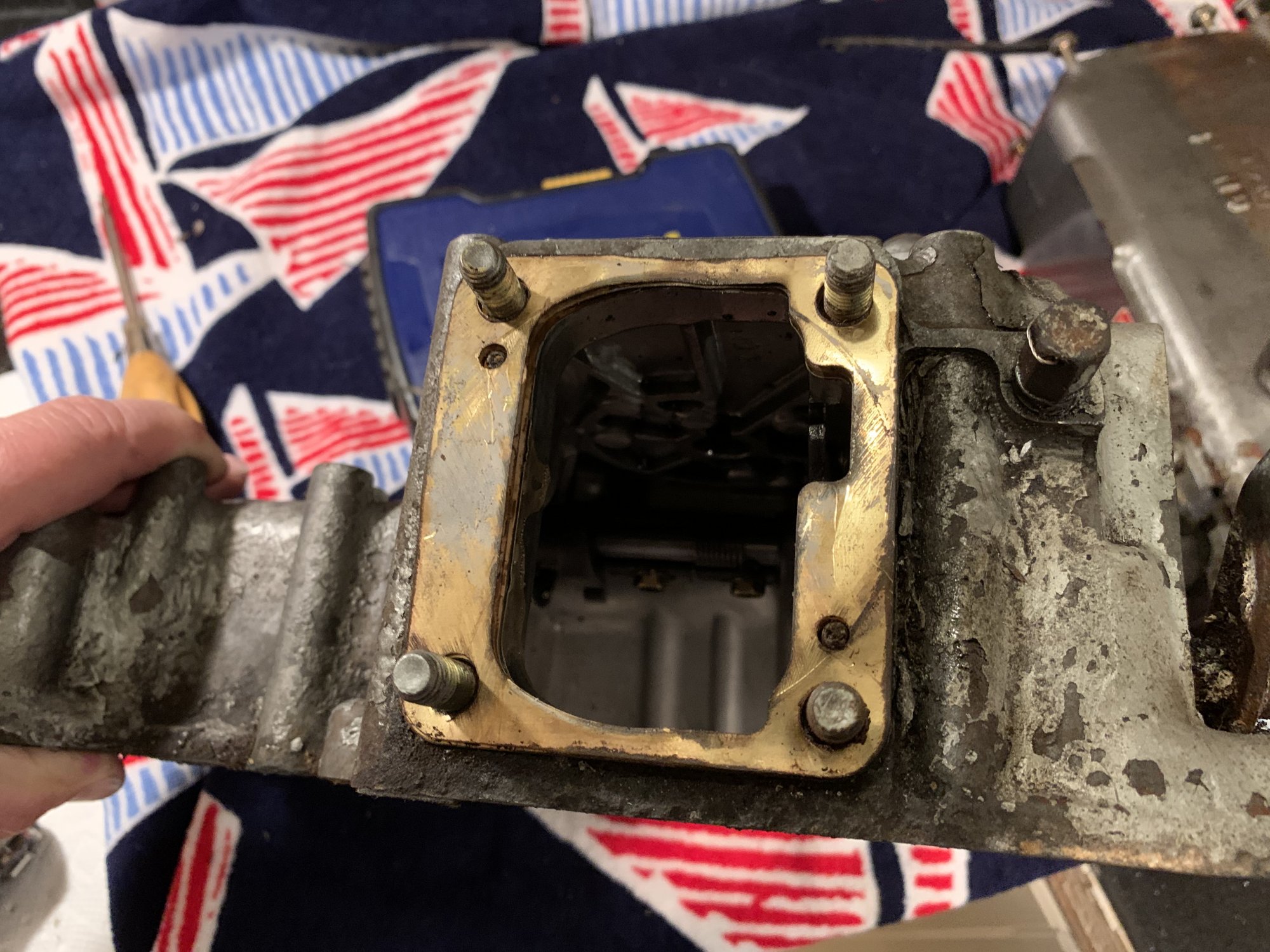

As I've said before, I'm taking my gear case off to replace the gasket and hopefully repair an irritating oil leak. To do this I have to take the fuel lines off so that I can lift the injection pump body clear from the gear case. I definitely don't want to do too much because the timing appears t be very sensitive and I don't want to open a can of worms!

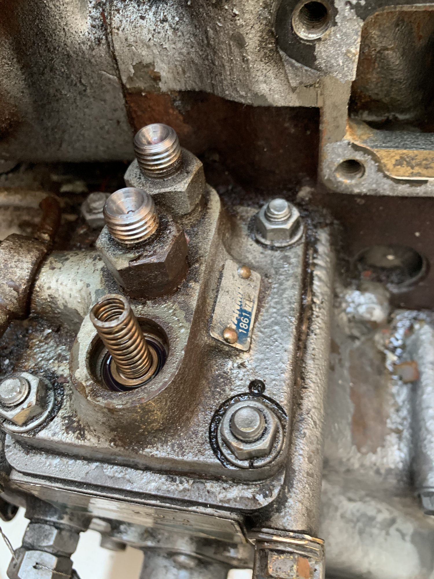

I started to loosen the nut that connects the high pressure fuel lines on the first delivery valve. I found that I needed to hold a wrench on the delivery valve spring holder to keep the assembly from turning, which was bending/crimping the line. So I got the first one off and realized that I would need to remove the spring holder to get a wrench on the 2nd holder. After I got the 2nd line off, I found that I could get the 3rd line without removing the 2nd holder.

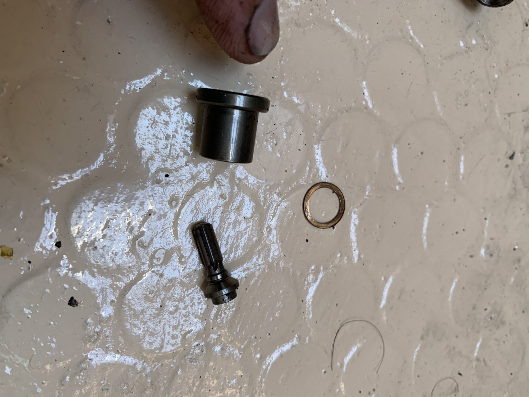

So that part is good but I got a little curious about the components. I lifted out the delivery valve, the packing, and the valve holder.

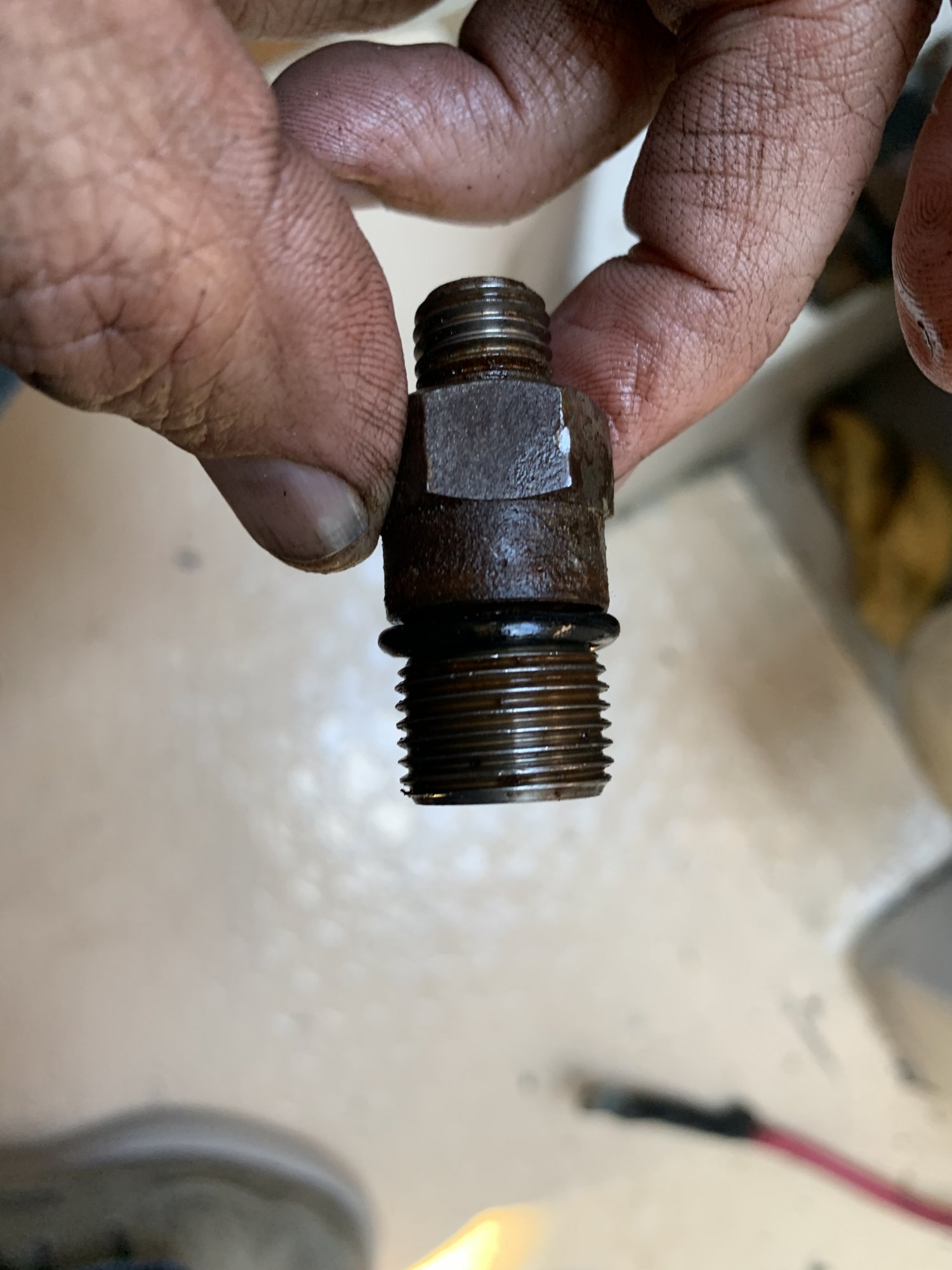

I see there are some tests I can perform to verify if the delivery valve is functioning well. You can see there is a lot of debris to be cleaned off the engine. I was able to lift that particle out with a tweezers that you can see in the photo below. But I'm worried about infecting the system with dirt by opening each of these valves. Other than the one that I pulled apart, I don't have to open the other 2. Is it worth opening and checking the condition of the valve, the delivery spring and the valve holder, or is something I shouldn't touch if not necessary.

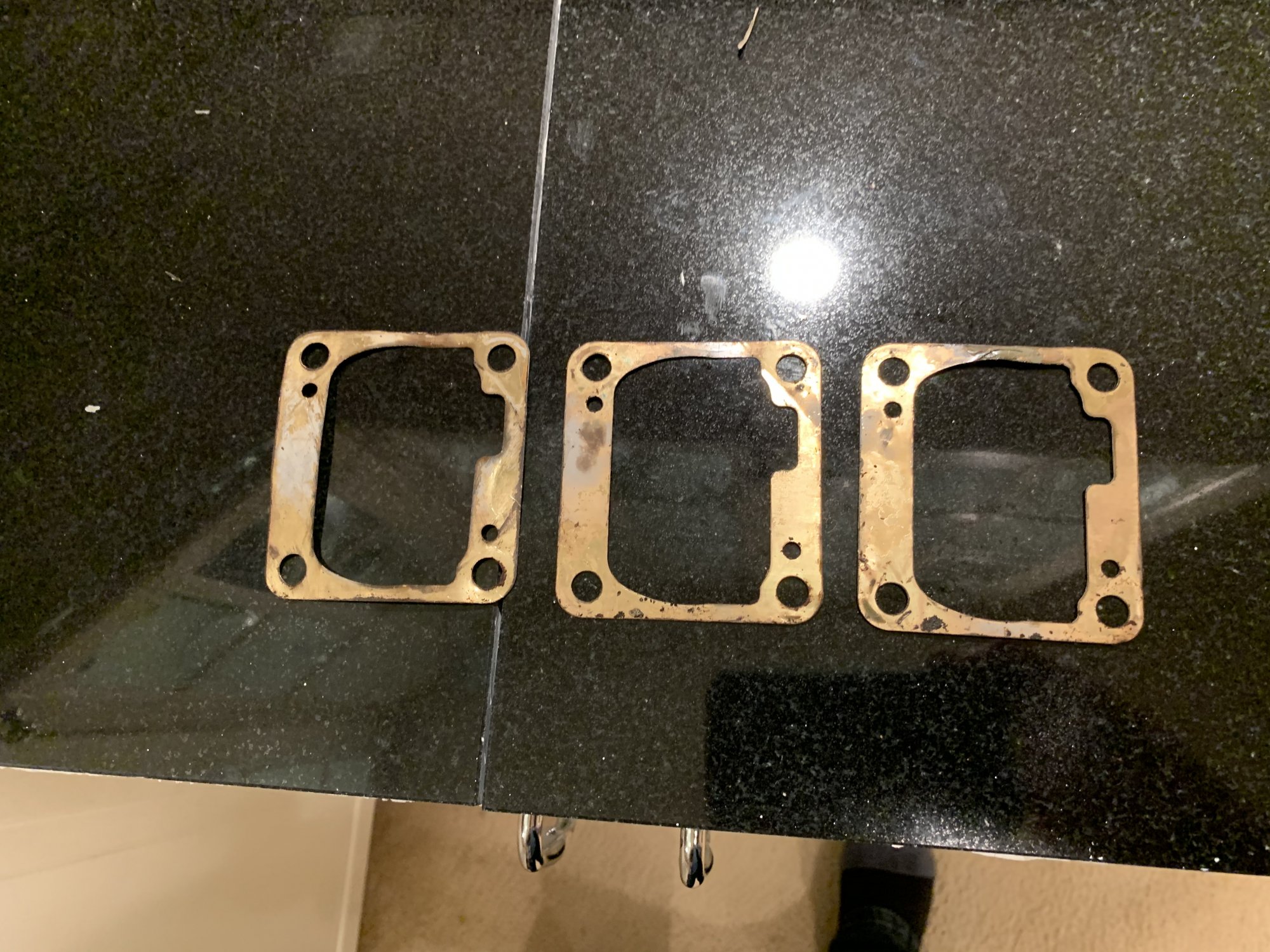

I'm most concerned about messing up the timing. The instructions say that the timing adjustment shim under the pump body is critical and a lot of care has to be made not to mess it up. Also, the parts can't be miss-placed from one injection to the other and the plunger shims in particular should not be changed. To mess it up means having the pump adjusted offsite with a injection pump tester. I don't want to go there ... I know that the delivery valve and the holder have to be paired so I would be careful not to mix any pairs.
