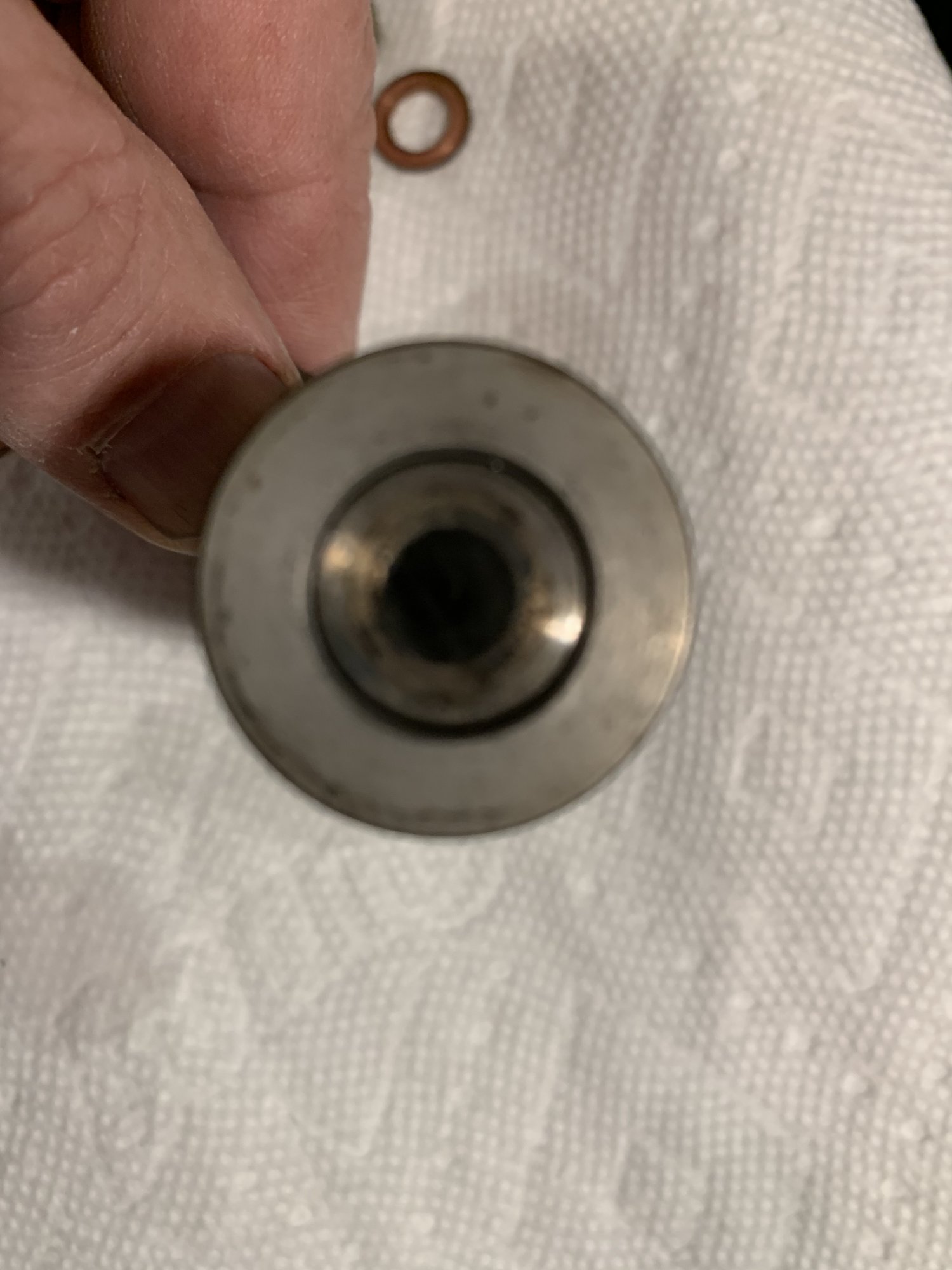

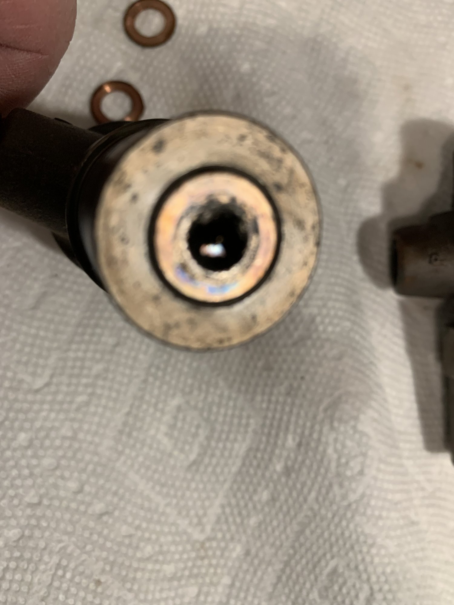

How do these look?

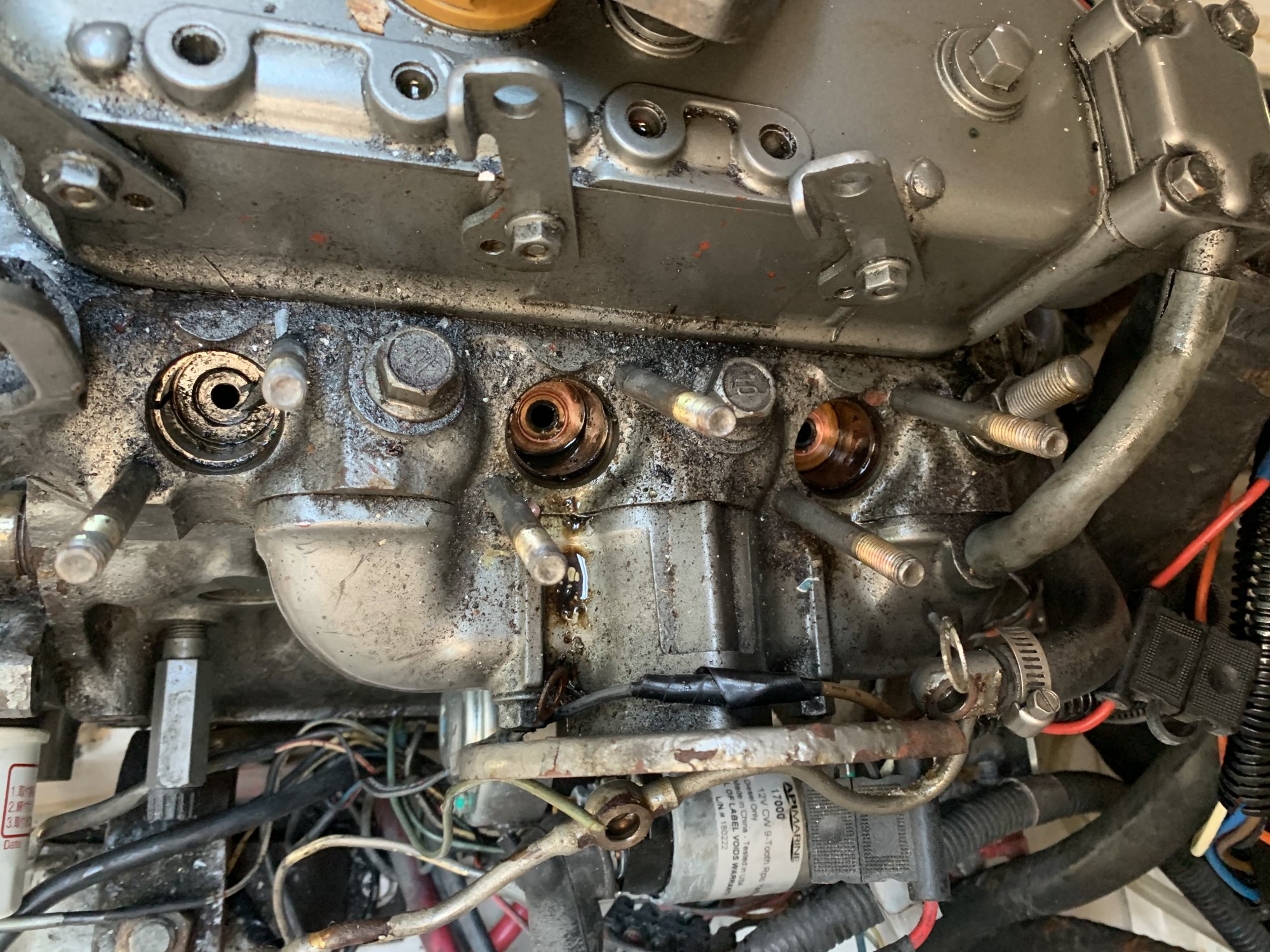

I'm also worried about exposing these openings to dirt & debris cause the engine has a lot of that right now. It's difficult to clean it without getting these parts out of the way first. :facepalm: It looks like the 2 openings on the right have fuel pooling above the opening while the one on the left looks dry. I'm tempted to wipe it clean if I can but I'm afraid to do damage, too. There seemed to be a lot of gunk surrounding the body before I lifted it out and it dropped in.
Is it worthwhile to take the nozzles someplace to have the spray condition checked? The manual shows what the spray should and should not look like. Is it worthwhile to simply replace the whole nozzle injection assemblies? Do they cost a lot?
Jan 5, 2017
2,464
Now that they are out I’d have them checked ( not very expensive ) rather than replaced ( very expensive). The copper crush washers need to be replaced however.

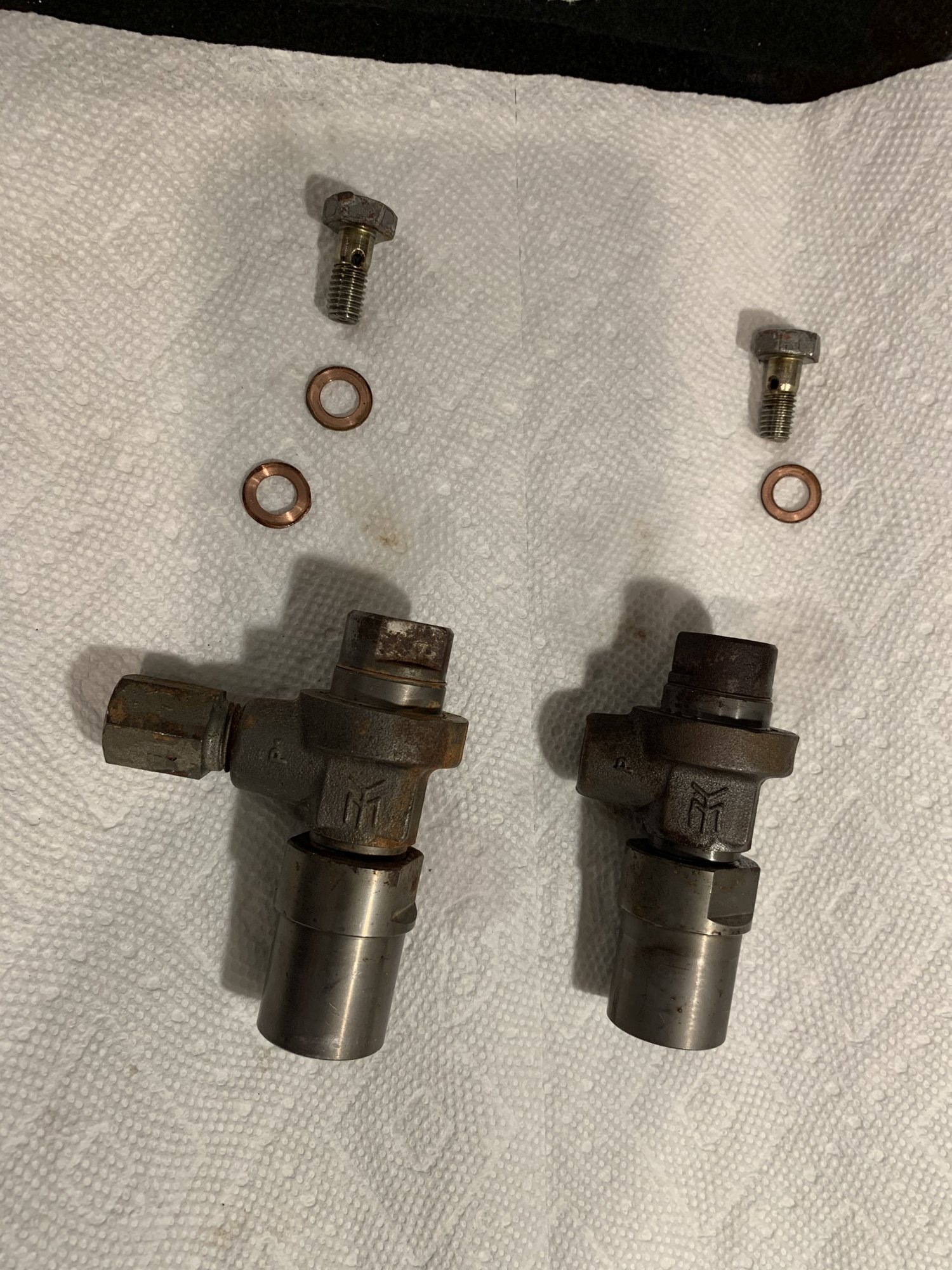

Those are the washers in the picture? I was wondering if there is a reason why I found 2 washers at 2 injectors and just one washer at the third. Also does it matter which location, because I'm not sure which one just had one washer. It seems like one would be sufficient ... they were found at the bleeder screws. Is their only purpose to prevent leaking?

The copper washers seal the joint. Should be two on each banjo bolt. The spec. torque crushes the copper to provide the seal. One below the bolt head and one between the parts being sealed.

scott, the banjo bolts at the top are for the return fuel feed. they are not to be used to bleed the system ever. on my old perkins anyway
if loosened, new washers used, every time. i bleed by loosening the fitting on the fuel line entering the injector. again, on my old perkins
Same on mine and the old Universal. If you break the seal you need to replace them.

Scott are those banjo bolts out of the top of your injectors? Then just one washer, maybe. The connection to the high pressure pump has two on my engine. I love my service manual. If you don’t have one down load, beg, borrow or steal one.

Are they just brass washers? I might have a size detailed in the manual, otherwise, I suppose I'll just find a source to match.
Duh ... copper!
May 25, 2012
4,338
they are copper crush washers. any dealer will have them i'm sure

Regarding cleaning the engine: I would clean around the injector holes with a Qtip and get some bolts the size of the injectors and screw them into the holes to seal them - you don't want that crud in your engine. Then you can finish the clean-up. Looks like someone spilled some oil when doing an oil change as there's oil in all the low spots.

And the OP is right to be concerned about grunge getting into the injector holes. Def plug those up and then vacuum them clean, and then stuff a clean rag in there to keep it clean. You ARE supposed to replace ALL copper washers. But I couldn't get a couple of the crush washers to come out of the injector hole - even after trying with a pick. I talked to a mechanic and he said that as long as I didn't damage the washer I could reinstall the injector, torque, and then start the motor. If I get no fuel leakage, it successfully resealed. If I DO have leakage I'd need to pull that injector and figure out how to remove the copper washer. He said that was very common. Would love to hear any tricks for getting stubborn crush washers safely out of the injector hole. I saw one video where a Mercedes diesel mechanic made a special tool to do it, but didn't sell the tool. It is a common problem with diesels, apparently. He REALLY had to haul on one to get it out of an old Mercedes motor. It made me cringe. And he had lots of room to work.
