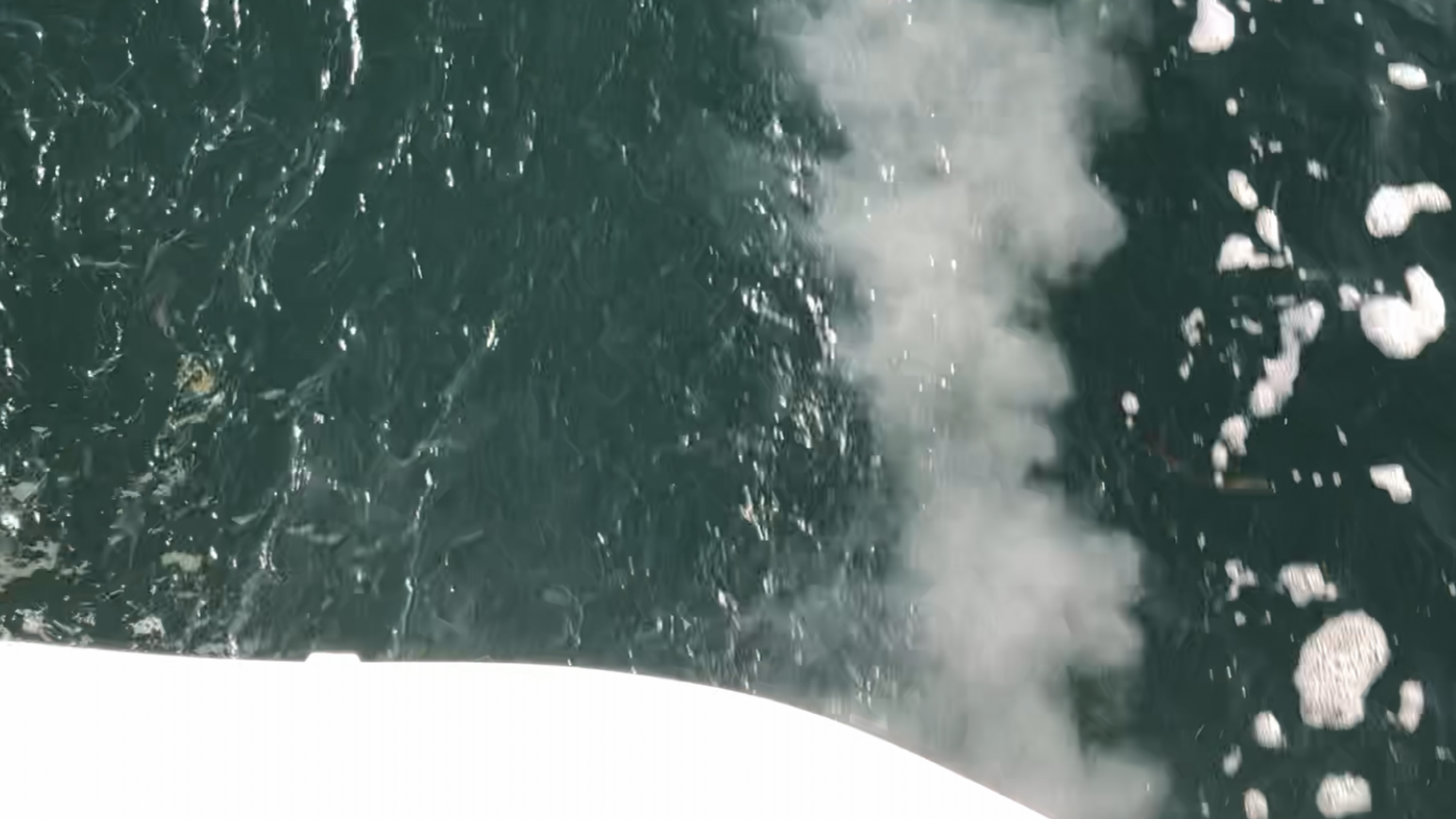

Has anyone experienced this on their engine? The engine is 18 years old and the meter shows 1100 hours. It starts first time, doesn't blow smoke when it's tied up to the marina and run at full power. I've only noticed it after motoring along at about 2000rpm for a while. I've only owned the boat a few months, so I don't really know how long it's been doing this.

Looks like steam vapor to me.
Check your water flow injection to the exhaust riser. A restriction in sea water flow can cause this.
Does the exhaust still "spit and surge" on exit of the boat?

What happens when you operate at higher rpm? When was the mixing elbow last replaced? Are you getting sufficient water coming out of the exhaust, if not you may have a clogged mixing elbow? Have you checked coolant level? Lots of potential causes like a fouled mixing elbow indicating a need for replacement and others identified in this article: The 3 Causes of White Smoke From A Diesel And What To Do Next - Learn Diesels
Same question came up on this thread with lots of potential causes identified: White smoke in exhaust-Yanmar diesel | Sailboat Owners Forums

Thanks for the replies. I did wonder if it was steam. It dissipates very quickly behind the boat. The engine is also running at about 175-180 degrees, which seems hot, but I'm not sure what the normal range is. It is discharging water through the exhaust, but I'm not sure it's enough. The coolant level is fine and doesn't change.

I also suspect the mixing elbow is causing the white smoke. Restricted flow of water into the exhaust elbow could raise the temperature of the elbow to the point that the water will be vaporized and exit the exhaust as steam. Also, the restriction will most likely cause the engine temperature to rise because of the reduced water flow through the heat exchanger.
Take the small hose off the top of the elbow and check for a restriction. If nothing is obvious there, you may need to remove the elbow for inspection.

175-180 is typical for diesel inboards and is not, by itself, a steam generating temperature. Yes, a restriction seems probable. If you take a rag and carefully capture some water from the exhaust (to avoid getting a burn, not with bare hands) is that exhaust water really hot? What kind of water quantity coming out?

Title says 3GM, not 3GM(F), so I presume it’s raw water cooled? Assuming that’s the case 175-180 does sound warmer than normal for raw water cooled engines. I agree with the others that it sounds like a cooling water restriction. In fact Nigel Calder’s book says “White smoke at high engine speeds and loads is almost certainly water vapor, most likely caused by reduced cooling water flows—check the raw-water system.” Also keep in mind that when looking at troubleshooting guides for land based engines they generally won’t consider any raw water cooling, so problems like that will be overlooked there.

Not the engine temperatures , but the Exhaust manifold can make STEAM.

It is a 3GMF. I contacted a Yanmar dealer and they told me that when the thermostat is fully open, the temp should be around 185, so it doesn’t seem too hot. Thanks for all the suggestions. I’ll test them out in the next week or two and post an update when I work something out.

8
