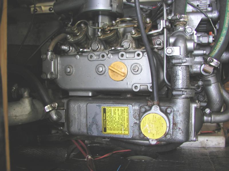

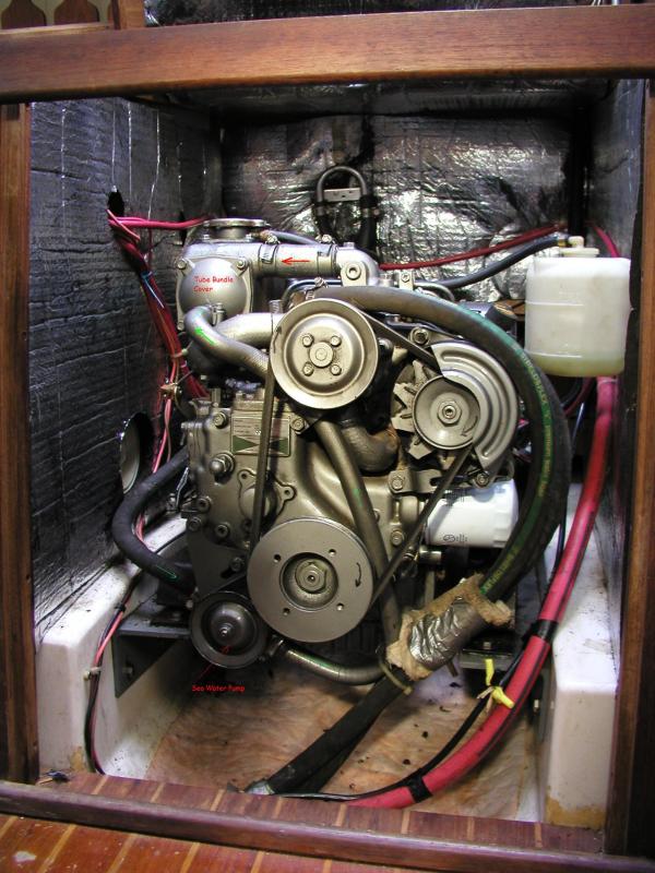

Here are two shots of the connections on my 3GMF. Top shot .. green stripe hose connects to a nipple on top of the water pump. Other hose connects to a nipple under the thermostat.. You should have plugs in those locations where you can thread in hose nipples. Water goes out from under the thermostat through the heater, then back to the suction side of the water pump.

that's very helpful. Thank you-
I wish I had similar access round my engine, they must have used a shoe-horn to get mine in..
