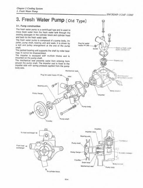

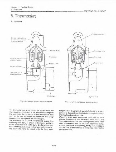

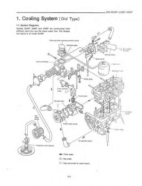

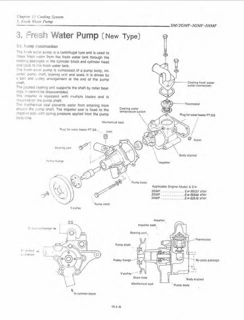

OK, just returned from testing and can confirm the following:
1. It's not a problem at the water heater, either a blockage or the tempering valve (I confirmed flow and bypassed the valve).
2. There are two water pump designs: old and new. Old, which I have, has the coolant SEND above the thermostat, meaning that nothing goes TO the heater until the thermostat opens. The new style has the send below the thermostat.
3. With the engine running at 2,000 and cold, there's nothing coming out of either of the heater coolant lines.
4. When the thermostat opens (verified by the warming of the hose between the thermostat and the reservoir, and of the reservoir itself), there's still no significant flow to the heater.
5. Eventually, once everything gets good and hot, there's flow. I suspect it takes this long because the coolant flows past the bypass outlet, and takes the less-restrictive route through the cooling system.
So, I either need to buy a new pump (not thrilled about this) or figure out a workaround.
10,219
Reverse the positions of the temp switch and the heater outlet pipe like Dan's engine picture shows and it will work MUCH better. The thermostat creates a pressure drop even when open that will force much more water through the water heater. The engines before serial # 5548 didn't have the extra tapped hole. That is in the pump body bracket. My engine (6897) apparently has an extra threaded hole on the front side of the pump body bracket (thermostat housing), which ya can see in the picture.. Good luck with it, ZDS ..

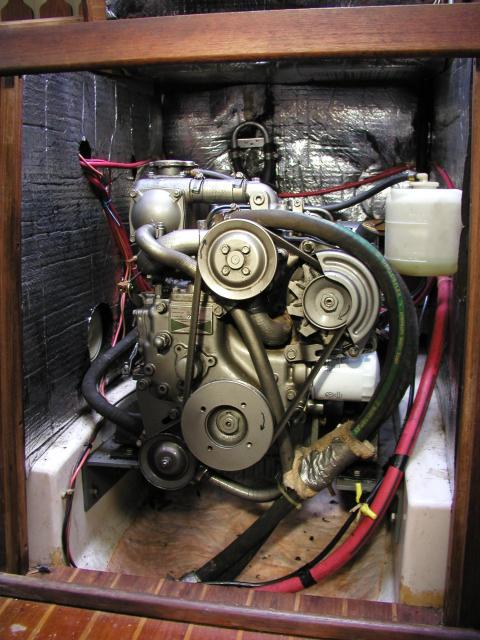

"Nother note.. here is a picture of the front of my engine. You can see that where your "out" to the heater is, on my motor is plugged and the switch and the heater connection are both in the pump "body bracket", below the thermostat. The downside of putting the temp switch downstream of the thermostat is that if the thermostat fails closed, you will overheat and not get an alarm. Thermostats normally fail open. Lots of folks suspect that they may have failed closed but it is VERY rare. I have experienced three fail open on cars and not one fail closed in the 44 years that I've been working on 'em. Yes, I did change the one in my 3 GMF two years ago.. it was operating properly when I tested it .. but I found stuff in my heat exchanger..

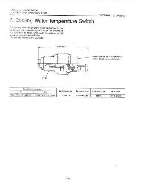

I broke the electrical connection on the thermostat trying to disconnect it in advanceof the move. Total bitch. But, I'm now thinking of replacing it with a guage sender in a tee, if I can find one with the right threads.
10,219
ZDS, pretty sure that the fittings are 3/8 Pipe Thread.. surprisingly not metric.
10,219
The new temp sender switch is part # 127610-91360 .. The thing turns on at about 220 F and off at about 205 F.. color of the cap is brown..

Looking straight down on the thermostat housing. You can see the hose that comes over the alternator (upper one of the pair) is going in where your temp alarm switch is located.. and on Dan's picture, you can see that his temp switch is in the outlet elbow, downstream of the thermostat.. My return hose is in the same place as yours is, on the water pump suction. Dan's is there too.
10,219
K, 'nother note and I'll stop.. Notice how Dan and my hoses do not rise any significant distance over the hose fitting elevation. I see yours have a good bit of vertical loop in 'em. It would be good to get those things to lie flat so ya don't have big air traps in the hose.. The pump might be having a hard time getting the water over the hump initially.. The engine needs to be spun to around 3000 RPM for a few seconds (like 10..) to get enough pressure to blow all the air out of the heater and hoses.. I think you'll be happy with the heater after ya get the hoses corrected.(The major problem is the fitting location, I think, and the hose loops aren't helping) Good luck with the work, ZDS

The plan now is to replace the broken temp sensor with another of the same type (for the dummy light), but to reinstall it above the thermostat. The heater loop will go in the space the sensor occupies now, with a T fitting and a dial sensor. That gives me a dummy light and a gauge.
I just wish the whole thing wasn't in an exotic thread size...

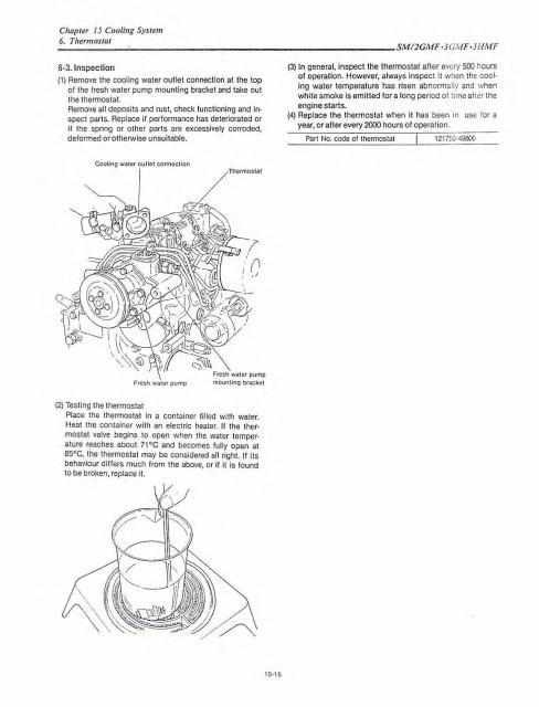

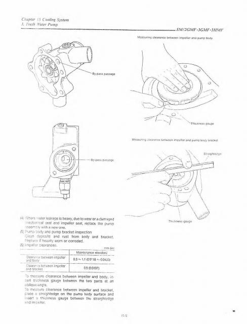

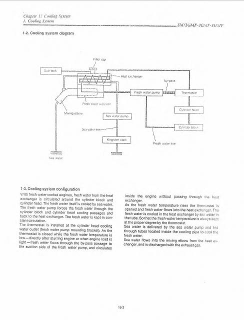

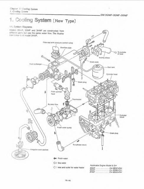

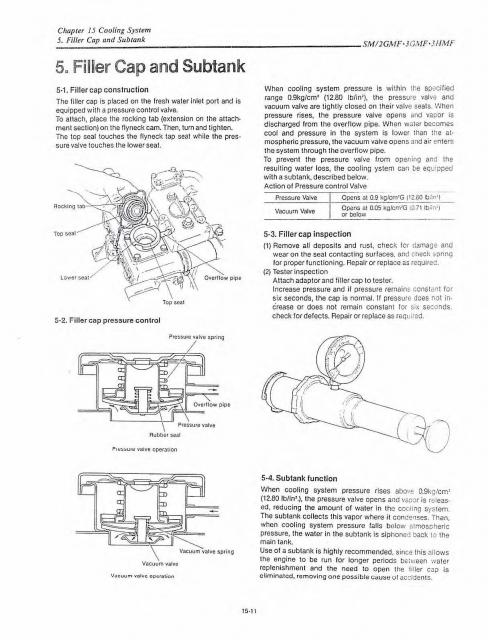

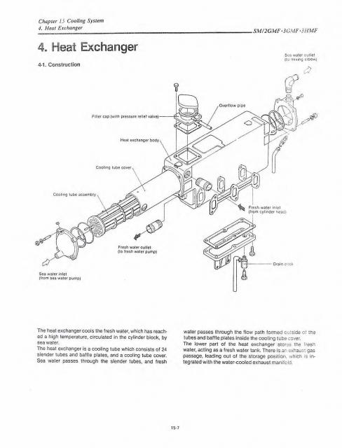

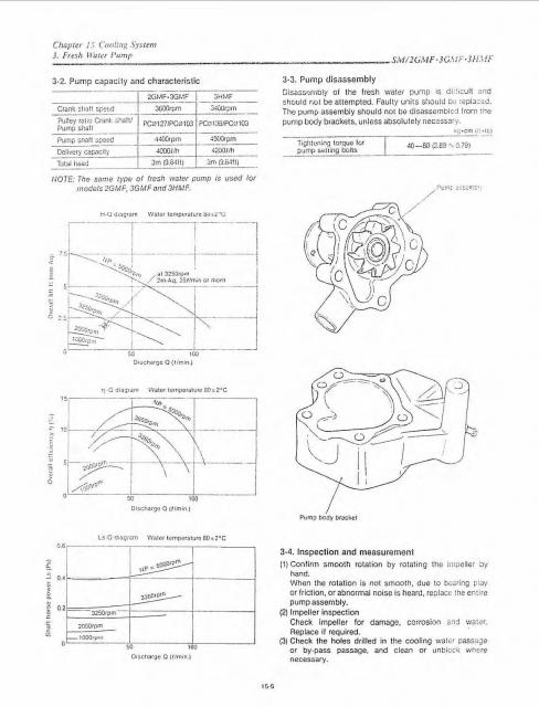

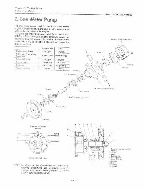

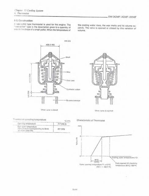

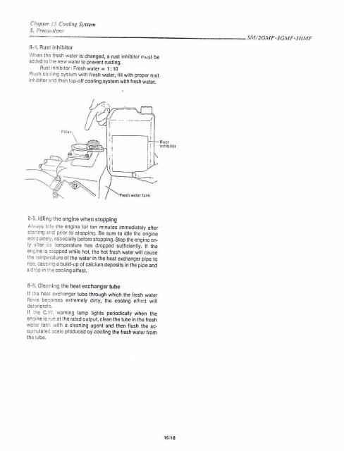

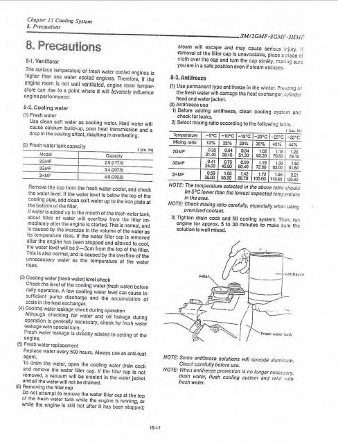

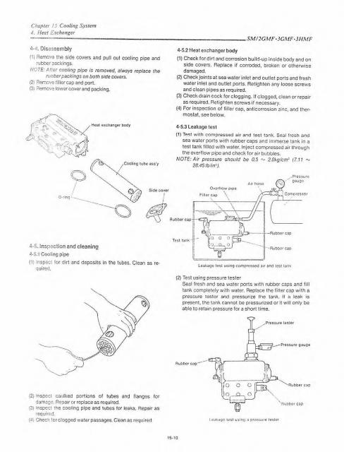

Yanmar Service Manual Excerpt
As a public service, I'm posting a scan of the relevant section from Chapter 15 of the Yanmar Service Manual. A combination of this manual and the comments in this post have helped me figure out this situation.
