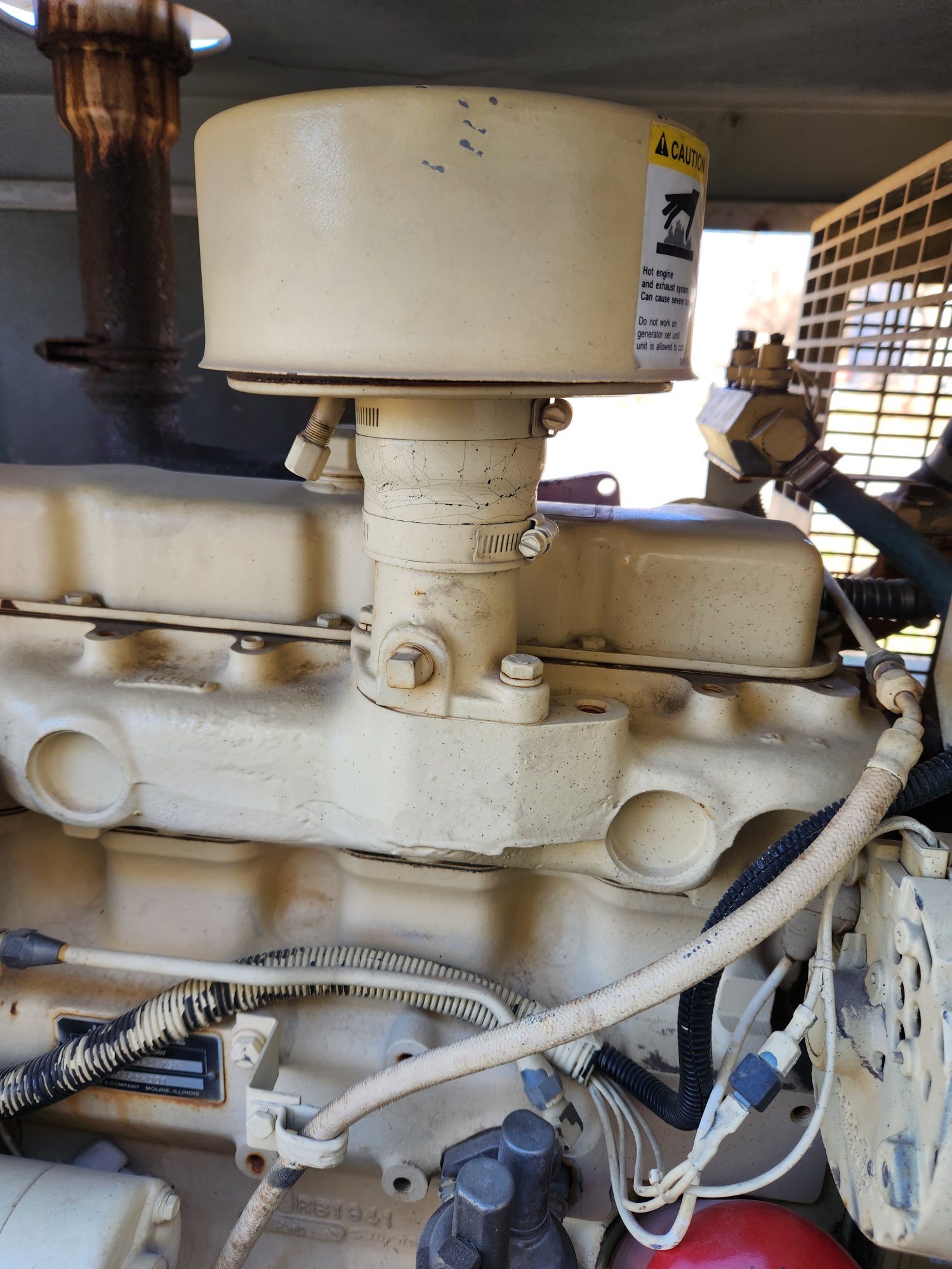

The picture is of a diesel that's running as I type this. Notice the complete lack of a throttle plate assembly under the air filter, because it doesn't have one.

That's correct for a gasoline engine.
Would love to hear your explanation why opening the throttle lever facilitates cranking the engine.
