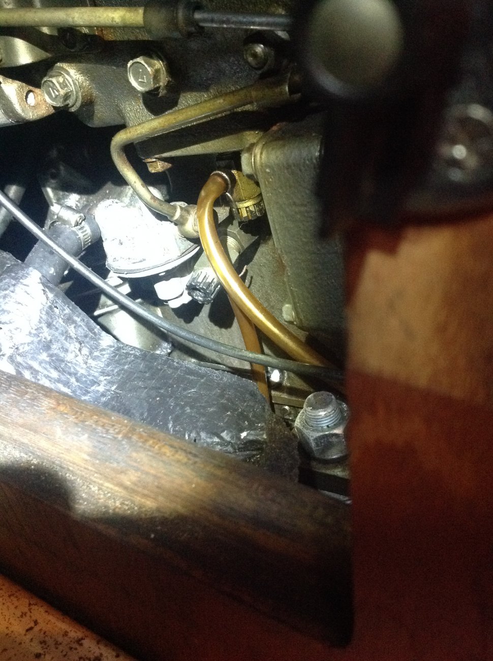

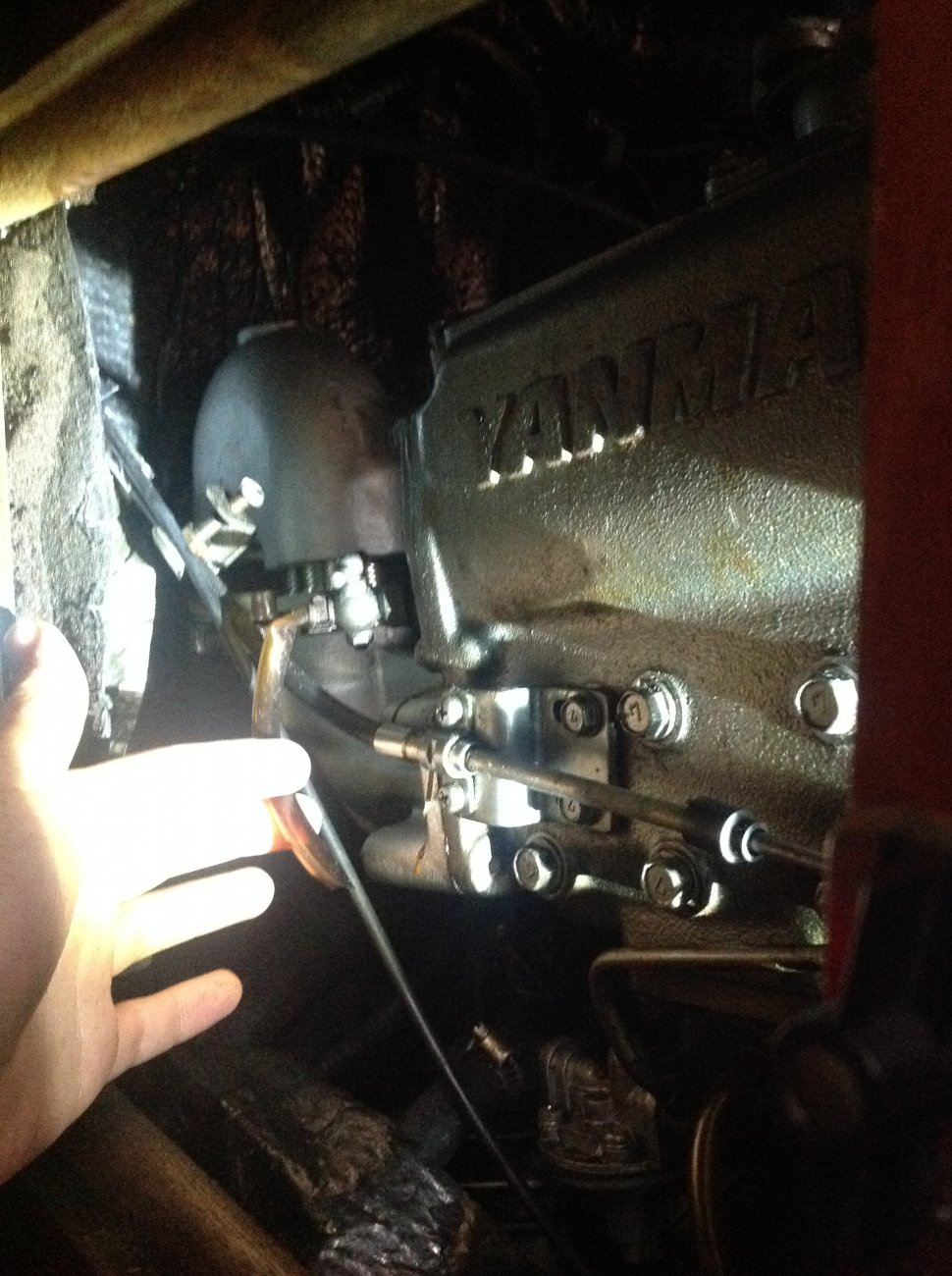

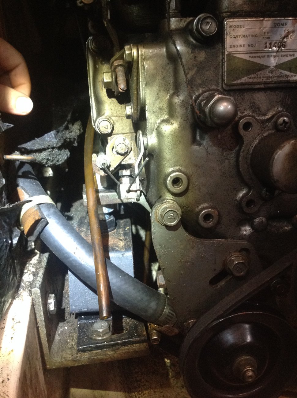

Thank you that helps. Also I found a few of these copper colored tubes coming out of the radiator that don't look they are attached to anything, looks like they just drain. 2 of them are at the bottom and 1 at th top. is that normal? Here are some pictures:

10,095
Yup, those are drain tubes.. they are labeled in the picture..

Thanks for the welcome. And appreciate the diagram. Do you all th drain tubes drain the coolant? Or air?
10,095
Pretty sure the rearmost one drains seawater from the heat exchanger tubes and the others drain coolant from the heatex housing and block.. The seawater (raw water) one would have to have the front water supply hose removed to let air in to let it drain ..

They drain the coolant. Use a container and open each up. Makes flushing system easy.....

Those hoses are the drain petcocks used when you want to drain the coolant from the engine block. Put the end in a bucket or empty gallon milk jug, open the petcock and the antifreeze and water mixture will drain. Be sure to replace the coolant will the same type that came out.

You may find that the drain valves are frozen. In that case just remove them for possible repair or just replace. Also, if you open the drain valve and nothing comes out poke a wire up into the drain to clear any sediment. You must also open something upstream to admit air for draining. Pull out your thermostat for inspection as well. Then clean and bandage your knuckles.
