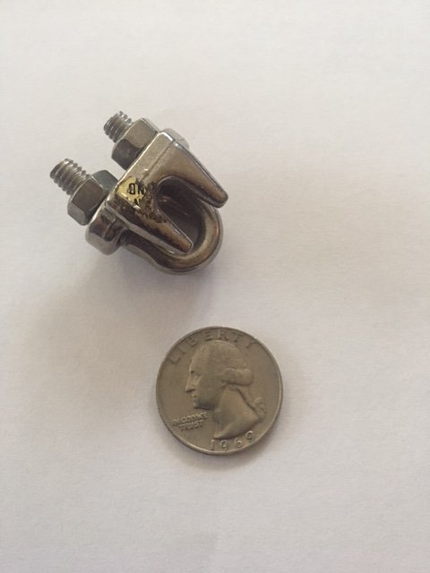

Consider this. Same as Tricia said just not $25 USD
We all know control cables have an outside sheath and an internal wire. The internal friction is pretty low. So - and this works every time - put a small (see below) cable clamp on the control cable upstream from the throttle lever in the motor compartment. Tighten the clamp a bit at a time. The clamp compresses the outer sheath; the friction on the inner wire increases; and the internal wire will not creep any longer. Don't overdo it just tighten a bit at a time until throttle creep is eliminated.
