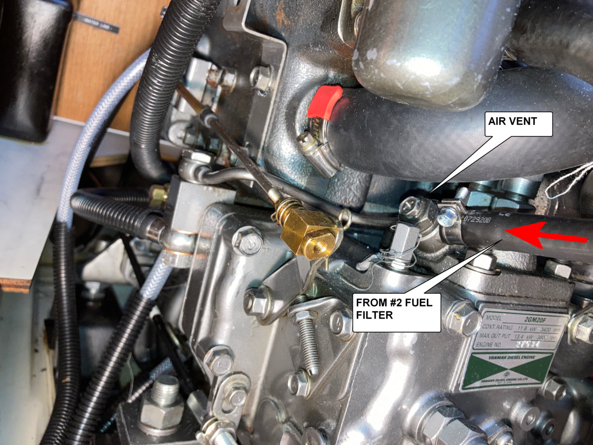

In this case, methodical would be starting at a possible tank filter screen. Tear it out and throw it away as far as you can. Next, fuel in the tank, make sure it's full. Next, check every joint in the line. You're lucky in that it sounds like you have a good hydrostatic head to help you find leaks. If in doubt, wrap the joint in paper towel, tape in place, and look for stains after a few days of sitting at the dock.

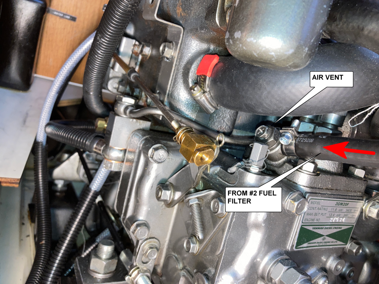

An bleed point I recently discovered is located at the entrance to the high pressure injector pump. Yours may look like this if it's a later model as is my 1998 and has a drain line to catch any vented fuel :
If it's an earlier earlier model, it may not have the drain line after the bleed screw and then allows any vented fuel to drop to the floor under the engine.
If you're still getting erratic running, it may be time to vent fuel and any air from the high pressure connection to the injectors. Use extreme caution as detailed in the manual.

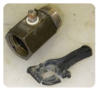

I went to shut off the fuel line before pulling the line and it was in the 90 degree position. Noooooooo.....did I really not open the freaking fuel line from the tank before getting the motor ready to start.
You can avoid this problem from happening again by ensuring the valve handle is in the OPEN position and then taking a ball peen hammer and smashing off the handle. You'll never have to worry about making that mistake again :

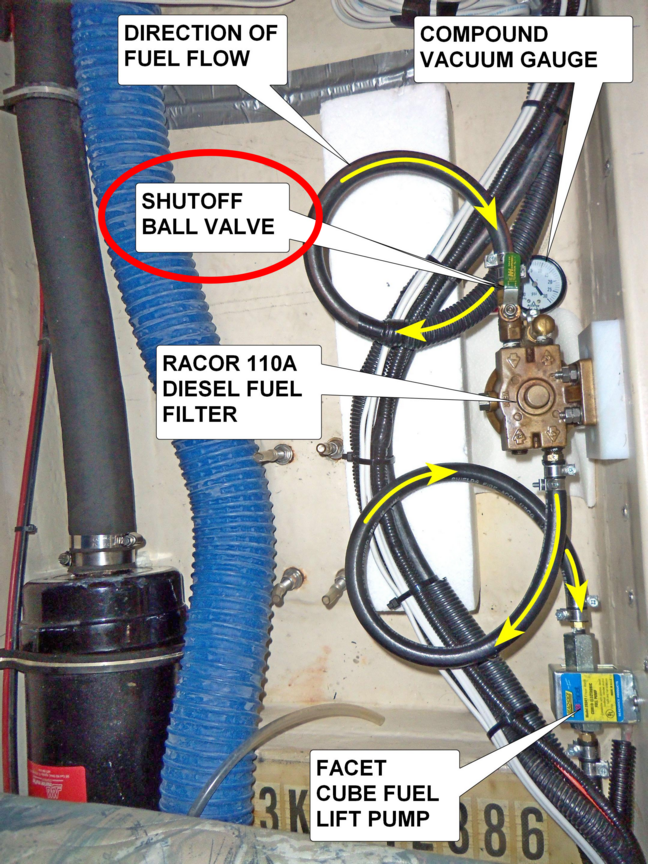

I added an in-line convenience shut-off valve right at the inlet to the Racor primary filter/separator. Never have to touch the valve at the tank and there’s less hose to bleed.

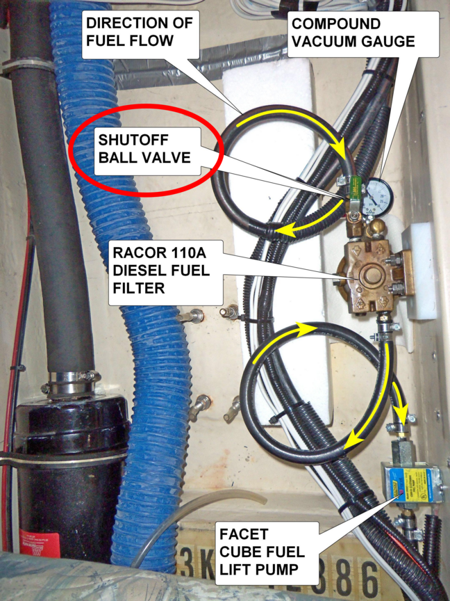

Anyone who does their own fuel filter changes and doesn't have a local shut-off valve just isn't playing with a full deck.
I have a good hydrostatic head on the fuel filter and the first time I changed the filter core, it was a mess. Back and forth and up and down to the tank valve and the whole length of tubing between the tank and the filter drained out. The slope of the tube was such that getting the air out was a feat of biblical proportion. Every time I powered the engine to 3000 RPM, it slowed down until the small bit of air had passed and then "let's do it all over again". I finally removed the incoming tube to the filter, opened the valve at the tank and used full flow from the hydrostatic head to clear the tube of air, kept my finger over the tube and jammed it on to the filter. NEVER AGAIN I swore and this was the correction to the problem :
When installing the new local shut-off valve, I corked the inlet tube as soon as it was pulled (no air) and kept it plugged until the local valve was installed.
Very nice setup. Your first experience changing fuel filter is an exact description of what I went through. lol, definitely a lesson in what not to do. Next season when I do this job again, I will definitely be adding an inline shutoff valve at a minimum. Thanks for the great suggestions!

Use 1/4" ball valves as they are a nice fit in a tight space. Make sure they are a good quality and not just a big box store item. Buy from a plumbing supply company and make sure they are natural gas rated to ensure they are of a good quality. A bit more $$$ but worth it to avoid the smell from a leak.

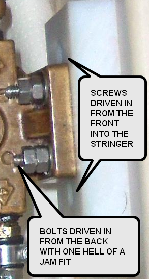

I don't remember if you mentioned what type of fuel filter you have but the reason my filter is located towards the rear of the boat is that originally it was located further forward over a big bundle of wiring and hoses.
My setup is surprisingly almost identical to yours. Matter of fact, the primary filter was mounted into the fiberglass and when I did this job I noticed only one of the screws was holding it in so I was going to use some JB weld on those screw holes and redrill. I like what you have, that piece of poly that it is mounted to. I think I'll try and find something like that. I'll do the same for my raw water filter.
23,951
Manic... Yes it is a pertty picture. All that clean white poly mounting base. There has been a bit of a challenge for many a DIY boat builder. How do you secure poly to fiberglass or, for that matter, anything? Stuff does not want to stick to Starboard, easily.
Fasteners work but the common adhesives, not so much. I came across this article a few years ago. It may help.
I have seen G10, Cousa board, and fiberglass boards used on many boats as mounting boards. They can all be attached to the fiberglass hull using thickened epoxy.
