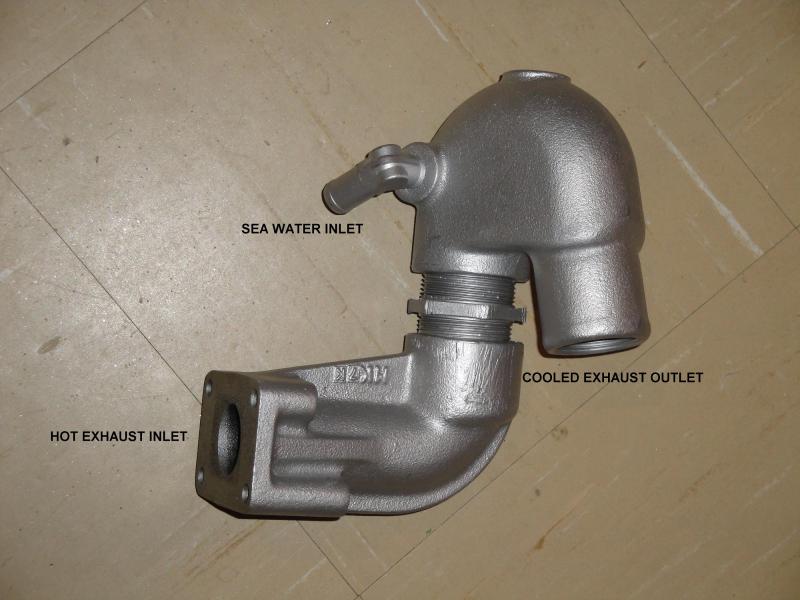

Agree Ken, I'd be better off picking up the skills--and necessity has forced me to start. Given the scarcity of diesel mechanics in my area, I can't get one out for > a month, so I started going through the list of suggestions in this thread and I think I've narrowed it down to the mixing elbow (MA: engine isn't louder or making any unusual noises). There are a lot of soot-like particles below and on the side of the engine that houses the mixing elbow, which itself has a lot of the same material on the outside of the elbow, especially where it connects to the exhaust hose, though the hose is tightly attached. I suspect the mixing elbow hasn't been replaced or cleaned in the last 10 yrs, if ever.
Not sure whether I can pull off removal and possible replacement myself....was a bit discouraged by this article, written by someone with far more mechanical skill & experience than I: https://www.sailmagazine.com/diy/maintaining-your-diesel-exhaust

I am not a mechanic. I replaced my mix elbow and exhaust manifold gasket myself. It is straightforward when you look at it. The hardest part for me was getting the hose loose as it was baked in. I loosened the hose top as much as I could with a screwdriver, then soaked it with wd40 overnight. Came right off next day. After that it's all bolts to deal with. Quite simple, yes?
Oct 24, 2010
2,405
Hunter 30 Everett, WA
Just one helpful hint here. The threaded part between the elbow and the manifold (between the two cast iron pieces) has one right hand and one left hand thread. This allows the parts to separate without unbolting it from the engine.
Not knowing that, I broke a manifold trying to separate the pieces when ours was clogged.
Ken
Dec 14, 2003
1,450
There are 4 only 12mm bolts holding the L-shaped piece to the exhaust manifold. 2 short and 2 long ones. The easiest way to remove the ex-elbow is to disconnect the hose at the horizontal muffler, then remove the 4 bolts and pull everything off. The hose from the elbow to the muffler is shorter than 3' and since the muffler is plastic the hose will not be baked on there. When you have everything out, it will become easier to take the hose off from the elbow. Do not forget to remove water inlet hose and bring it up higher than water line level. Better yet, also turn off your engine water intake through-hull to avoid any incident. You will need to scrape the manifold to clean bits and pieces of gasket then replace the gasket when re-installing the attachment. I found it easier to re-assemble the attachment and the elbow before re-installing the new unit to the manifold. The nipple in between elbow and manifold attachment is left hand / right hand thread. Chances are you need to take it to a shop to have it taken apart unless you can heat it almost red hot. Best price for a stainless steel elbow and nipple is a company out your way. Forgot their name but you can check E-bay. I've ordered from them and they also were able to supply the gasket. The whole thing was way cheaper than OEM. I've had it for 3 years now and everything is perfect. Good luck.
