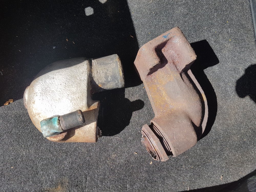

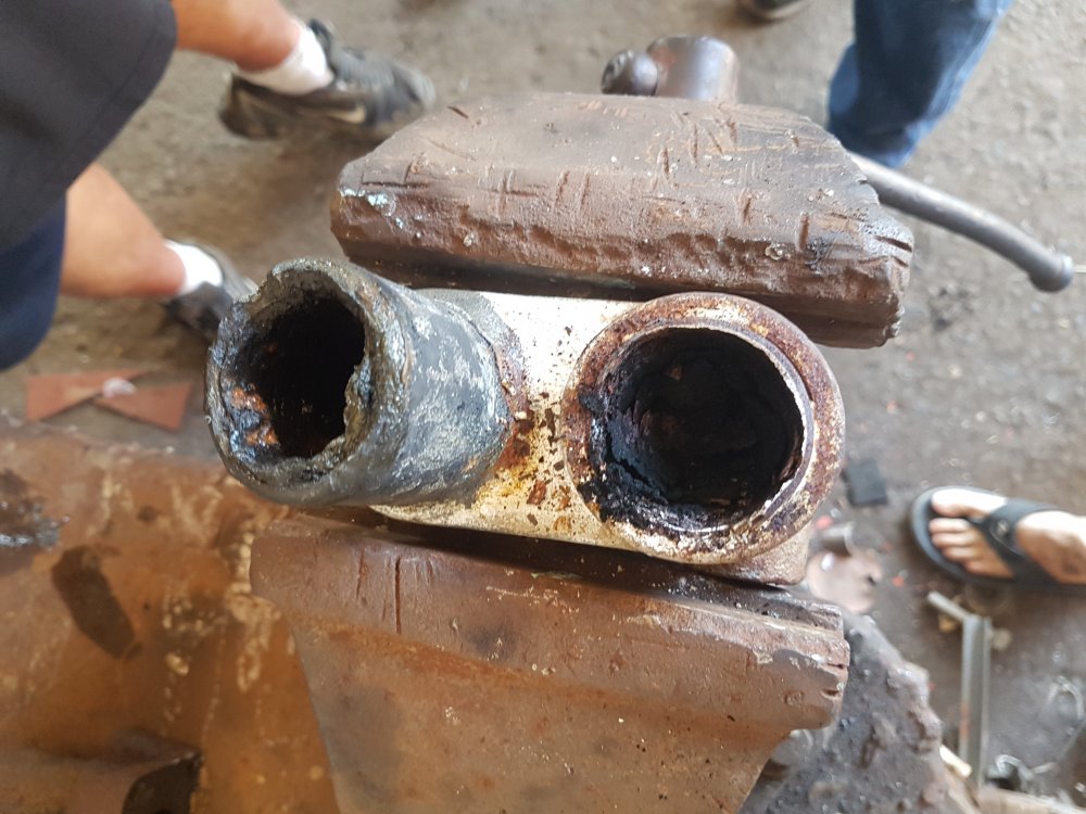

So the verdict is in and it seems with overwhelming proof that the culprit is the mixing elbow. It is completely stuffed, no water was able to run thru it.
The pictures tell the story…….the unit broke in two when we tried turning the elbow in a vice grip.

I purchased all my parts locally in Rhode Island (smmarine.com) and needed the same parts as your pictures show. $401.00.
Try toadmarine.com they have the parts, not in stainless as HDImarine. When I contacted HDI they were our of stock for my model engine (3GM30F), so I opted for the original replacement parts.
At least you could separate your elbow. I'm still trying to do that with mine so I can get inside pictures.
I'm sure it will solve your situation.
