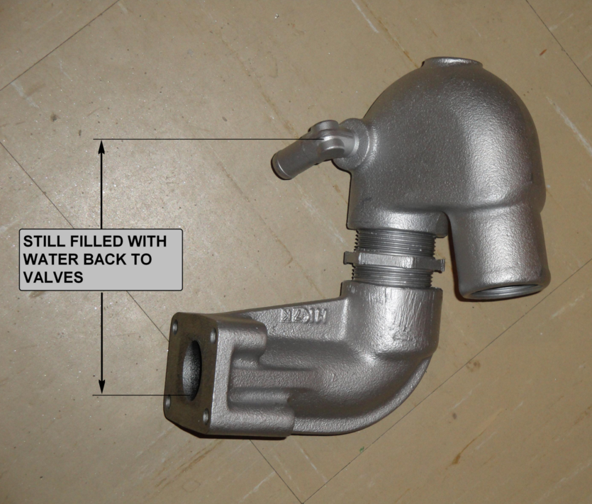

Sacrilege aside, the exhaust riser would still be full of raw water after the exhaust hose was pulled off.
BUT, if you pulled the hose off first just to drain it (keep your sox dry) and THEN slid the cast iron riser back a bit, that would completely drain the volume outside of the exhaust valves.
I would then feel much safer in pulling injectors, opening compression levers, etc, etc, or whatever would be next in line after ensuring all the water has been removed from outside the exhaust valves.
