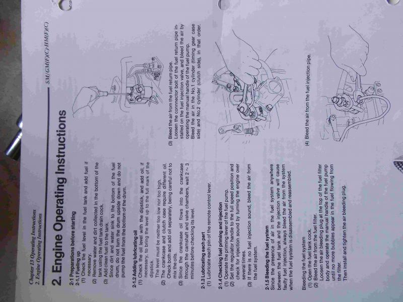

Not a detailed answer, but here is a link to Yanmar's Operations Manual pdf page for the GM series engines. Just in case you don't have it already. Page 19 has information on bleeding the lines right up to the injectors. Also lots of good practical how to and need to know stuff in the manual.
Also I have attached a photo of the bleed page from my GM Series Service Manual. Better pictures I think and also an extra step. I don't have this engine (a 2QM20 instead), but the PO thought the boat had a 2GM20. Hence my possession of the manual.
http://www.yanmarmarine.com/theme/y...ines/Operation-manuals/GM-OP Manual-Multi.pdf

Rardi, thank you for attaching the same page i was trying to attach to this
as i got on line.
I kind of look at bleeding the fuel line like bleeding the old house staem/water heat radiators. Start at the bottom of the sysem and work your way to the top till the air leaves the system. In a fuel line is is usally nothing more then a few bubbles per
joint you are working on. Once you start you will see it is not to difficult.
