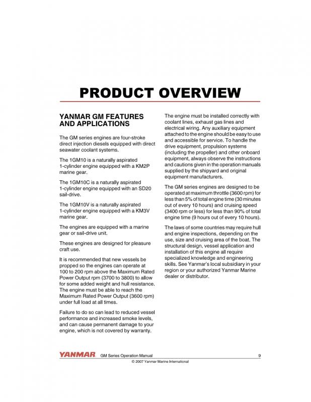

The only problem I see in this description is running the engine at 2,000 RPM.
The recommended RPM should be 75% of maximum speed = 75% of 3,600 = 2,700RPM.
Having said that, Yanmar recommends much higher operating speeds as shown:
Good for the engine but not so good for fuel economy.

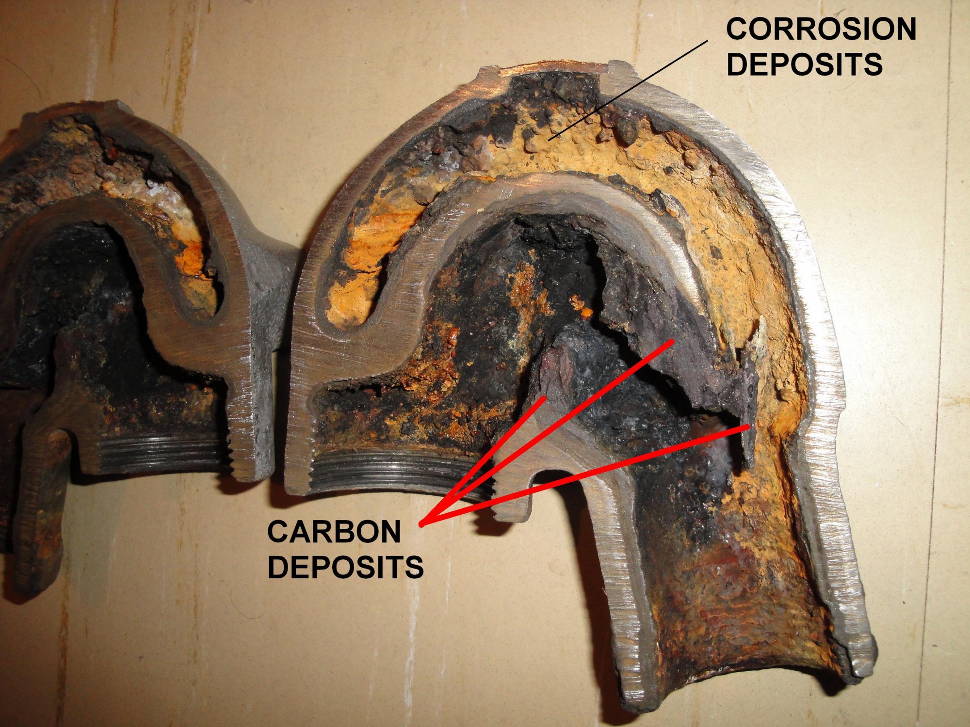

Running the engine for long periods at reduced load can result in a clogged mixing elbow:
This may be one place to look if your engine has a mixing elbow.

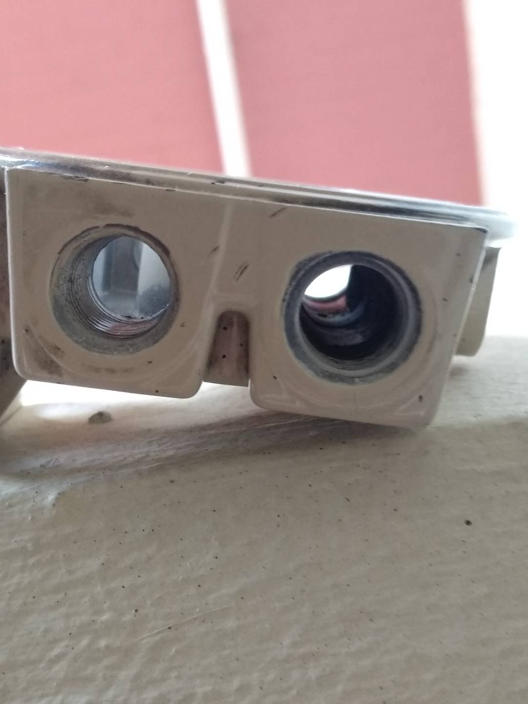

Sounds like foul take-up tube, foul in water-separator head assembly.
Had similar issue before.

I clean out the racor head assembly and use dinghy foot pump to blow back chokage to tank. Yes dirt stays in tank which i then polish the fuel.

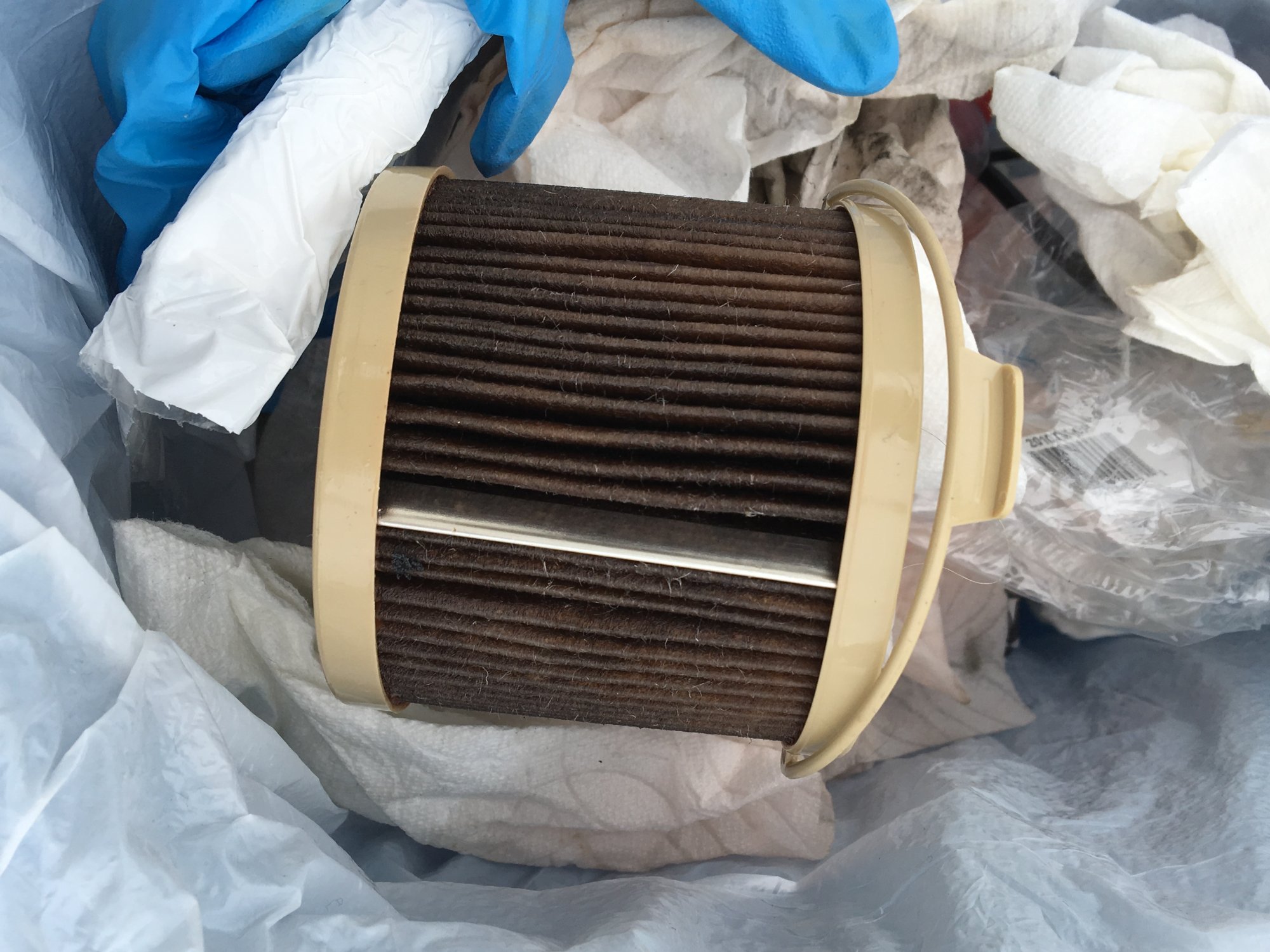

I had the dirt in the filter issue. Here is what a clogged filter looks like.
The vacuum gauge is a great tool to let you know when the problem is happening. If the filter is clogged the vacuum gauge rises showing fuel starvation. It there is a leak then you the gauge shows low vacuum. Air is leaking into the system and fuel cannot get to the engine.
