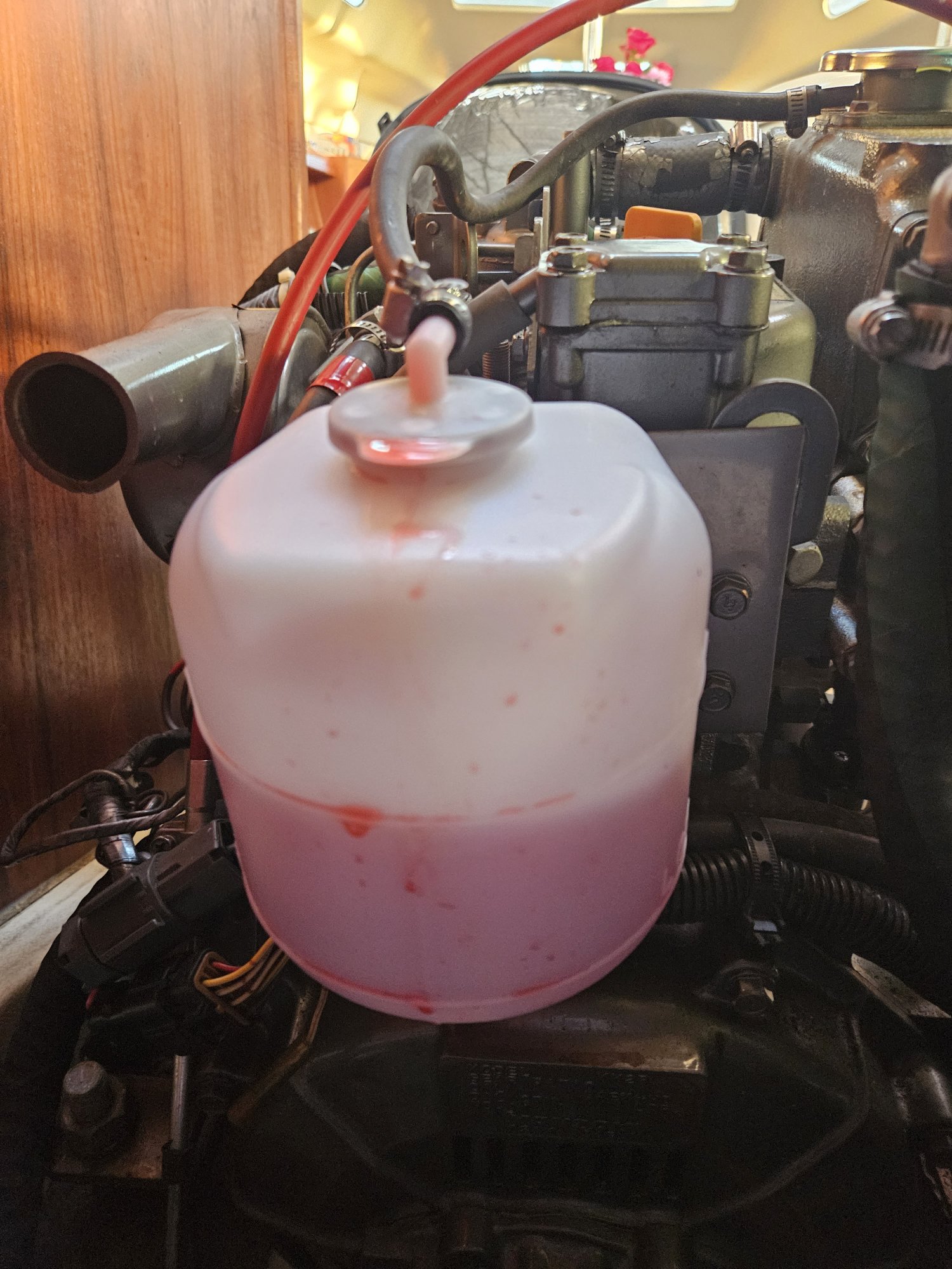

I've been chasing a coolant drip associated with the expansion tank. After each cruise, there is coolant in the engine basin, not a lot, perhaps a couple tablespoons. I've replace the radiator cap, replace the Expansion tank and still having the same issue. The engine does not over heat, no alarms, no steam and run great.
The expansion tank is filled to the low mark when cold and has never over flowed that I can detect. There is a tiny hole in the expansion tank cap where the coolant seems to leak from.
Anyone experienced this issue?

I'm amazed that you're the only person I've ever seen to raise this question because anyone with a Yanmar one or two cylinder engine will undoubtedly have the same problem.

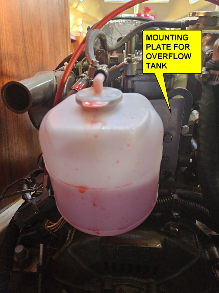

If you take a look at how the little tank is mounted :
................ you'll see that it's subject to any and all vibrations coming from the engine.
The next time you return to your marina and after tying up, leave your engine on idle (800 RPM) and remove the cover over your engine. You will then see that the overflow tank will be sloshing around like a washing machine on steroids and every so often a drop of coolant will escape from under the lid. This is what's happening when you are entering your marina at minimum speed. Unfortunately, the lid does not screw on so a gasket under the lid is of no use.

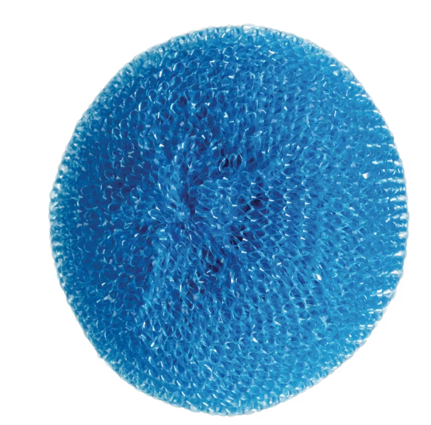

The way I eliminated the problem was to stuff a large wad of plastic scouring pad into the overflow tank and this stopped the sloshing against the underside of the lid.
No more coolant under the engine.
Ensure that the pad is made form coarse strands that will not break while in use. Test before inserting it in the tank.

Ralph, thanks so much, it makes perfect sense. I do know how much the engine shakes, but your point never occurred to me. I'll definitely give it a try.

Another possible solution would be to mount the expansion tank to the bulkhead in the engine compartment, which doesn't "shake".
:plus: That's what I did when I added an expansion tank a few years back.

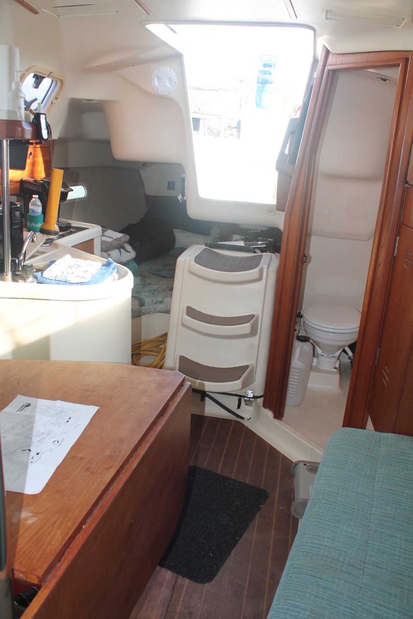

Thank you for the suggestion to mount the tank in another location off the engine. Unfortunately, the engine cover fits tightly over the entire engine with no option to mount the expansion tank..

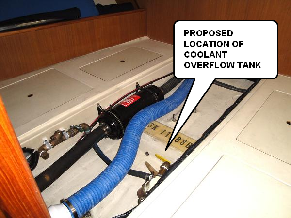

I've even looked at leading the hose back and down down to the aft aft where I do have the room to install the overflow tank.
The big problem with that location is that it's a little over 24" below the level of the radiator cap and I'm not keen on lifting the overflown coolant that far after the cooling system is shut down and starts to cool.

I wonder if the tank will work right if mounted 24” below the HX neck? I imagine the overflow will be fine, but will it be able to suck it back up to the HX as it cools? Seems like a long way.
My thoughts exactly when I first looked at this some 20 years ago. I'd rather not lift it that far. Mounted on the engine, it's almost level with the radiator cap.

Well my mystery has been solved. As pointed out earlier, the expansion tank is mounted on the engine, and with the doghouse covering there is no other place for it to be located. I replaced the engine mounts and the vibration has calmed down substantially, resulting in no more leakage from the expansion tank. And the engine vibration on the boat is so much better.
Thanks again to Ralph Johnson who originally pointed me in the right direction.
