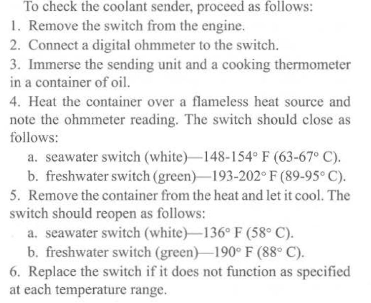

I agree with confirming the engine temperature using a digital laser thermometer. You can get one really cheap from Harbor Freight.
As for the temperature sensor, that is simply a temperature sensitive switch that provides a pathway to ground and completes the circuit that sets off your buzzer. Check the wiring to make sure that the wire going to the switch is not somehow coming in contact with ground in some other way.
Next, checking the switch itself is simple. Remove it from the engine and heat up a pan of water at or above the temperature at which the sensor should close. I believe your engine is raw water cooled, just as my 1GM is. If so, the temperature switch closes between 148-154 deg. F. If your engine is fresh water cooled then the closed temperature is 193-202F. Attach an ohm meter to both the probe part of the switch and to the place where you removed the wire when you took it off the engine. You can tell from the ohm meter whether the switch is open or closed. Actually, you should be able to hear an audible "click" when the switch closes even without the meter. But check it with the meter regardless. Then, remove it from the hot water. As the switch cools the switch should open back up. Really not much to it.
