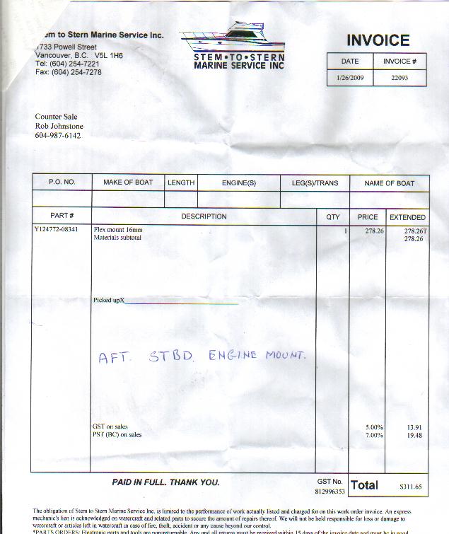

Upon inspection, I found the forward port motor mount bolt sheared off. The nut holding the aft port mount in place is missing. The starboard side must be equally screwed up.:eek:
I'm afraid the unraveling sweater has just disappeared into a last thread.
If the one mount has disintegrated, chances are the rest of them are not far behind. It may be time for a full replacement.
A little sticker shock on the price of these thing, and that was five years ago :eek:.
