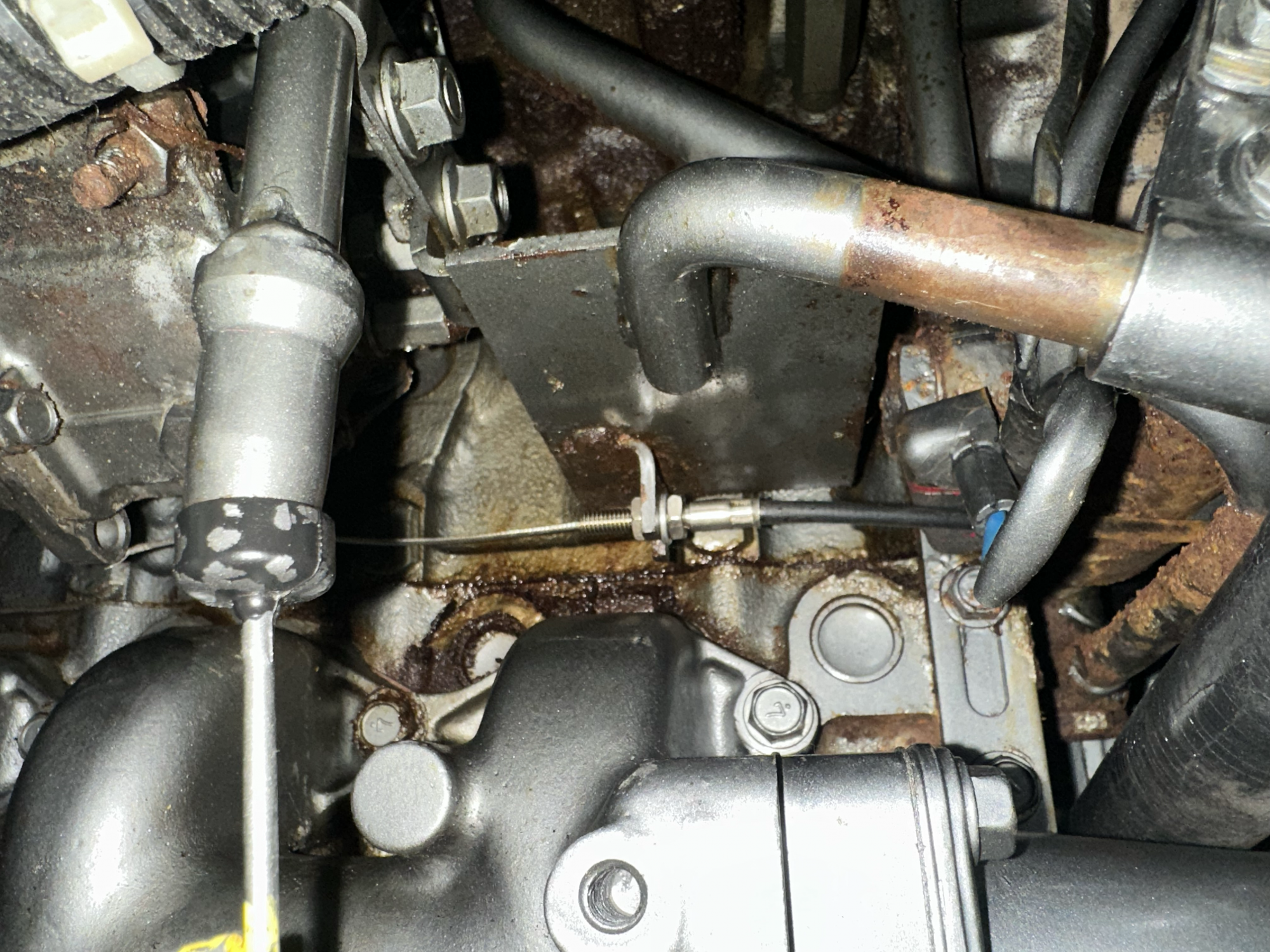

The kill switch does not work. If it is pulled and attached to fuel kill lever it does not pull. If it is pulled and attached to nothing it slides as expected. If it is pulled and I hold the end with it unattached to anything else it doesnt pull. I have attached a pic of the control.cable in the engine compartment. The yellow line parallels the kill switch cable. Is it too long?

I can move the lever by hand and it kills the engine as expected.
What do you mean by correct location? The kill lever end is attached to bracket on the engine and the other to the knob on the control panel.

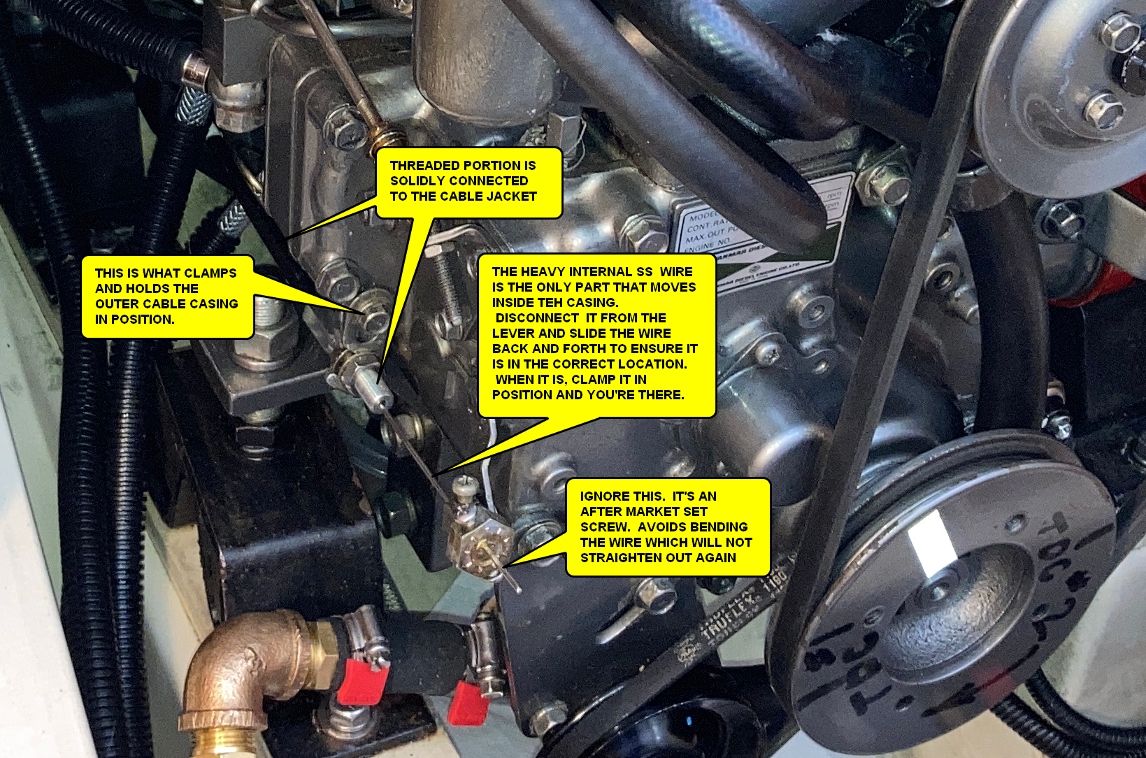

13,473
For any control cable to work, the outer jacket needs to be secure and not move. If only one end of the jacket is secure it won't work. There should be a small bracket near the lever on the engine the out jacket connects to, it will have lock nuts to adjust the the position. See the image below, it is from a Yammer 3jh2e and should be pretty standard. The lever is off to the left hidden.
Yes. The end of the control cable sheath is attached firmly. It doesnt move at all in any of the cases above. Its as if the inside cable has just enough force to move only of there is nothing for it to pull.
