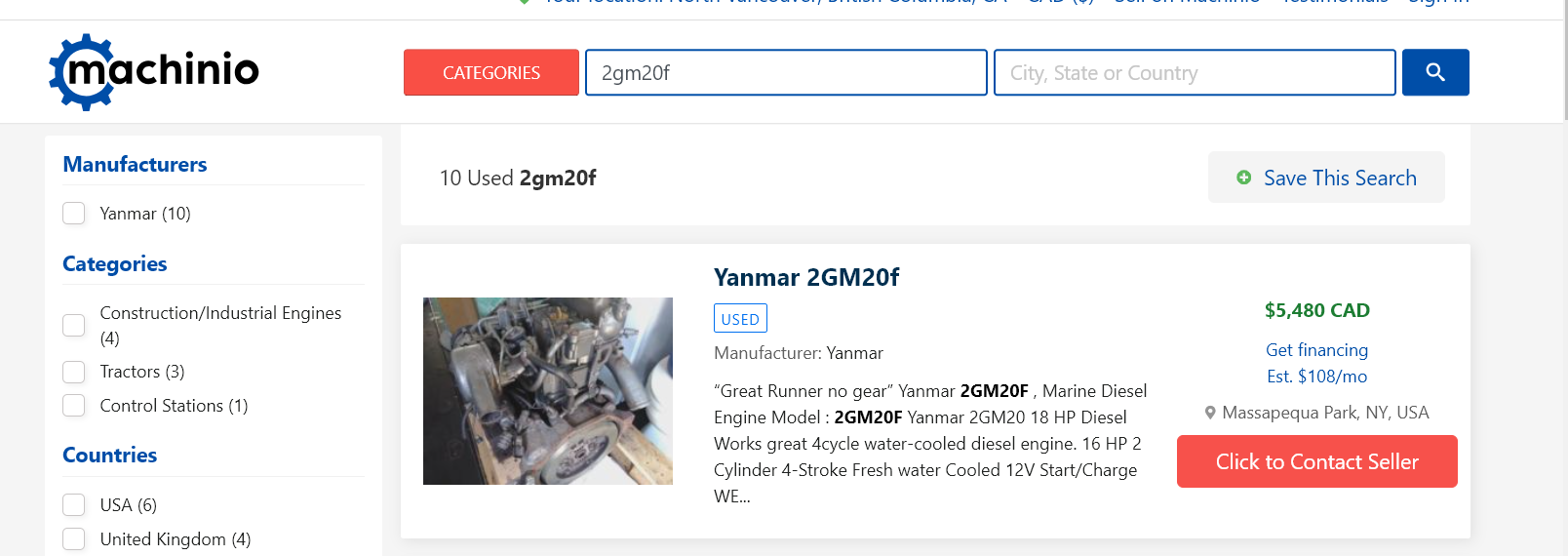

Where should I look first?
Here's a good place to start :
It's quite likely you're engine has seen some major damage after a stunt like that.
Did it ever occur to you "There may be a problem with the oil level" or do you not know how to check your oil level ?
Best of luck with this. You're going to need it.

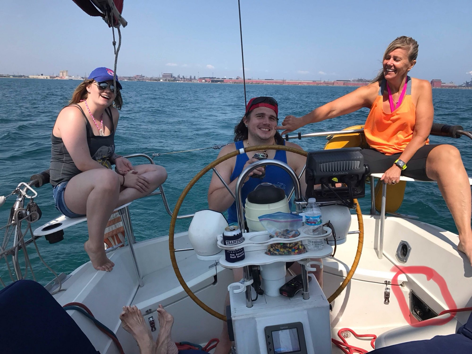

Are you sure it was oil pressure and not overheating light?
The day I took my O’Day 322 with the same engine, and started to motor across Lake Michigan in a big headwind and chop, my idiot alarm went off. The engine control panel is mounted very low in the cockpit and seeing the row of idiot lights is almost impossible.
In my case, I reduced throttle and made contingency plans if the engine seized (I could not tell what light was one). While we were discussing plans, the alarm stopped. We nursed it to the next marina and inspected the engine. Turned out the fluid in the heat exchanger was very low, and pushing the engine hard through the chop caused it to over heat.
Just asking to verify that you know for sure that it was the oil pressure alarm.

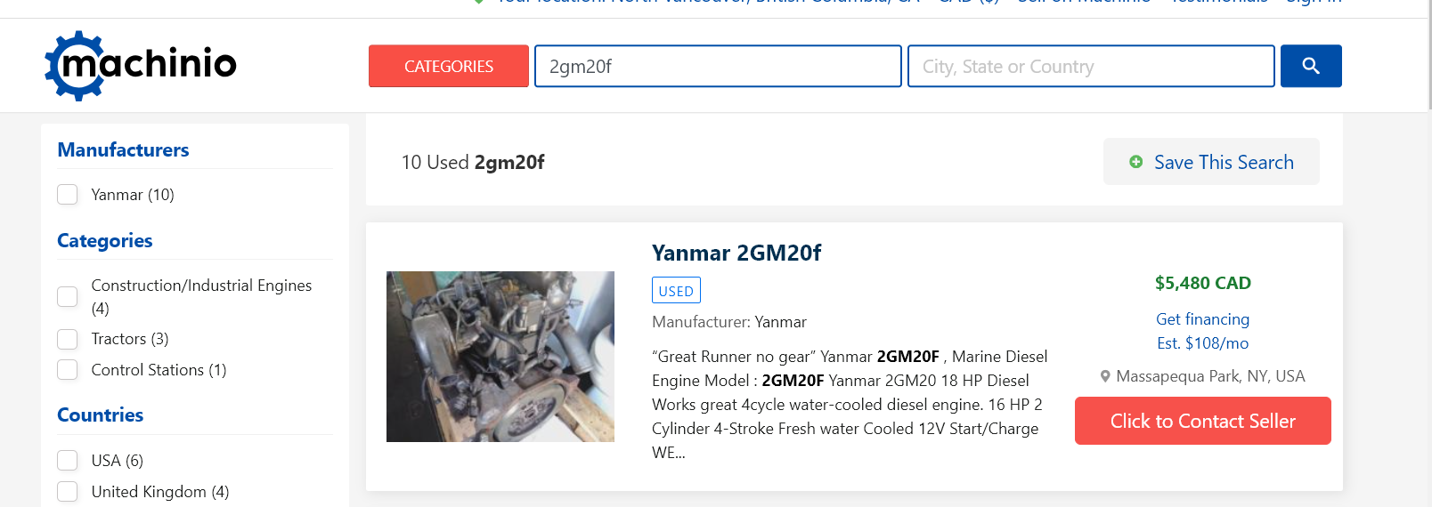

Checked oil level a week before and it was fine.

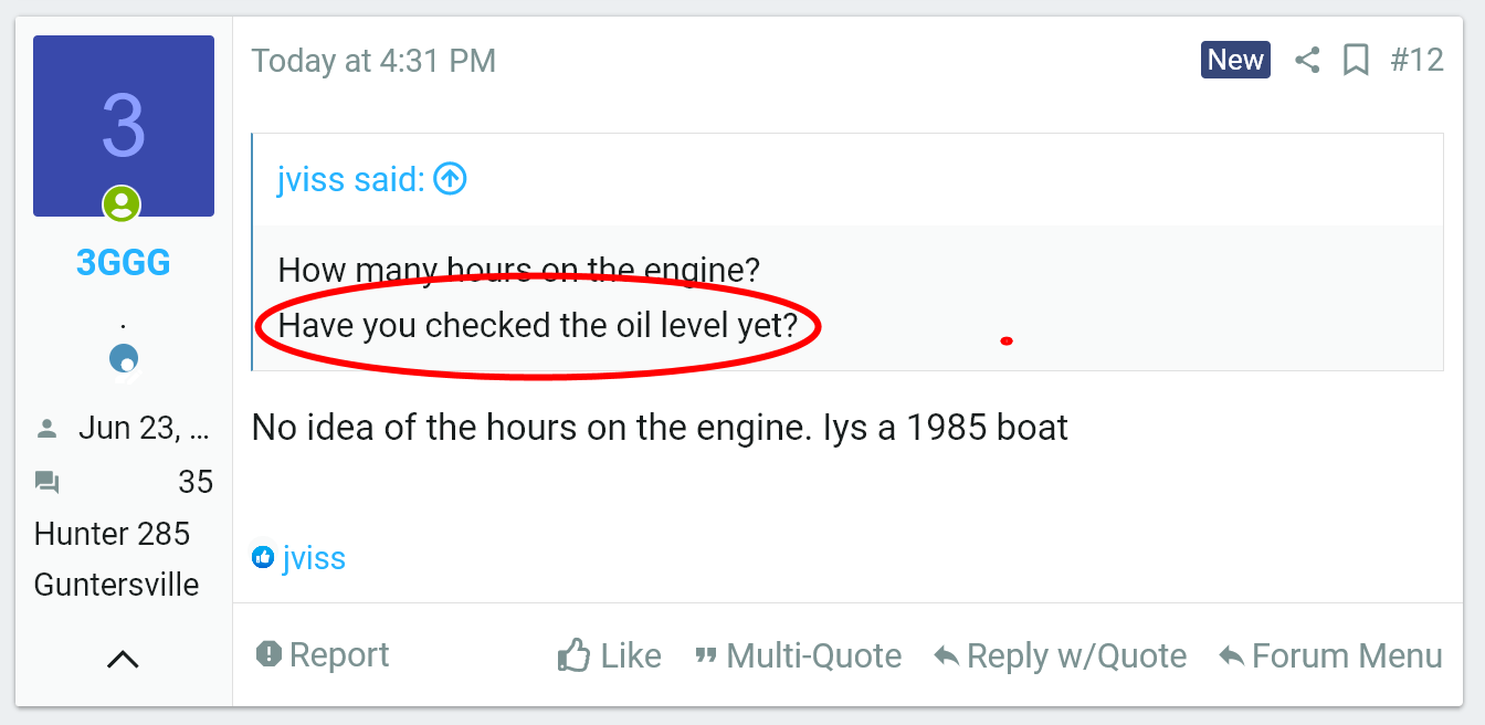

You have been asked repeatedly for the oil level after the alarm incident and no reply.
Is this on a need to know only basis ?
