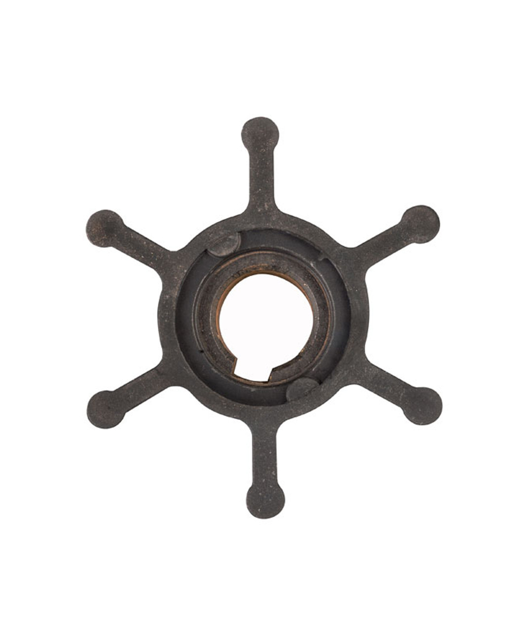

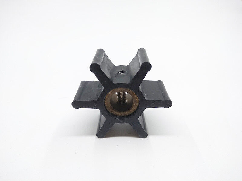

It's a Johnson pump that is made in a couple configurations, the original on mine had a cross rod that fit the end like first image and used Johnson 810 impellor. When I replaced with a Yanmar boxed replacement pump it came with a keyway for the impellor and uses Sierra 18-8950 impellor (second image). Which do you need?

Thats correct Ted, the second one comes with a paper gasket which wont work in the E serial # engines and is what is included in the 2gm20f kit which is not correct for the E ser # engines… quite confusing not inly for the novice sailkr bjt also some yanmar parts dealers….
