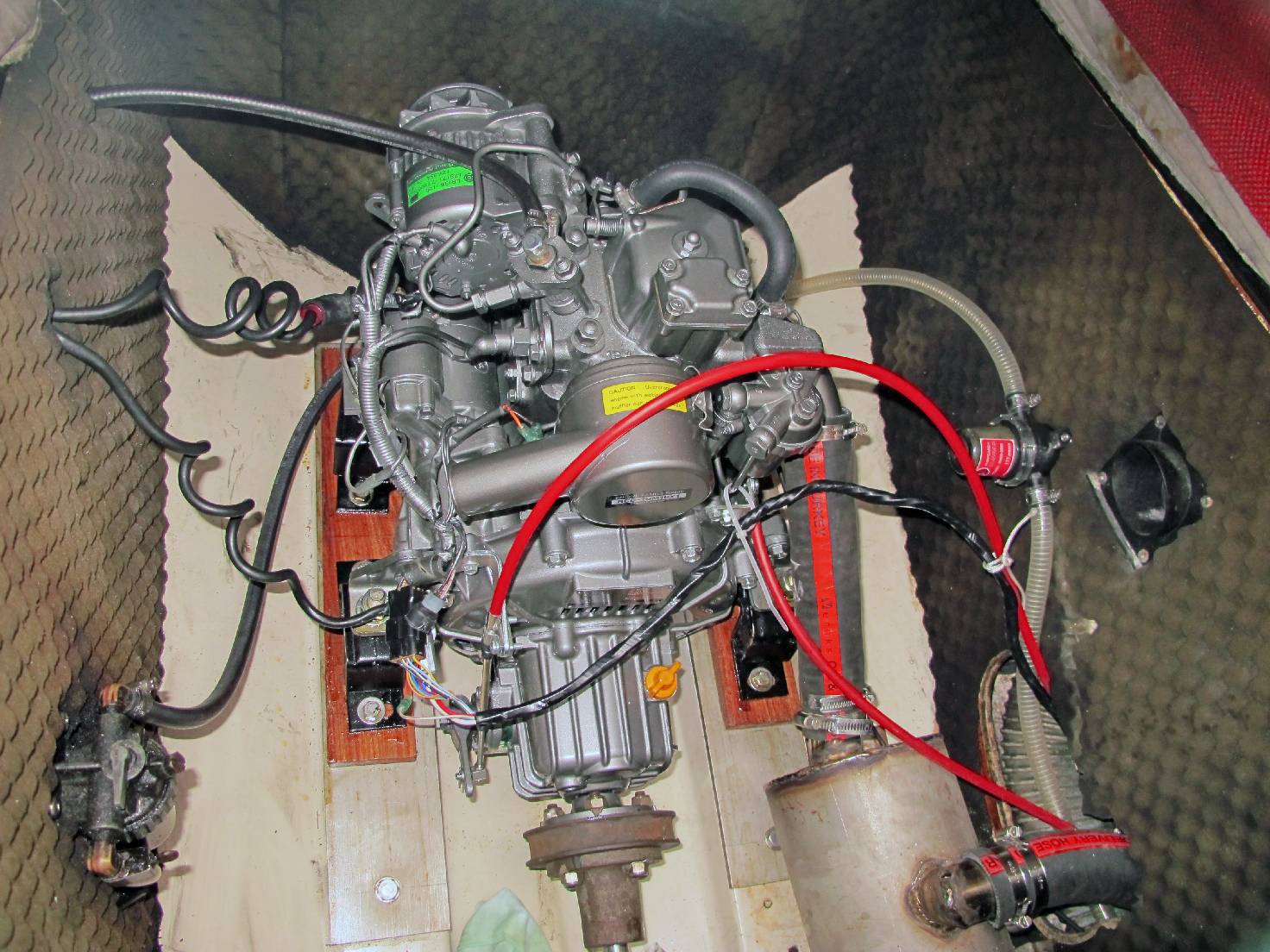

Hi ,I am back. To fit a 1GM10 into the Y-25 ,you need to modify the engine bedding in the bilge . The original are two beam shape protuded on both side the bilge. You need to fix two strips of steel plate in the original bedding so the new engine seat can rest on it with the fixing bolts in different position . Not much ,just a few inches from the original. I saw other 25 fit a Yanmar 2GM which is more power of course. And I hear that a France marine engine -- forgot the name with Na?????? or the Bata which can direct fit into the original engine mounting position without modification.......pl check. Hope to post some pictures later, they are in other pC.

Here comes the picture. Pl note that you need to replace the propeller, the 1GM10 is R turn. Or you may need to adj the length of the shaft because of the new position of the engine.
