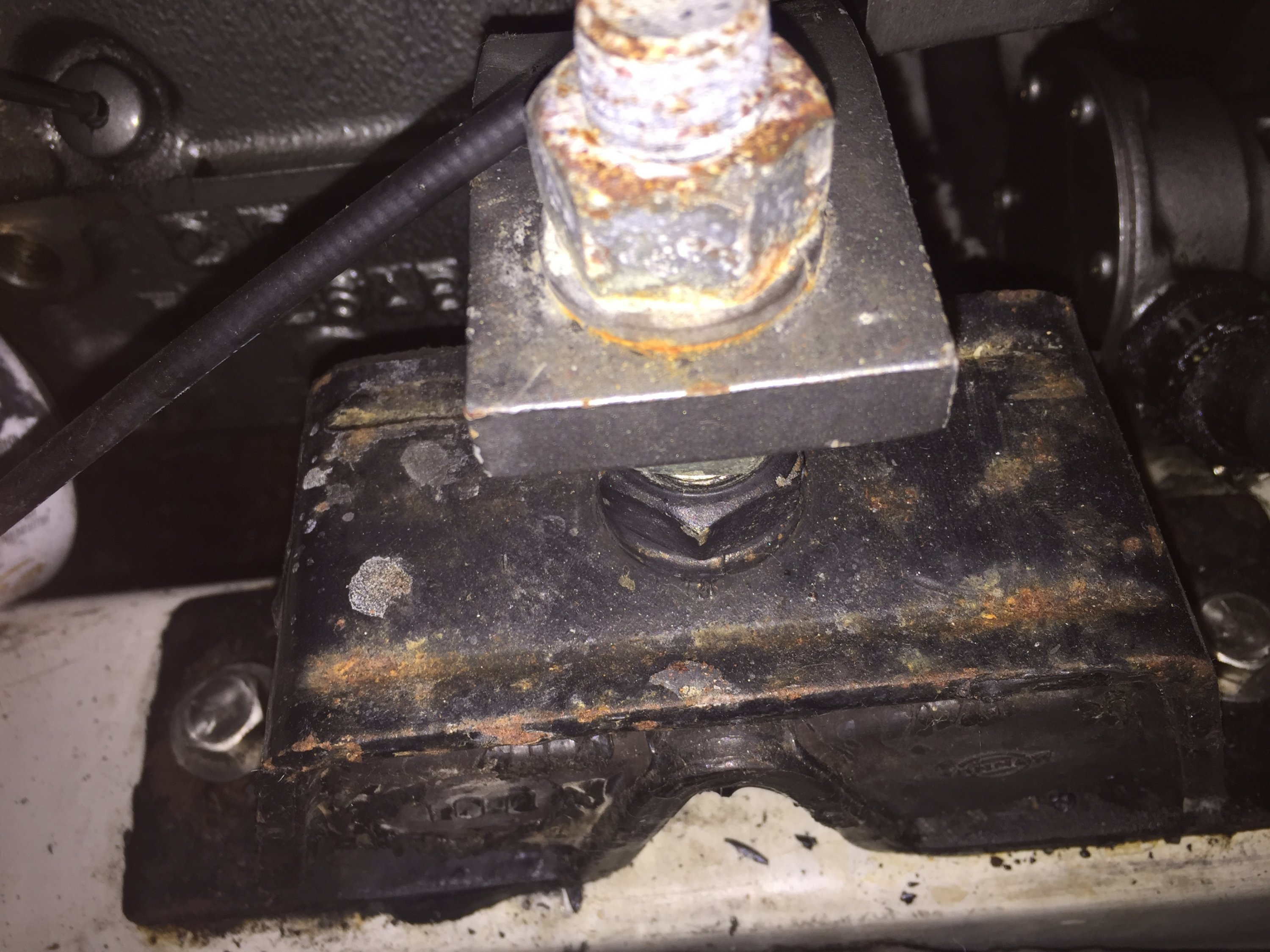

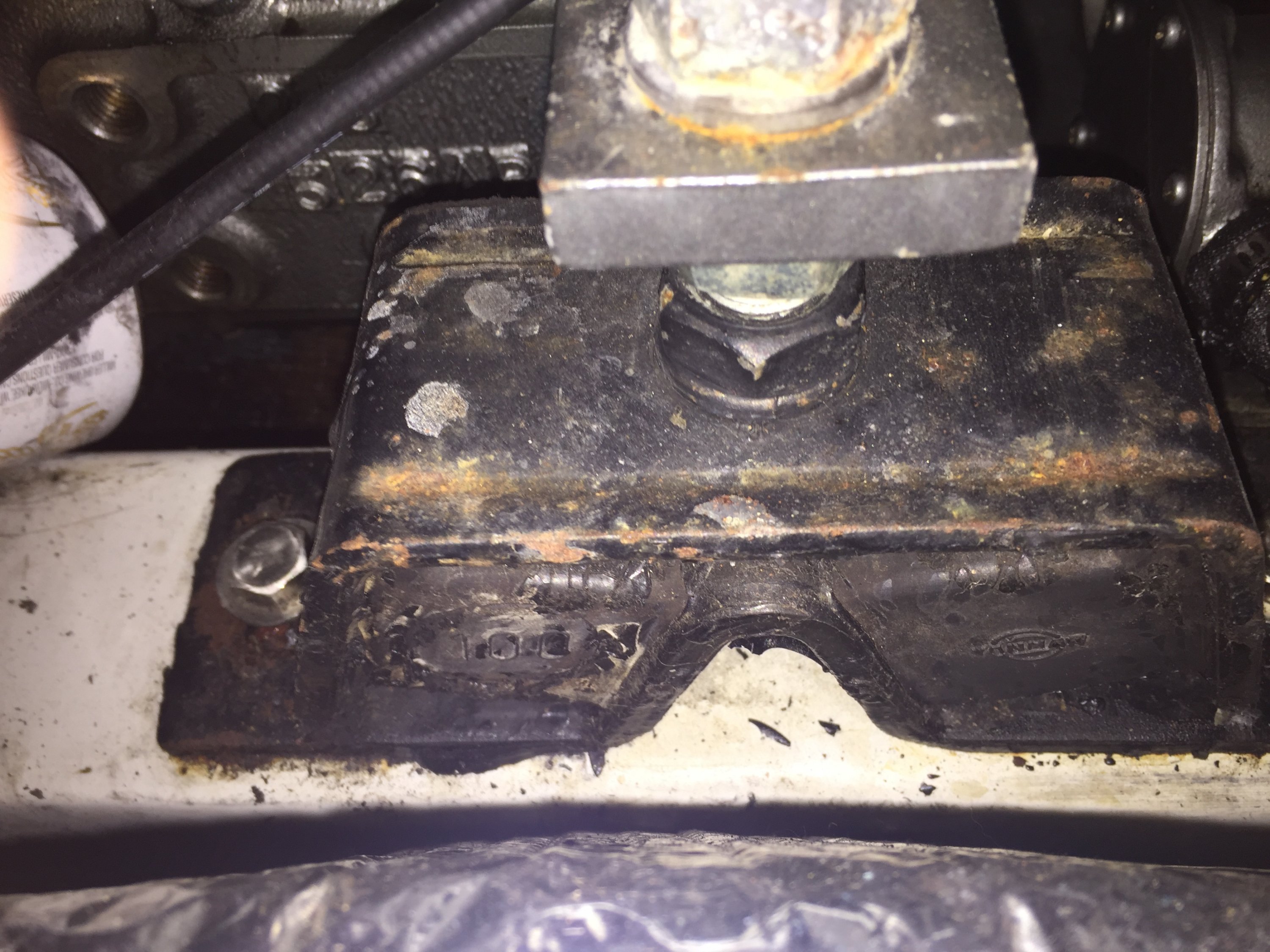

Does anyone know if the rubber parts of one of these Yanmar engine mounts can be purchased? or is a matter of replacing the mount completely? Does Yanmar still sell this type of mount?

The rubber is vulcanized to the steel (one assumes a person from Vulcan did the work.) When finished the metal and the rubber are all one piece.
Yes - they are certainly available from Yanmar. You need to know the motor you have because the rubber recipe for the rubber in these 4 mounts is different front to back or side to side. These are pretty high priced - but remember what they do. They transmit thrust to the whole boat and they last a good long time - longer yet if you keep oil and diesel fuel away from them.

You have to buy the entire mount. Cast into the rubber is a number which indicates what mount you have. In your photo I can see the #100. The front and rear mounts are usually different numbers. Check the other mounts to see what number they are to make sure you are getting the proper ones. Make sure that when you replace the mounts that the new ones go to the same location as the old mounts. It's easy to mix them up because they look pretty similar.

Thanks Charles,
I have no idea if either of the OO's replaced them. Any good indicators to tell if they are shot? I don't have a lot of engine movement but I have inspected it while moving from neutral to a load.
Thanks Ted. I did not realize they were different (front and back). I will do some more inspection to see exactly which ones I have.
If you take a look back at that previous post, the gap shown should be 3/8" which is what the new one read. The worst thing that can happen to them is to soak them with diesel fuel, which is why I replaced that particular one.
