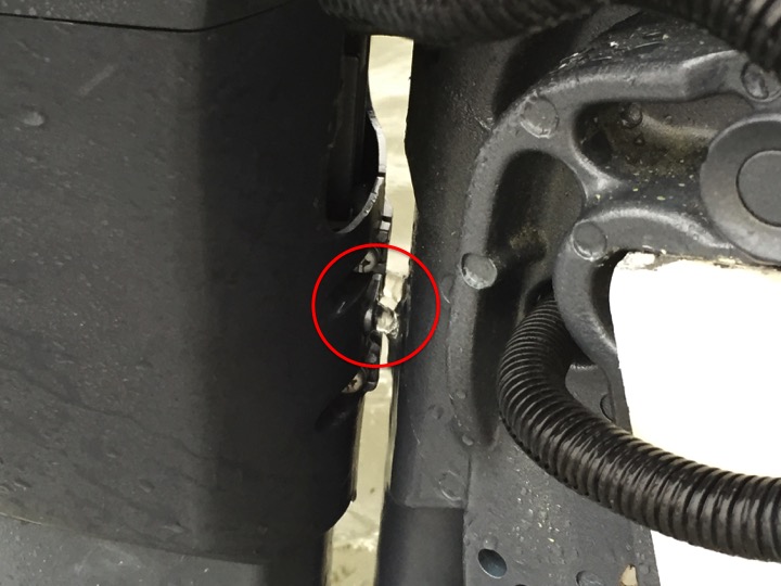

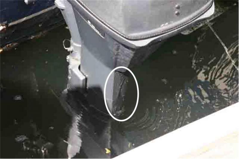

I went down today and took some pics. Since Brian and Max see the same thing on their new OBs and the marina mechanic thinks it is normal I am starting to relax.
I'll be calling the dealer and will report back tomorrow.

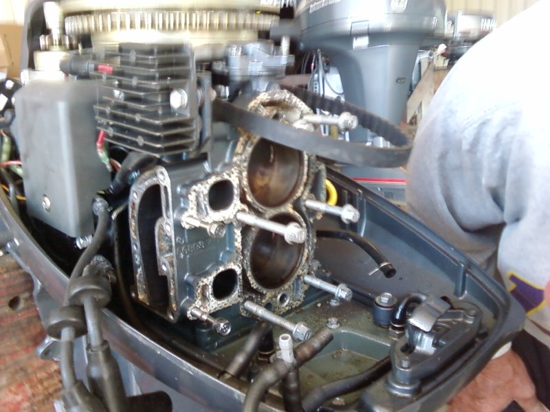

Interesting! I am intimately involved with an older model (see pic of clearing water jacket) and it does not have the water flow holes.. Makes sense..
