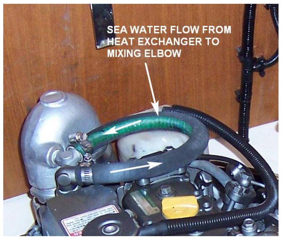

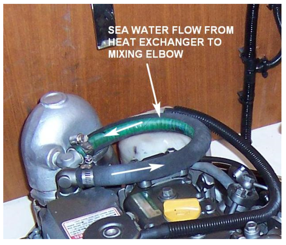

Are you sure you know whether you need a muffler or a mixing elbow?

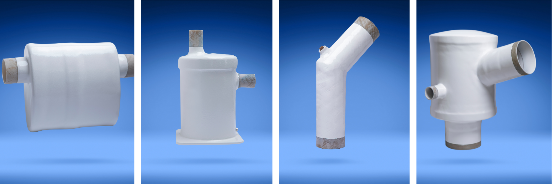

I can only speak for Hunter, Cat, Bene, and a few other production boats I see at the boat shows, but they usually have fiberglass mufflers. Does your muffler look like this :
Or like this, as suggested by @Johnb :

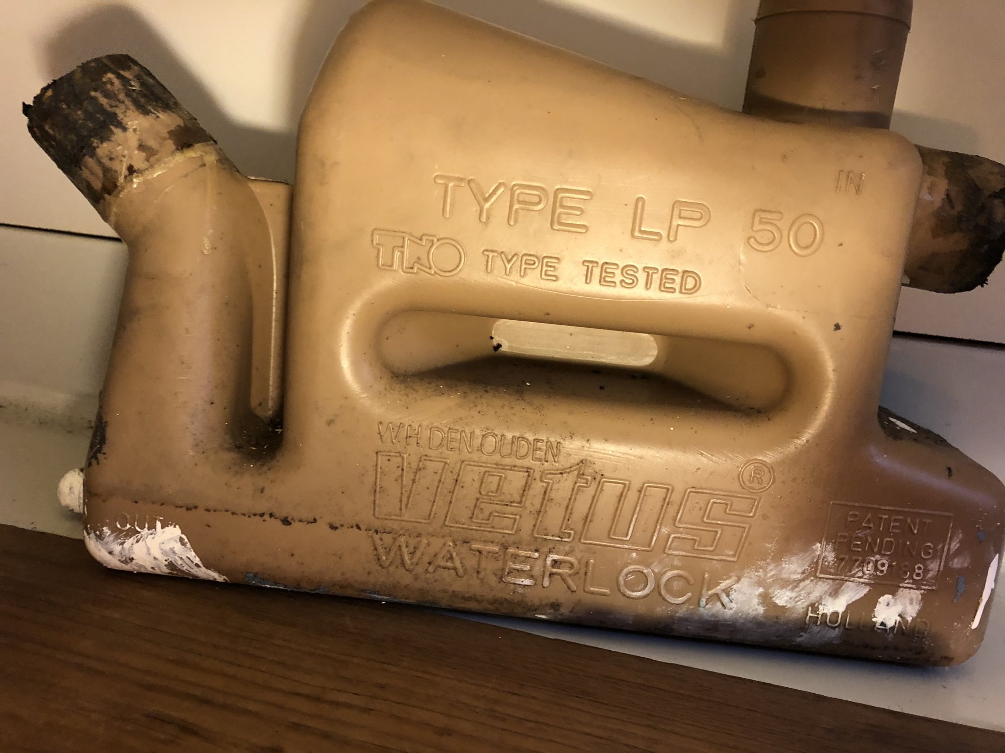

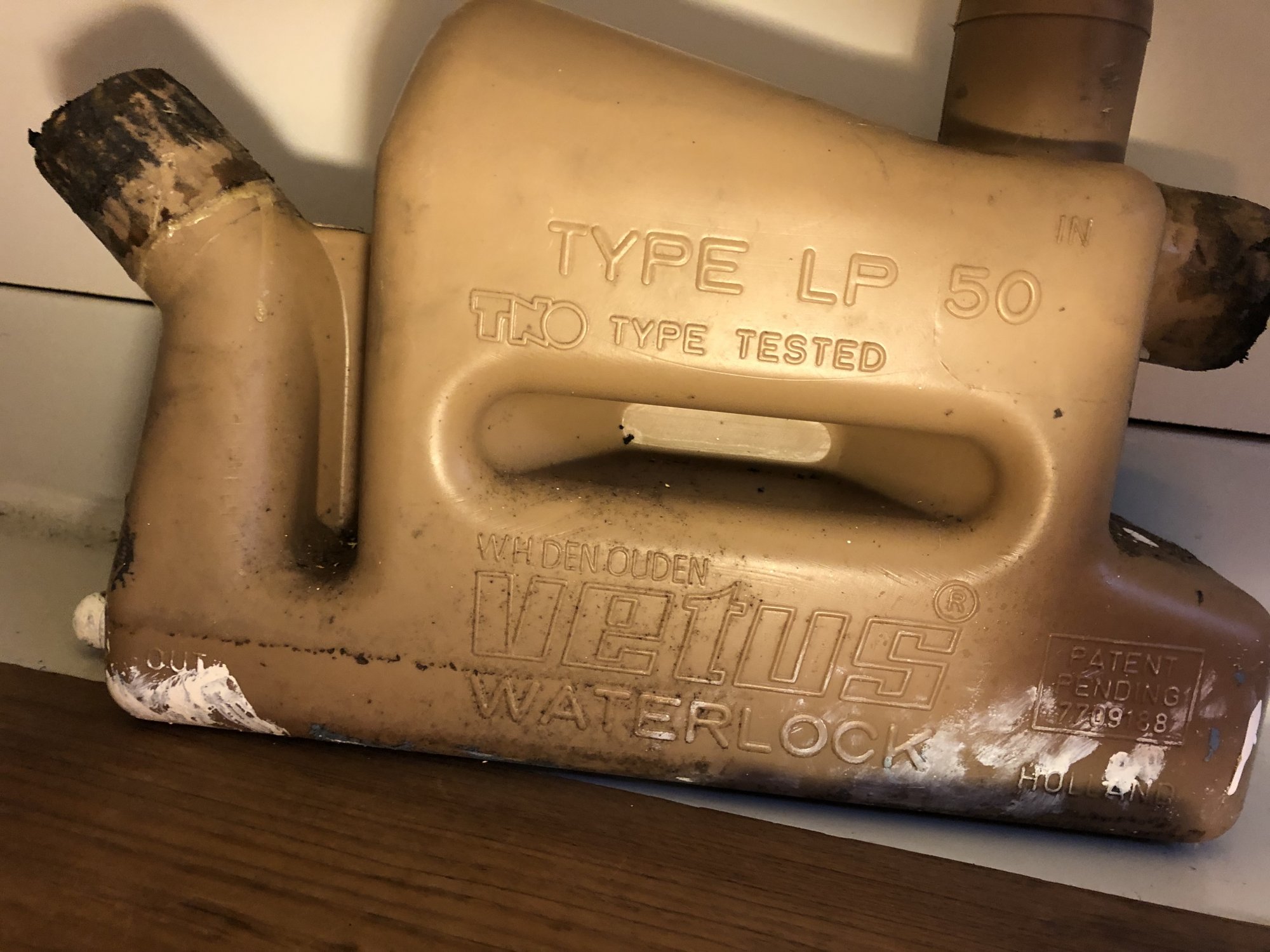

So, the engine is located in the V berth? That sounds like a strange place to mount an engine. Must require a very long shaft.
The water lift muffler in my O’Day 322 with a Yanmar 2GM20F engine is this old unit from Vetus. It feels like plastic.

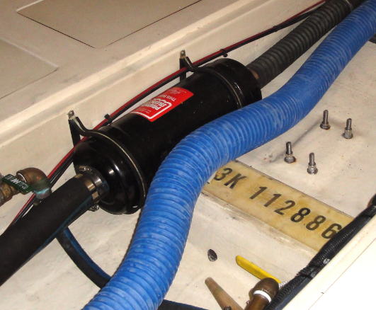

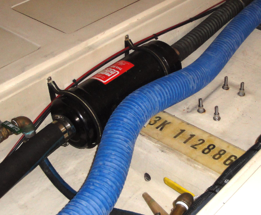

Mine looks quite a bit like that. Here's a couple of pics of the muffler. Engine is in the V-berth. It flows from the mixing elbow down into the upper entrance of the the muffler and exits at the low point of the muffler out to the exhaust hose. Sort of the opposite of what the fibreglass and plastic Vetus mufflers do. It's small - about 9" long and 7" in diameter. 316 stainless - guessing 1-2mm thickness.
Do you think that is the wet muffler or a marine resonator type of thing that is usually downstream of the wet muffler? Would be nice if that was a wet muffler. What brand is that?
Thanks for your note!
And it’s a Yanmar not a Yamaha
Yes - good question because you're right you normally have to replace those pesky rusting mixing elbows before anything else. Thanks for that question. The mixing elbow is quite new. I have a spare new one so I wish it was that. It is indeed the wet muffler that is need of replacement. Confusing... it's Yamaha 30 sailboat with a Yanmar YSM12 engine. Tongue twister for sure!
It's definitely a muffler. A resonator ? This is more likely found on high performance automotive engines for frequency alteration before entering the muffler. Do not have the brand name of the wet muffler in any of the docs around the house so I'll have to let you know when I get to the the boat in a few days.
From corrosion studies I have taken way back in the day, I don't think you could do worse than having a thin wall SS muffler (of any type SS) trying to handle a soup of elemental carbon, CO2 and salt water. I think the fact yours has developed a leak tells the tale. A FG muffler would have far greater success in standing up to that corrosive environment. By comparison, I have 2200 hrs. on my FG muffler shown in post #5 and it's still solid.

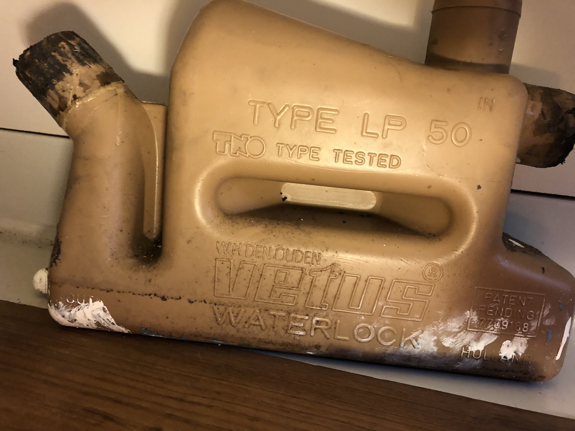

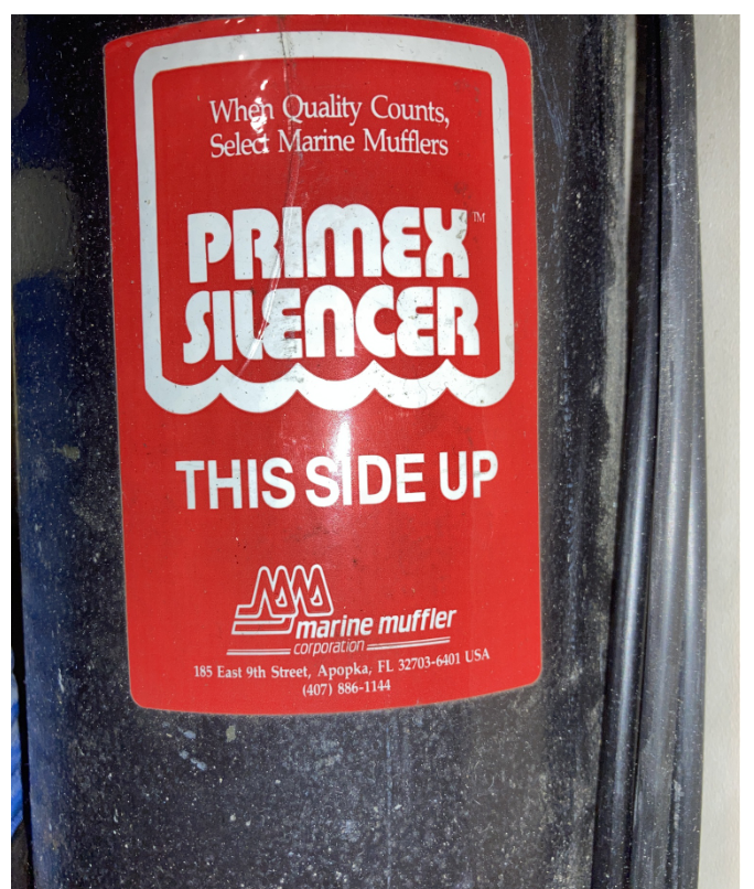

Finally cleared out the aft berth and got a photo of what Hunter used back in the day :
I'd try to find a FG muffler locally as shipping costs across the border are pretty much up there with the cost of the ordered item.
Don't fall for the SS muffler scam as it is either the result of the mfg. not knowing that SS is not suitable for a wet muffler or just a cheap product.
