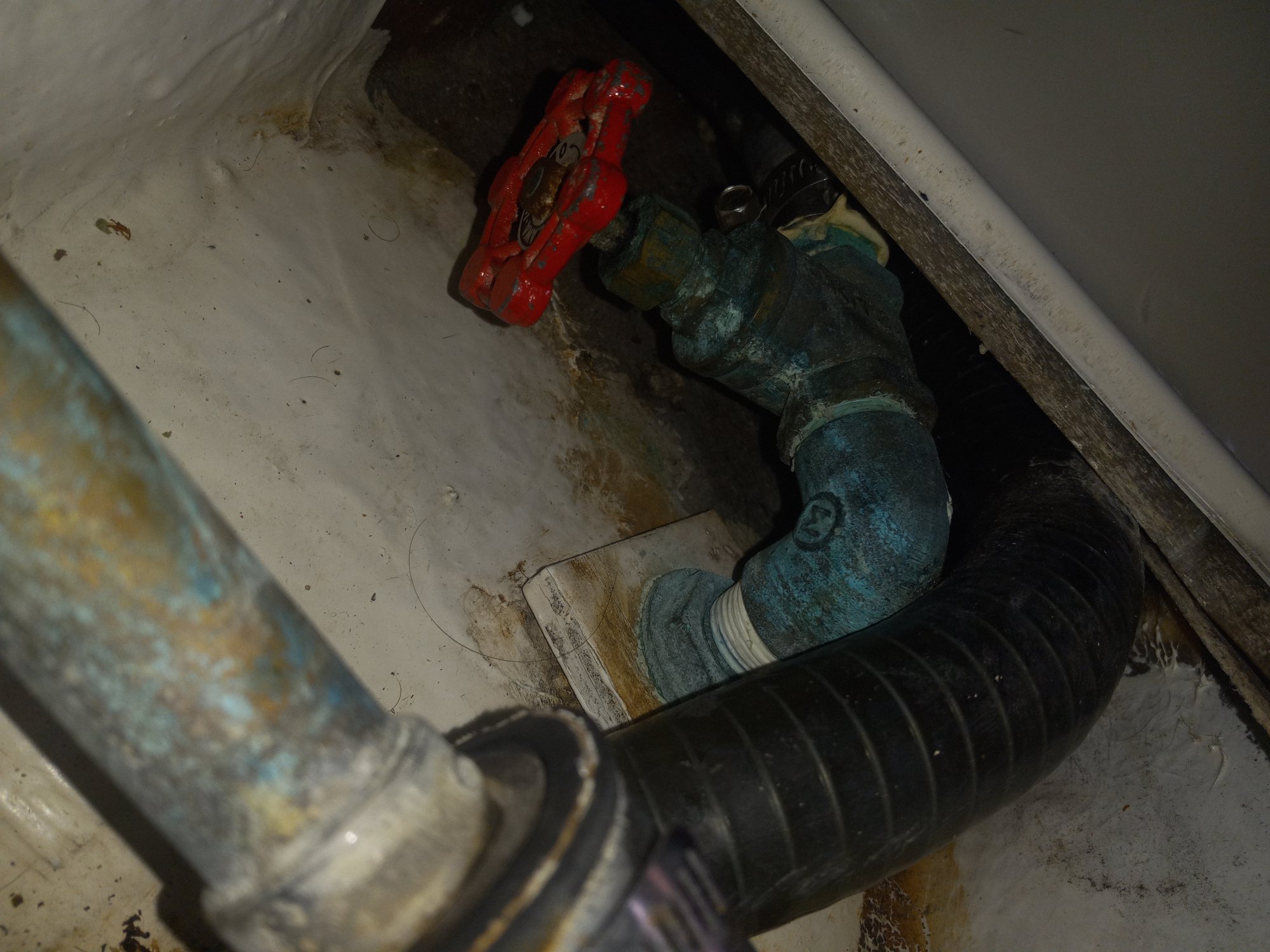

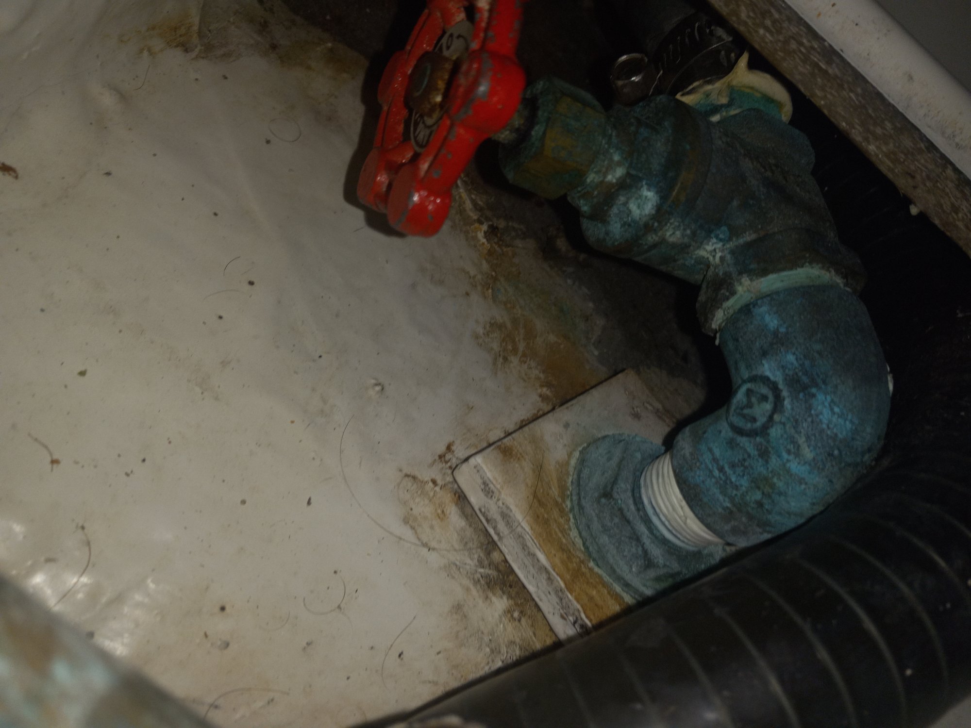

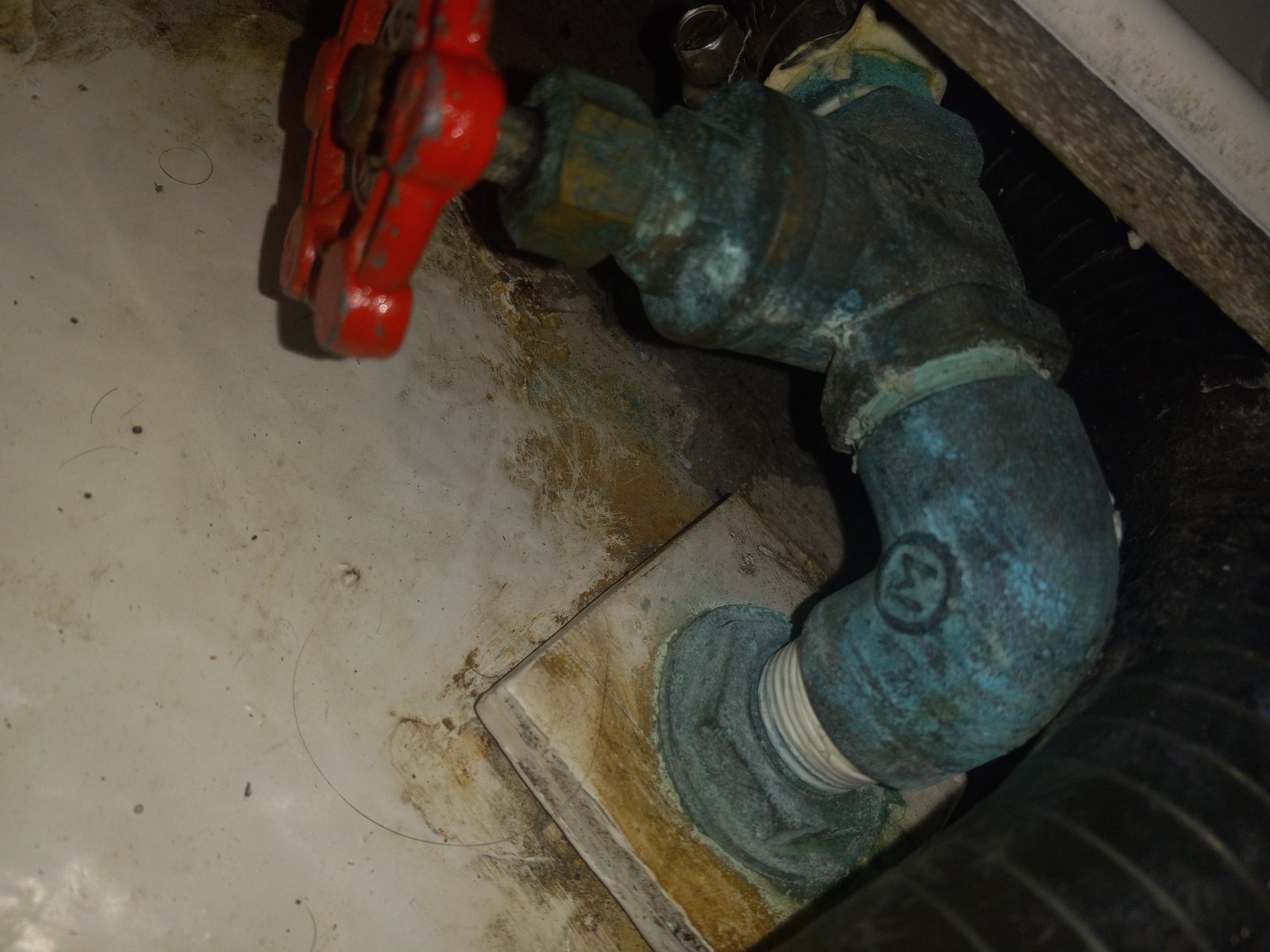

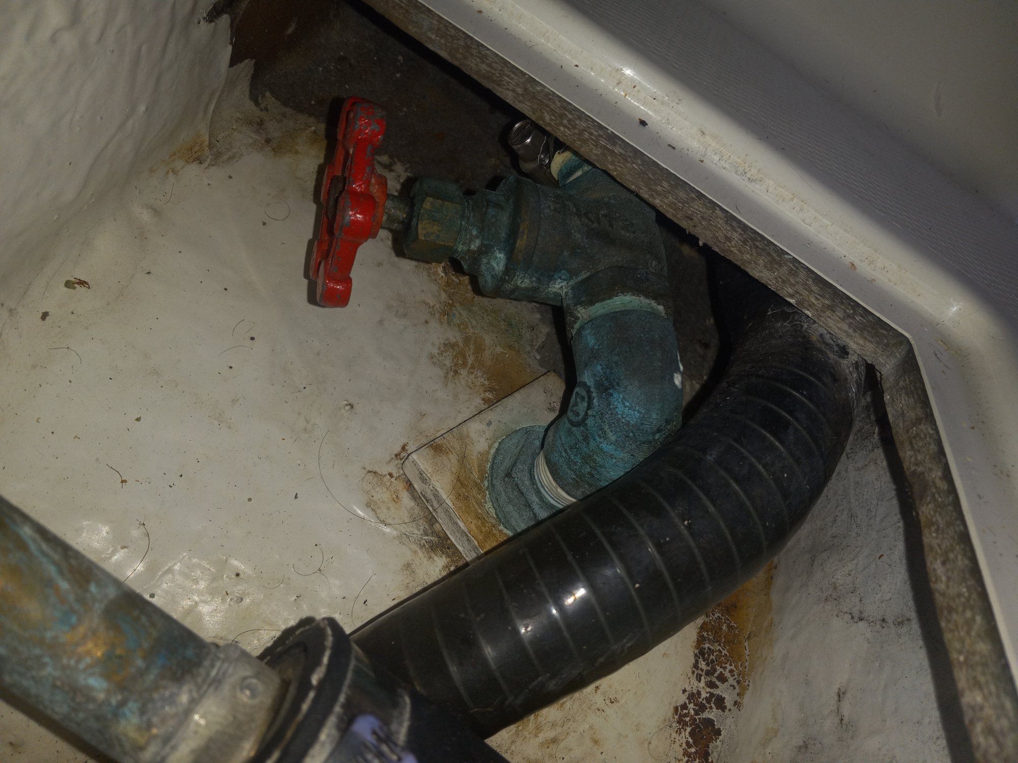

Yamaha 25 Campbell river
It has come time to do the thruhull and seacock for my engine intake, i am trying to visualize in my head how they possibly got this in there, has anyone replaced them yet and have any pointers about it. Im thinking once i haul out and i have the thruhull out I can jam the new assembly through the open thruhull and hopefully tighten it up afterwards somehow? But am worried about the valve getting in the way. Im hoping i dont have to cut parts of the floor out just to replace the ballvalve/seacock...
Anyone know of a brand of seacocks/ballvalves that are made to be super compact or anything? Im pretty stumped

Looks like once you are out of the water, you can pull the top and wheel and gate out of the valve to get the body (now that the wheel and stem are gone) to unscrew from the ell. A small, bronze, quarter turn valve may be able to screw back on (without the handle) then you can replace the handle once the valve is installed... Measure carefully. Good Luck.
EDIT: You may have to fabricate a special handle for a quarter turn valve in order to get enough "swing" to operate it.

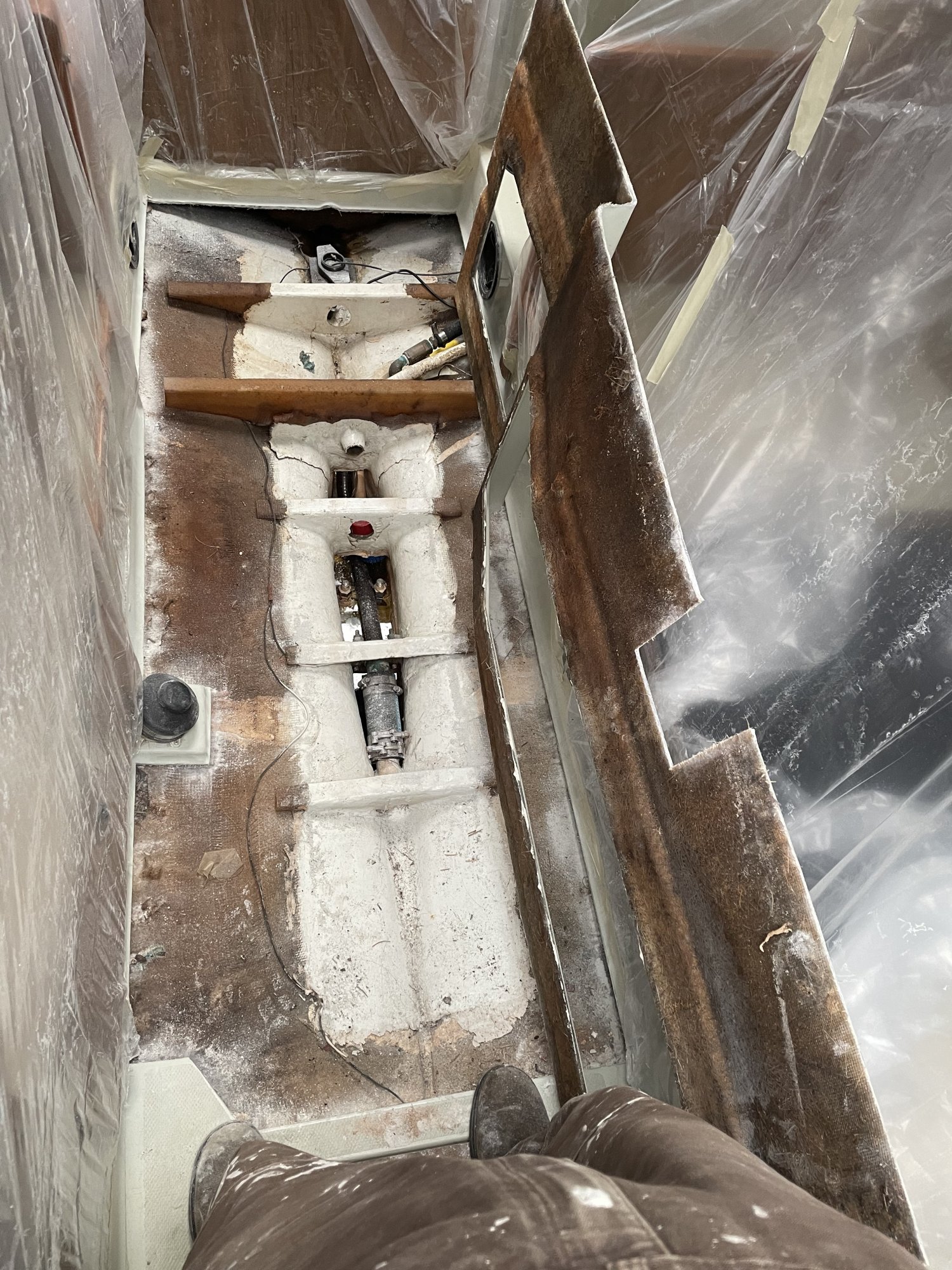

You shouldn’t need to do this to replace the thru hull. I was able to remove mine and replace the thru hull, elbow, and valve(used a groco ball valve from defender marine) during my refit. Now I’ve cut the floor out to re-do / reinforce the “stringers” due to keel wobble and oil canning in the hull outboard of the keel stub which I noticed while the boat was in the slings during last haul out. Syntonos and others have done the same.
