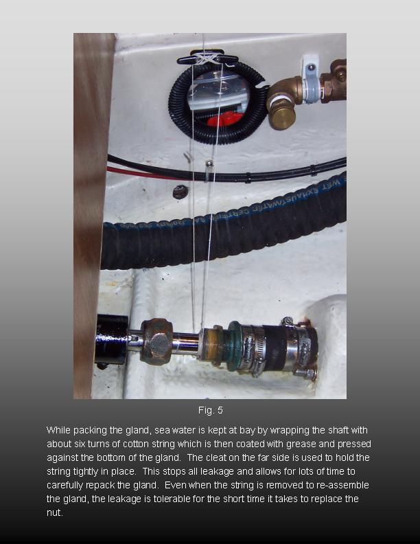

I pack my stuffing box in the water as I don't want to pay for being on the hard for a job I can do in the water.
If you are experienced with packing a gland, here is how I keep the sea water where it should be while taking my time to do it right :
This is part of a piece I wrote on how to run a gland without any leakage. The gland also runs cold.

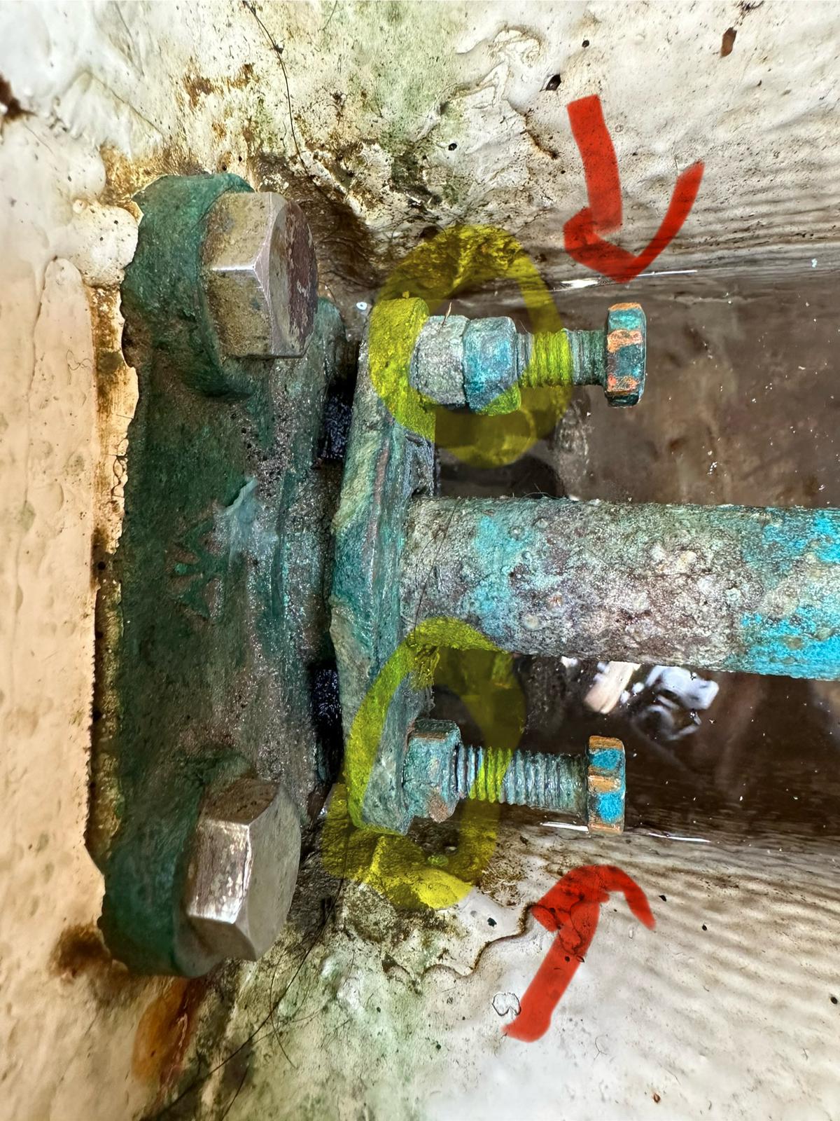

Is this the standard box below in the photo?
I am thinking I should be tightening the nuts closest to the collar (or loosening them to replace the packing). But I don’t understand what the bolt heads are for (red arrows).
Ignore the corrosion! I’ll take a wire brush to my stuffing box later

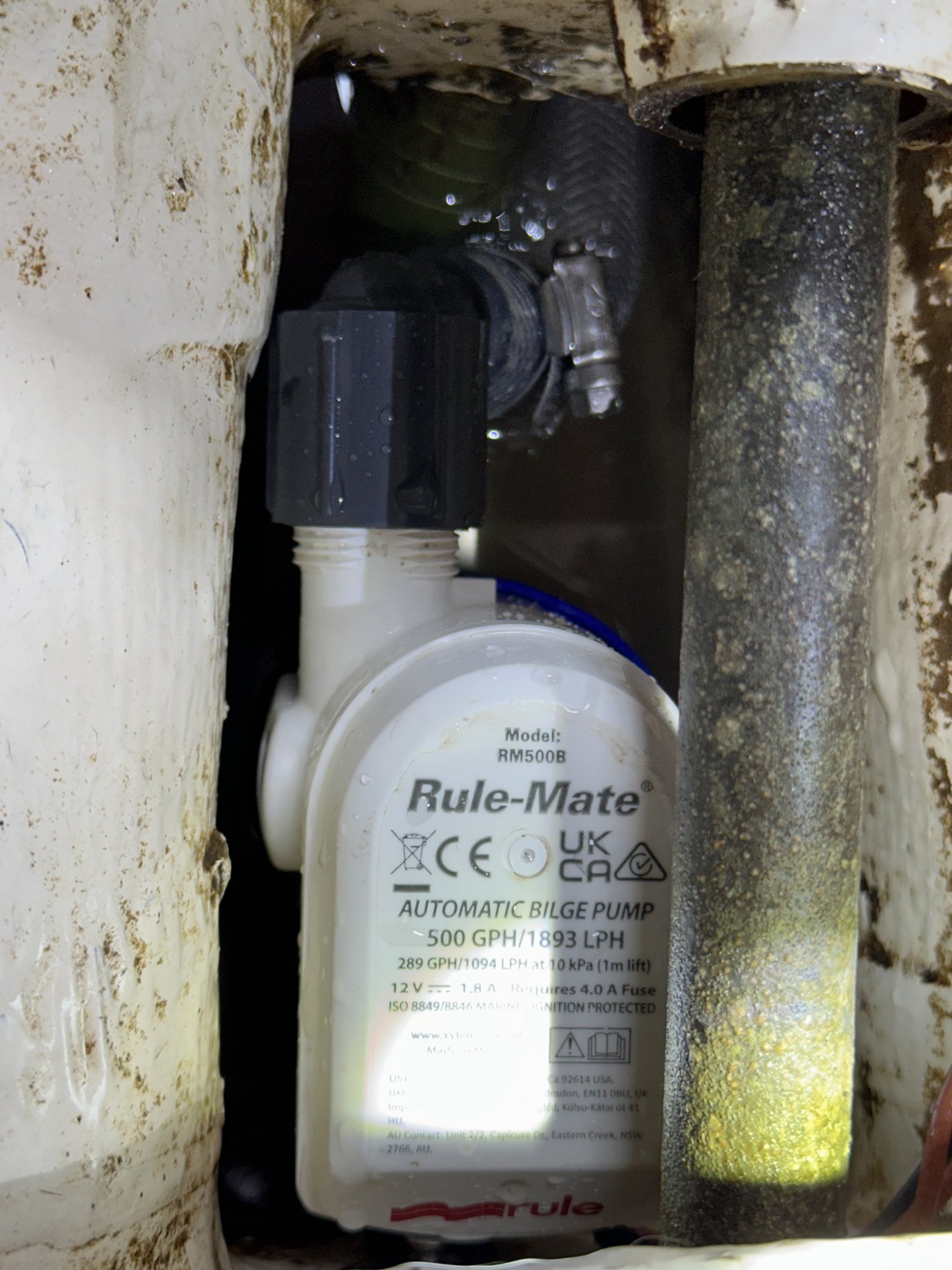

Managed to install a Rule mate 500 in the Yamaha 25-II - fits in the first compartment of the bilge closest to the engine. Routed a 3/4 hose to a tee connected to the manual bilge drain behind the companionway entrance (keeping the manual pump on its own 1 inch line). Wiring for the pump - there’s a gap between the floor and bilge area that allows routing to the battery away from the water (about 3 feet distance).
The red bolts allow you to move the collar right out of the way when repacking and the nuts are for adjusting the pressure on the packing. From the picture I would say you could get two rings of packing added. The leaking will not increase significantly while you add packing without removing the existing packing. This style of packing gland is much more common in industrial settings than marine.
