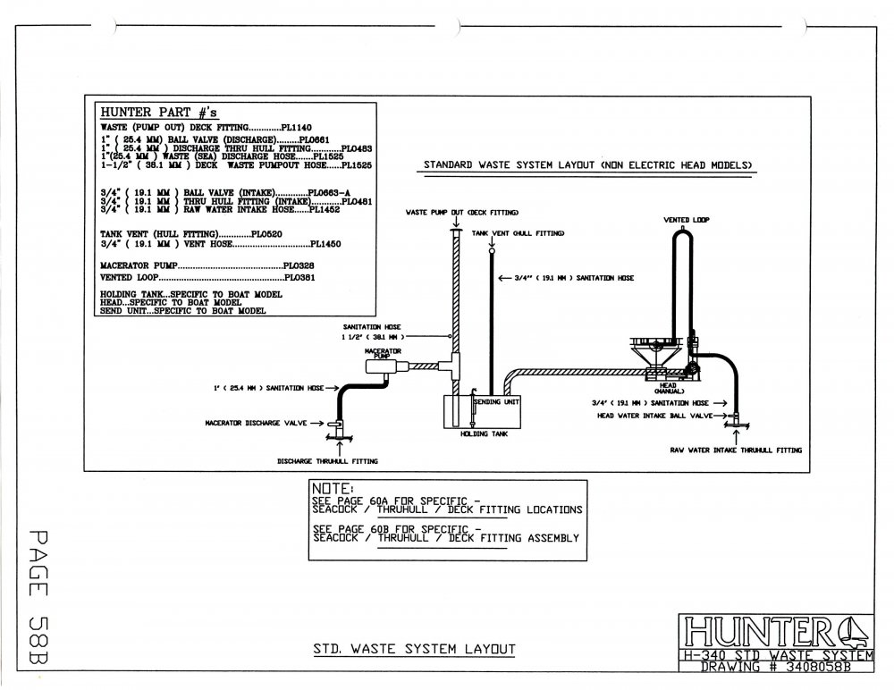

We have a 2000 34 foot Hunter and recently changed our manual Jabsco head from salt water to fresh water and now have it piped to get the tap water to flush it. Unfortunately, it has become very hard to flush. A friend says there may be a problem with the y valve, and though we found a diagram of it in the specs, we can't find it on the boat. We've torn everything apart to look for it. Does anyone have any ideas on where it is and how to solve this problem?

In 2000, Hunter's 34 ft model was the H340. Assuming that's what you have, here is the page from the owner's manual that covers head plumbing. There is no Y valve, just a T fitting in the pvc pipe leading to the deck pumpout fitting. The T goes to a macerator located in the stbd aft swim step locker.

Now to your toilet problem: I don't see how any y-valve could cause your problem unless you've added a y-valve to the intake line to let it alternate between fresh and sea water, there shouldn't be one in the intake (and it needs to come out!)...nor in the toilet discharge line unless you've plumbed it to go overboard or into the tank. Otherwise, the only y-valve should be in the TANK discharge line, to provide a choice between pumpout or dumping the tank at sea. Hunter used a tee fitting instead (because they cost less than y-valves), but a tee fitting doesn't provide any way to shut off the flow of waste from the tank if you have to work on the macerator pump--something no one ever finds out they have to do when the tank is empty.
So I strongly suspect the problem is a blocked tank vent. When air displaced by incoming flushes has no way to escape, the system becomes pressurized, creating back pressure that makes the toilet increasingly harder to pump and causes backflow into the toilet. So don't us the toilet again or attempt to pump out until you've cleared the vent or made sure it isn't blocked. The two most common locations for a vent blockage are the VENT thru-hull and the other end of the vent line--that end of the hose and the vent fitting on the tank. Start by using a screwdriver blade, ice pick--whatever works--to scrape out the thru-hull. If the tank is seriously pressurized, that may result in a spew if the thru-hull is the only block. If cleaning the thru-hull doesn't solve the problem, you'll have to remove the vent line from the tank and scrape out that end of the hose and the vent fitting in the tank. BUT BEFORE YOU DO THAT, open the deck pumpout fitting to relieve any pressure in the tank! And have a hose at the ready. If the toilet hasn't been used in several days, the pressure may have dissipated, so don't assume that blocked vent isn't the problem just 'cuz the tank is no longer pressurized.
