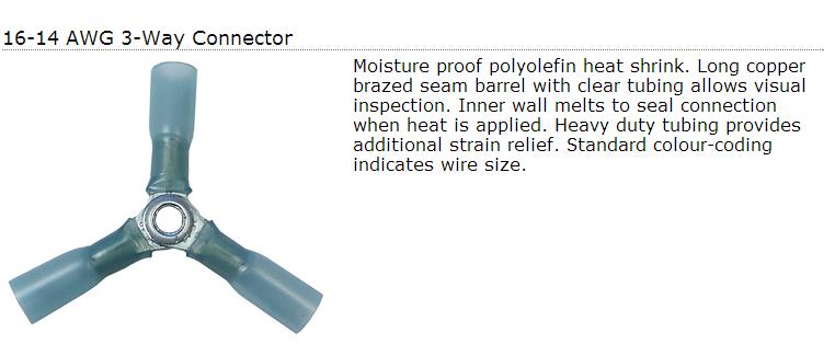

What's been your experience with these connectors? I paralleled the power wires to our refrigeration unit and still have experienced low voltage at the compressor/electronic module when on battery only power (works fine when plugged in or the alternator running).

#1 I really dislike the three-way connectors as the grommet or rivet used often tends to get loose over time.
#2 I dislike running additional parallel wires even more. They do not always work the way you would expect them to. Both wires will have different resistances due to corrosion, terminations etc.. Any wire that deserves being bigger to correct for voltage drop also deserve a new run with the proper sized wire and properly installed terminals.
