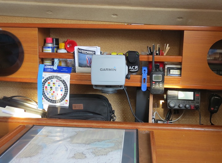

thank you for your quick response. You are probably right, that "it would be almost impossible to find an original box-stove cabinetwork for sale anywhere" and it will be only wasting of time and/or money. The example form Sidney is a later version of Ymaha, marked as a "26 CEX" like this one; https://www.youtube.com/watch?v=5x6elHClUn8 where you can see very intresting solution of stov-box with gaz cartridge stov (2.02min and from 4.57min) It is as I understand, very simmilar with your's? (but fixed not rolls). I will tray to build or rather to order, something like that, locally in Poland. Could you tell me pls. how you solved your navigational support? Where you mounted chartplotter, VHF, AIS, chart table etc? Do you have some repeaters of instruments inside the cabin? Are you racing or only crousing across this nice SFB?

See the attached image for my nav station. It is located on the starboard side just above the dinette table which I use as a chart table.
Here are answers to the other info you requested.
I have basic speed, depth and compass instruments in the cockpit. I don't have any repeaters. The chart plotter swivels and can give most information (depth, speed, distance, course, etc) except for wind data from the nav station. I have interconnected the chart plotter and VHF radio. I don't have an AIS capable device yet. I also keep a hand held waterproof VHF in the cockpit when sailing. I also have a Raymarine autopilot for the tiller. My wind instrument is simply a Davis 15" vane. The inverter (thin black object) is to the right of the chart plotter. Finally my emergency location instrument is an ACR unit.

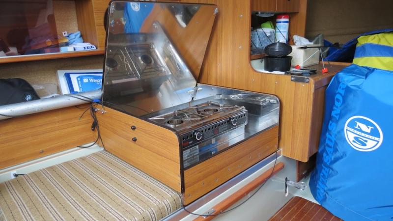

Attached are a few images and details of the cook top that came with my version of the boat. I hope they are helpful as you go about designing something for your boat. The interior of the box is entirely stainless steel lined. There are brackets that keep the cook top in place. You can't easily see them but there are also brackets that rotate so that when opened the cook top can be made to gimble (rotate to stay level). When sailing I more often than not slide the entire box out of the way into the port side quarter berth so it is totally out of the way giving the central space an open airy modern feeling. It slides and glides with very little effort. The bottom of the box itself is about 1/2" above the cushions allowing them to stay in place when moving the box.
