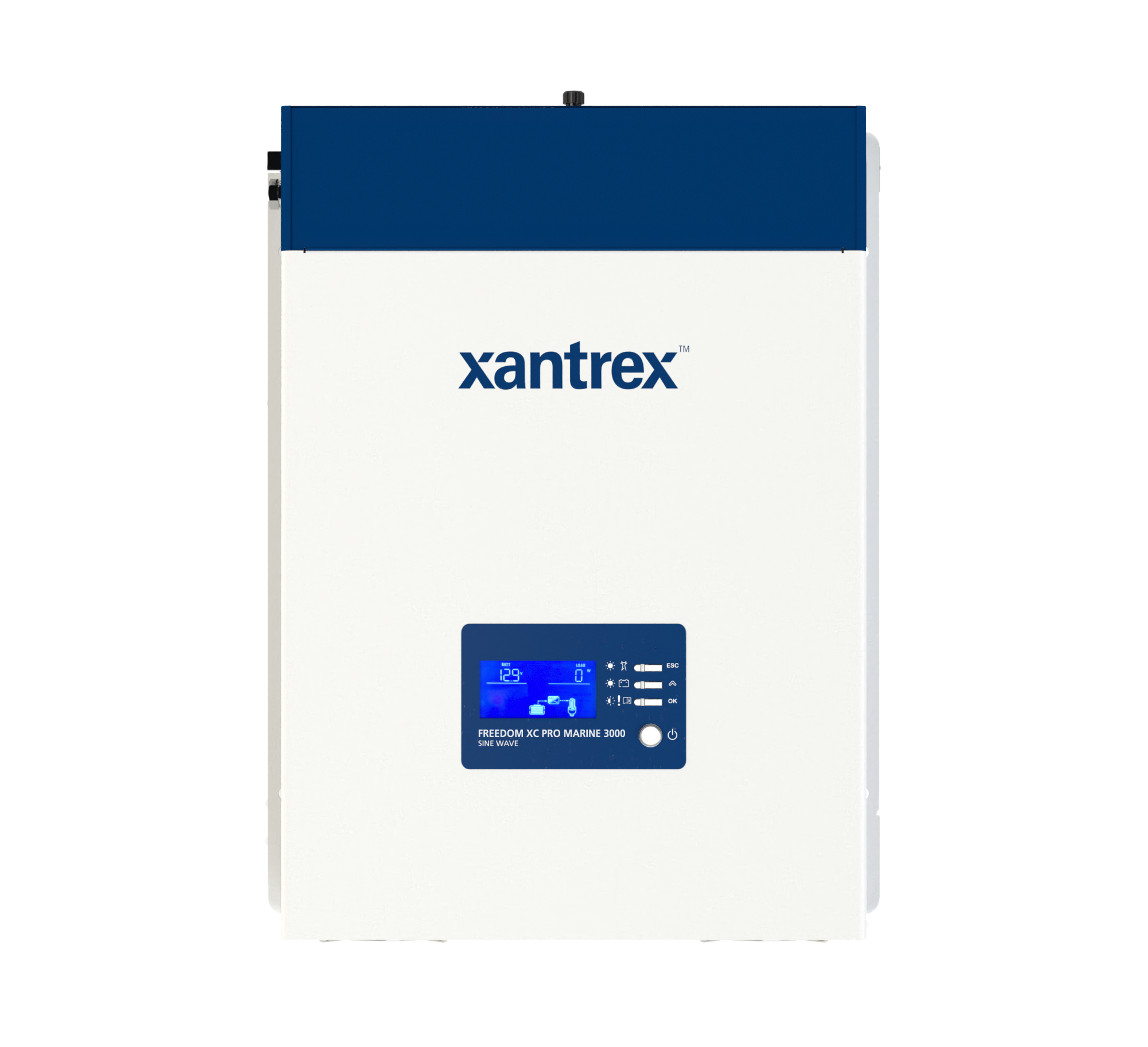

I had a incident with that ICG, and they did not honor their warranty.
I wrote the Factory reset inside that old manual.:facepalm:
I have since upgraded to their newest ICG.
The best Lithium battery charger that I have researched.
Jim...
