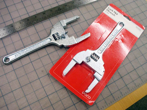

Can anyone tell me what size wrench(es) are required to tighten the stuffing box on my 87 Hunter 28.5? The guy who sold it to me said he had used silicon when he replaced it on the hard, but I should loosen it to 4-5 drops per minute before launching her. I think I can figure out which nuts/sleeves to loosen but want to make sure I have the right wrenches to take with me. Any advice on this? As always, thanks for your help.

You can buy the packing nut wrenches in Ralph's pix for about $15 ea @ home depot. They work well.

I don't know if this will work for you, but I use large water pump pliers. I already have a few sizes in my tool box that work, so there was no additional cost for new tools.

I use packing wrenches, but one time had to use a big pipe wrench as one nut was on so tight

I use the same wrenches as Ralph & Warren.
