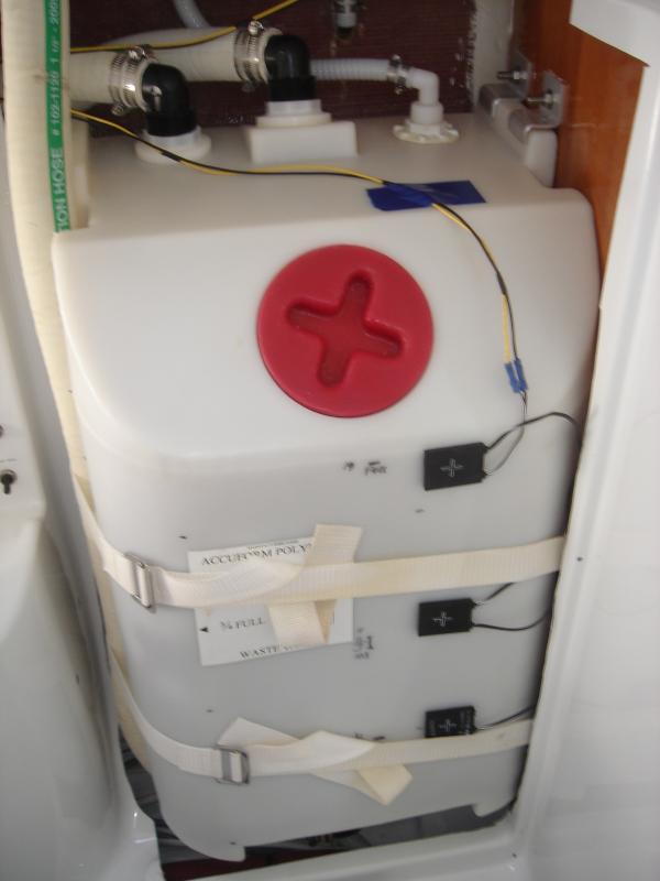

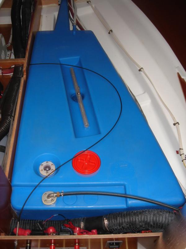

Is there a source for the "+" shape wrench that fits the plastic access bungs in
the aft water tank and also the waist tanks? Or do we just build one that
works. See attached photos; red disk with + shape face is the inspection plug.
Last season I had a fresh water leak in the aft tank inspection plug; only a
problem when the tank was full; used a galley pot handle in the + slots to get a
fresh seal. Marking the original position and the new position, I managed to
get a 3/8 inch additional clockwise rotation to re-make the seal. The pot
handle was not a good fit however.
Just asking.
