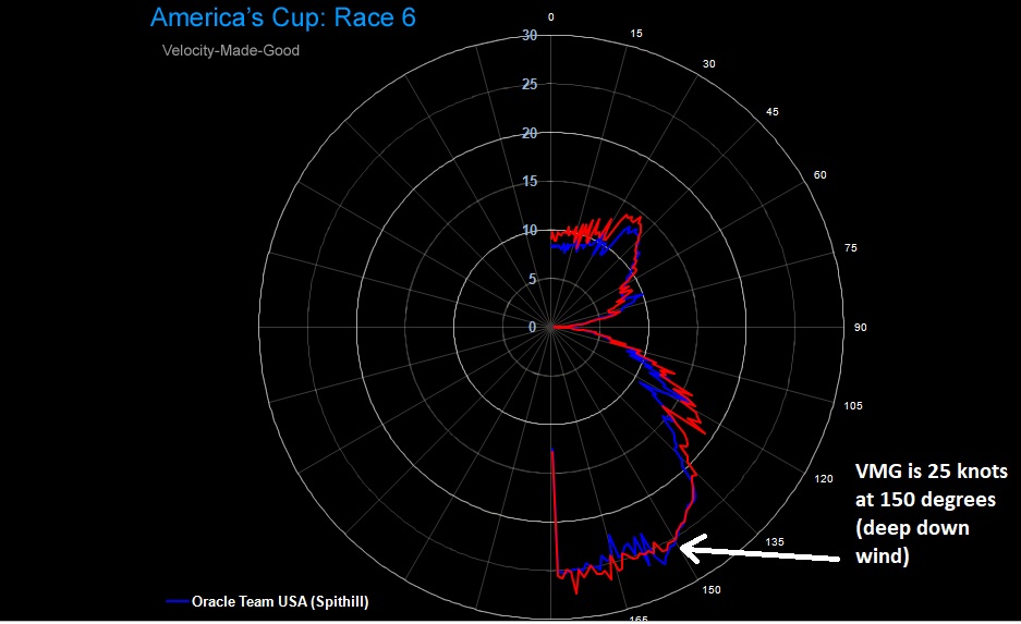

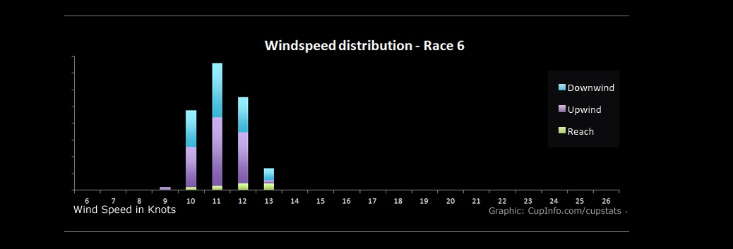

I took some snap shots from those links which show the concept.. In the polar plot below (which is real data), I have highlighted that the VMG for race 6 (in this case for down wind) is 25 knots for down wind angles of a little over 150 degrees and somewhat beond that. The second plot shows the wind during race 6 at around 11 knots.
That seems pretty clear to me that you can make VMG downwind faster than the wind is blowing. Ive also experienced this myself ice boat and landsailing. But.. correct, our sailboats here will not do this.
http://www.cupinfo.com/cupstats/index-ac34-statistics-polar-plots-02.php#SOG
http://www.cupinfo.com/cupstats/americas-cup-2013-stats-wind-distribution-01.php#race-6
