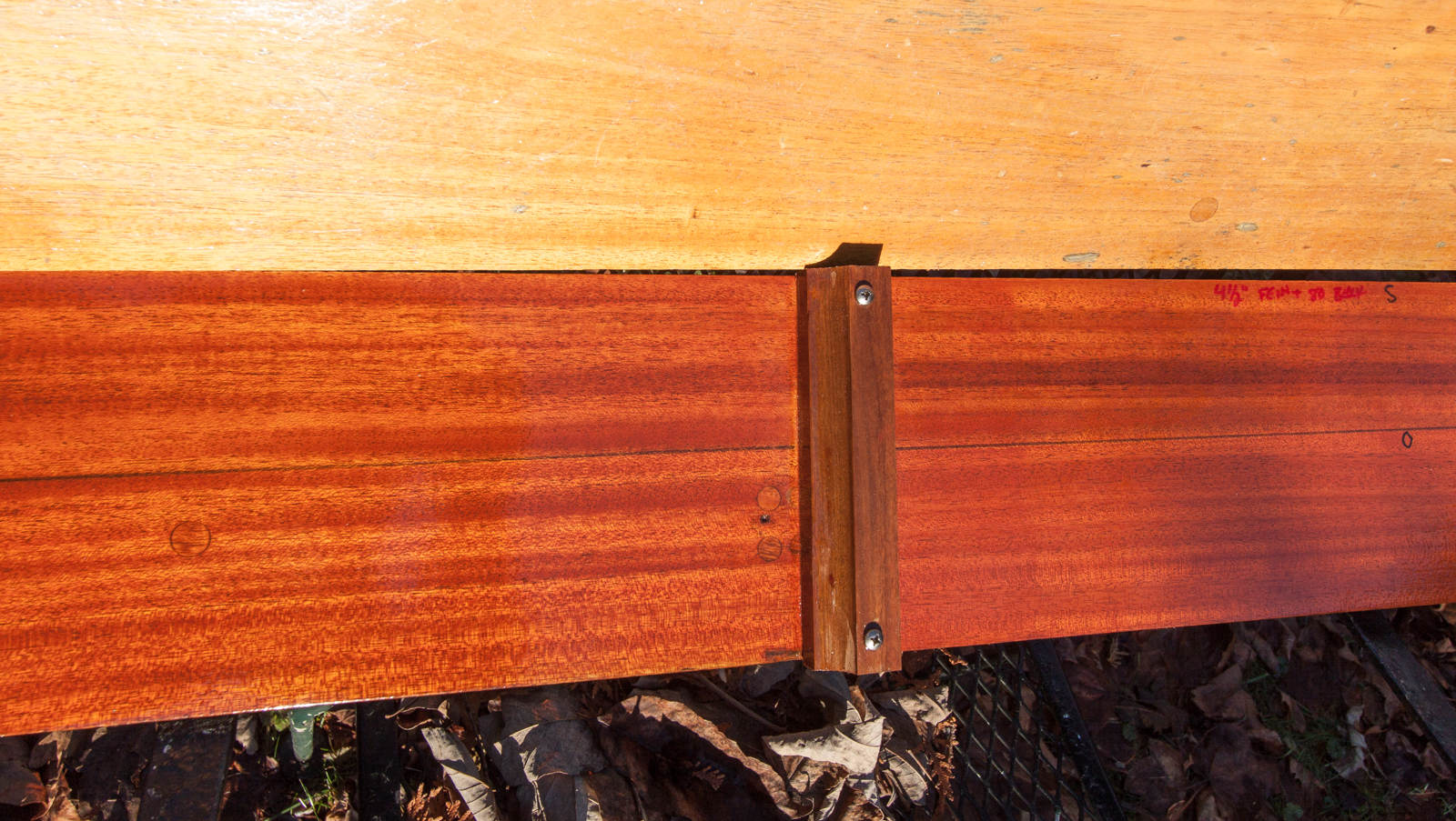

It's mostly a wooden boat term. Once a coating fails (and they all do from varnish to awlgrip), 'wooding' refers to stripping the old coating off, down to the bare wood.
Sanding of course, deepens the color of sun bleached wood. But in boats, stains have been used ages. What kind, how much and whether to use it all, is an art I know just a little about. I'd like to know if this hull was stained before the new varnish coats went on (maybe I'll find out).
Below is a piece of my 50+ year old cockpit well, ripped in half. African mahogany, the upper strip is how it looked after at least 20 years of very little varnish maintenance. Bleached out.
Below, is wooded and sanded with 80 grit in a RO sander. Than an Interlux sealer stain in Chris Craft Red was applied, as per directions. It then has a couple coats of sealer and 2 coats of varnish. I did this test; liked the looks, then did the same to my cabin house last year.
Irian didn't get this deep a stain treatment, but this is the typical depth of color that many mahogany boats will get upon 'wooding'.
