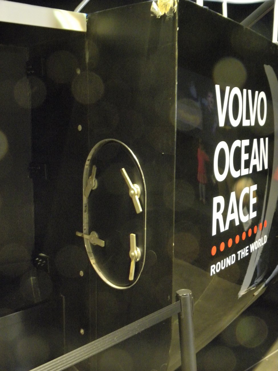

Waterproof compartments! Look at the Volvo boats. They could have their bows staved in and not sink. That is what you need. I don't know the B393. It may have that. Here is what I consider ocean worthy. Other types of designs have made successful voyages. But I think for serious voyages water tight compartments are desirable.
