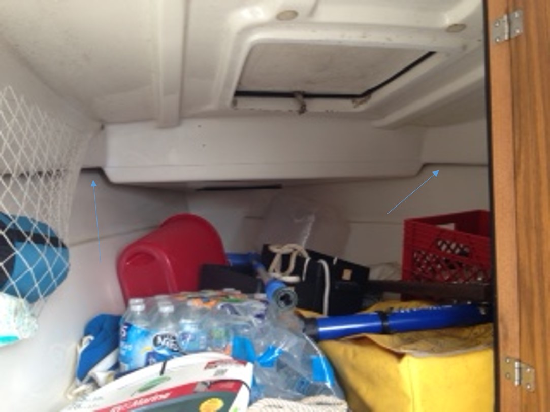

Some of the flotation in my '95 26D is in compartments that are sealed so I can't see it all of it. There is supposedly some under the cockpit seats, some over the sink, and some where the anchor locker should be. Note that at some time in the past, charcoal lexan was put over holes cut into the location over the sink and anchor locker. What I can see in those two areas looks like the white styrofoam (at least I think that's what it is) that is commonly used around electronics when they are packaged.
My guess as to how much is above the sink: 6" deep x 18" x 30". Where the anchor locker should be: 6" deep x (1/2 * 18" * 24"). Ok, I know the anchor locker is not a right triangle, but these are all guesses anyway so should be close enough.
Jun 1, 2015
217
Macgregor 26d Trailer Estates, Fl
My latest thought on this is a crazy one. You could easily calculate the volume of the current material (by taking it out :) ) and then calculate the amount of flotation it would provide.
Given this information, could you calculate the amount of spray foam insulation that you would need. Then, put garbage bags where the top and bottom come together and spray the foam insulation into the bags. See the blue arrows in the picture for where I am talking about. This slot runs from bow to stern on my 26D. Note that I'm sure there is a nautical term for "this slot" so folks can feel free to educate me on what it is.
You could replace the amount of flotation (or probably even increase it) however, it would be in different places than the original, but still near the top of the boat. It would be in a place that is totally unusable at this point (except for running wires so you may want to put in pvc conduit with a pull string or two for future use.).
As I started out, this is a crazy idea. You may have noticed, I really want an anchor locker and the space under the cockpit seats would be really great as well.
