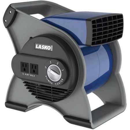

NJLarry, if you are just considering dockside solution try these. I use two of them for sleeping one in each cabin. They have three speeds and I only use the lowest speed. Also good in the cockpit on a hot day while lounging around. Available at Walmart, you will love them!

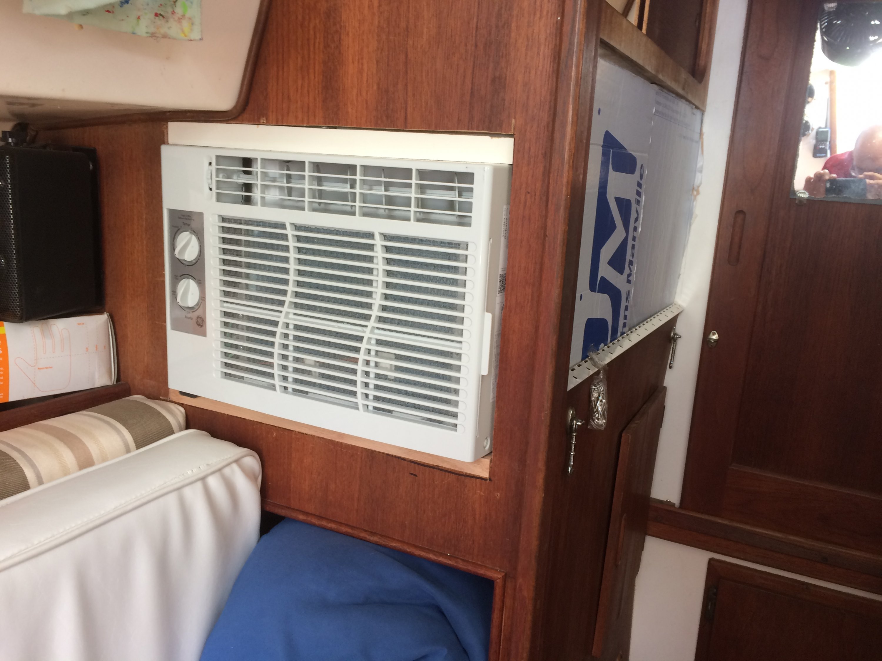

I agree with others. The value of any upgrade to these older boats is how much it increases my enjoyment. I've added more than triple the current market value of my old boat in upgrades, and now I have exactly the boat I want.
Here's my a/c solution...
