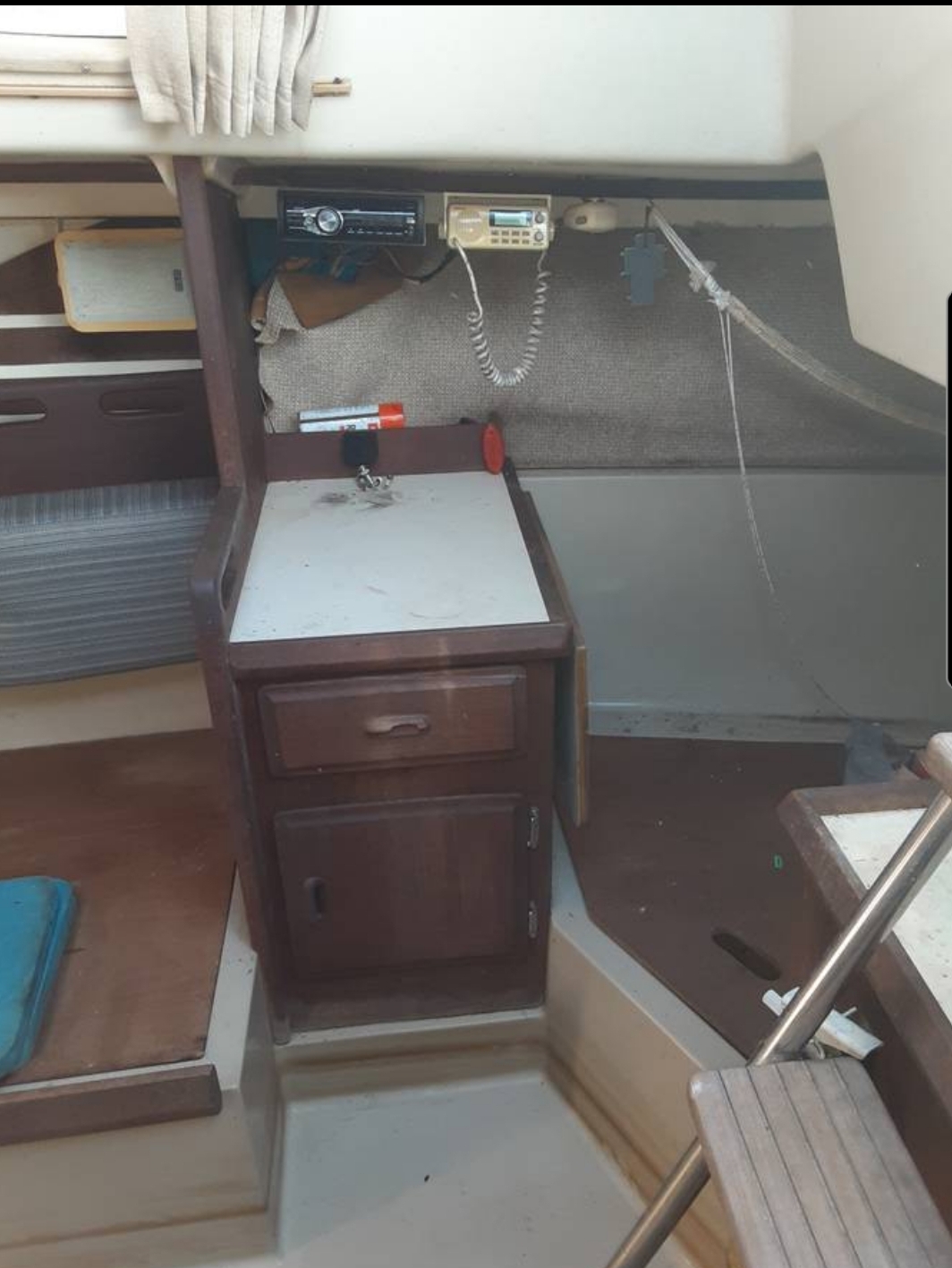

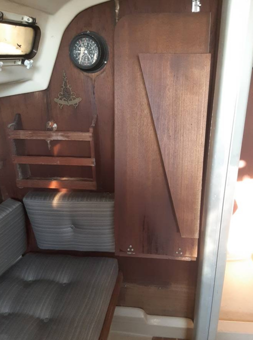

OK, so my wife and I are in the early stages of looking for a boat. It is likely a couple of years away, unless we come across a really good deal. So, today I came across an add for a1983 O'Day 28. Because of travel plans (new grandbaby to meet) we can't even think about seeing the boat for at least 2 weeks.
We are wanting something that we can spend the weekend on and maybe a week's vacation now and then. I have in mind that 30 to 34 foot is the range I want to look at, but came across this O'Day on Craigslist. At first glance the pictures look good...I believe the layout and space would be suitable. The seller has been upfront that this boat has sat for 5 years...so there are certainly some things to check out. He mentioned, in an email exchange, that there are some minor leaks around the handrails and that it needs a new cutlass bearing. OK, those things don't automatically make me want to run away...at his list price, and hoping to maybe get it a little lower, it is worth all of that.
But then I pulled up the photos on my computer rather than my phone. It looks to me like there are marks/lines indicating standing water. Assuming engine works, as he says it does, how concerned should I be with this? Are there some specific things/places to look for hidden damage?
Or, despite an asking price of $4,900 is this simply something to run away from as quickly as possible? Certainly before purchasing we would do a survey. But is it even worth going that far?

If there was standing water then the boat was partially submerged with subsequent engine damage otherwise just water leak from rain. I came across the same situation (water leaks from a companionway door and 3 windows) and purchased the boat on the basis it was deferred maintenance that I could easily repair with the help of a contractor .......now the boat looks new inside.
That is a very reasonable price for a 1983 O'Day 28. Recommend a hull survey, sea trial to test the the engine functionality and check the fluids, and inspect the electrical (might require an electrician to spend an hour), standing rigging and sails. The once you purchase the boat perform an engine maintenance, replace the tired running rigging, clean/buff/wax/polish and she will feel/look new.

Looks like water was in the boat for enough time to leave a pretty wide water line. Could have been a boat that was damaged in one of the hurricanes that came through NC. That is the type of water deluge that can fill a boat.

This one, on the other hand, doesn’t look great. That water line is very close to the bottom of the engine, and the rest of it also looks pretty worn. Also, if the handrails were leaking for any length of time the core under them is probably rotten, making the repairs there a bigger project.

Handrail leak however gives me a big big pause. Is that what let in the water over the 5 years it sat? The deck on that is balsa cored (please correct me if I am wrong). If it were me, I would add cost of re-coring a significant amount of the deck to the sales price and if it were still a number I was comfortable with, I would pay for a survey.
I personally would not pay for a survey at that asking price, but that could be different for you if you plan on doing all the work yourself and find it satisfying. In my experience it is always more cost effective to spend more on a boat that does not need any major repairs vs buying a cheaper one that does. Small stuff is different (cutlas bearing, standing rigging, seacocks, a little wiring, but of paint etc.) Also an O’day 28 won’t get you back your investment in that repair if you decide to change later.

An Oday 28 would be a fine choice for your needs - but this one is suited for someone who has lots of experience fixing up boats.
For your first boat don't even look for boats with a surprisingly low price - there's usually a reason. Instead find a boat that is in better than average shape - hopefully with an owner who has meticulously cared for her. Yes this will cost a little more but you'll save two times the extra price in lower repair costs during the first 12 months of ownership.

That boat looks shot, honestly. The water marks on the walls in your pictures are probably old leaks from the mast or ports, which is fixable, no big deal. The marks on the floor are a concern, but can’t say if it is a big or small one without a survey. Might be old news. Question is does it still leak, where, and is the hull dry? If it’s wet, hello Facebook, and you are probably screwed. The other question for me would be is it the original engine? If so, pass. The Universals in particular were underpowered and now nearly 40 yrs old. Mine has a 25yr old yanmar 30 which is great. But even that is getting a bit old.
