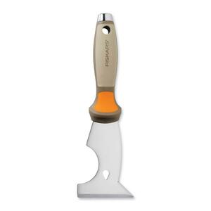

I typically use on of these paint roller scraper tools, no idea what they are really called, but the curved side works well for the shaft and the sharp side works pretty well for the prop.
