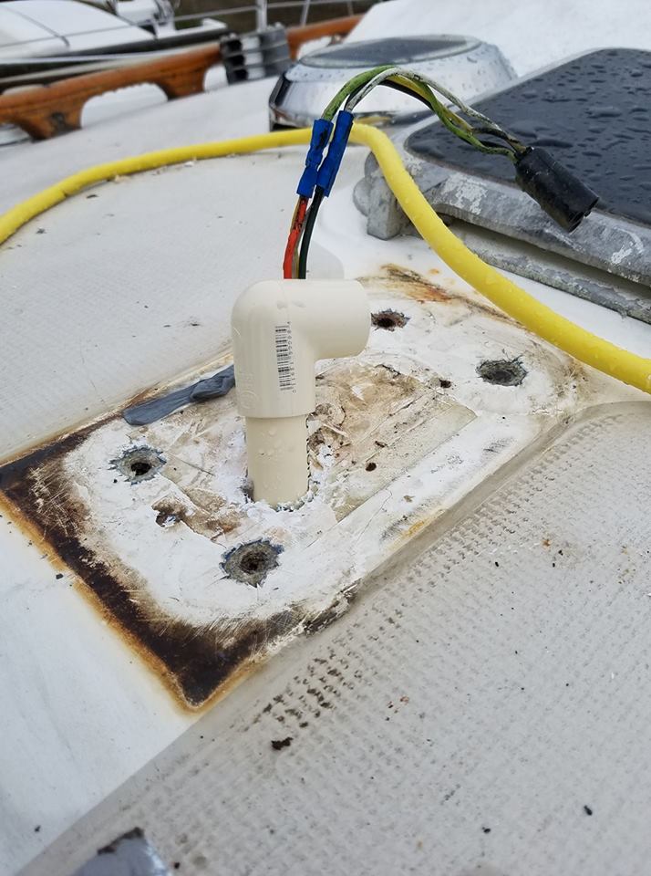

This weekend is mast work, since it is still un-stepped from winter storage. Going to replace my VHF antenna cable with RG 213 (let's not make this about my cable choice, I know, LM 400 and all that but I got this stuff cheap and it's a lot better than what's there now). So, the current cable looks like RG 58U at least it's a small diameter like 58U and it exits at the mast head through a hole drilled in the side of the mast. Clearly I will need to drill a larger hole and find an appropriate sized grommet. Any tips, comments, tricks etc to working with this larger, less flexible, cable? IF you have a larger VHF antenna cable how does it exit at your mast head? Here's a photo of my test fit for the new mast base conduit (PO had used just a hole and an entire tube of silicone) . When trying the fit of the cable I already learned that it is not happy making bends.

My mast is like a street light pole so there is room to get the coax bend in the drip loop. Here is what my mast base looks like.
I have 2 small diameter straight Aluminum pipes running through the base large enough to carry the cables. Then I attached hose to the pipe so that I could get a bend and extend the height of the pipe to reduce the chance of water building up in the mast. Lastly I made sure that the weep holes in the mast base are clear.

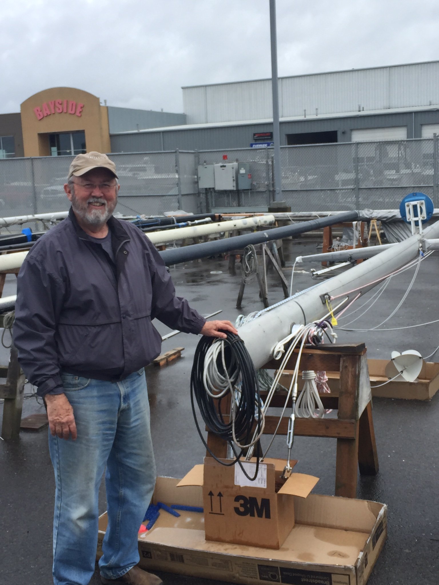

Here is a shot of me and the base of the mast, wires stuffed in the base awaiting hoist to the boat.
Hope it helps.
