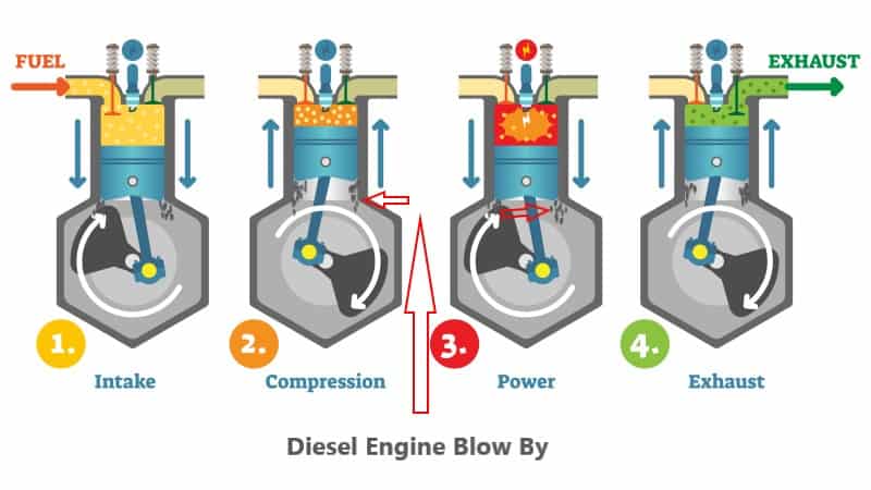

Assuming that your tach isn't too far off (and by all means, test with an optical device), the low rpm's is very concerning. It is often associated with low compression. You can do a simple test for blow-by by removing the oil dip stick while the engine is running. If there are significant puffs of air blowing out the tube, you have blow-back. I'm no mechanic but I believe that will indicate that piston rings or piston walls are damaged and compression is low. These are significant issues possibly requiring engine re-build.
Some blow by is normal, if you should detect just insignificant puffs.
