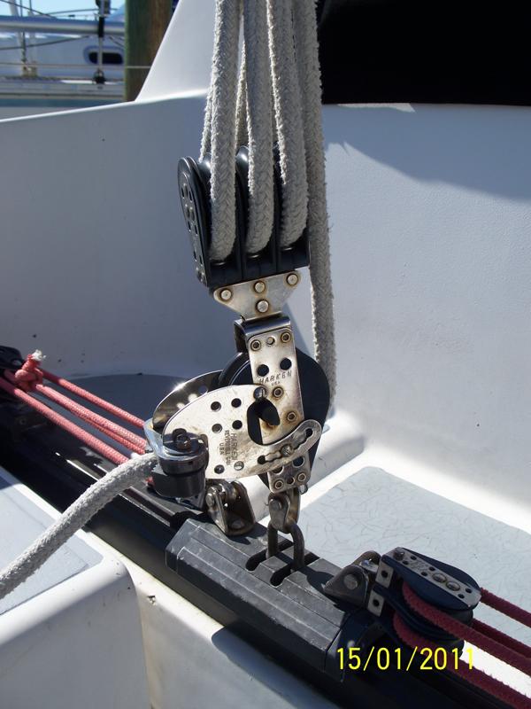

Are you thinking about a triple on the traveler or hanging from the boom? (Sorry I don't recall details of any pics you may have posted through the years.) In either case, I would venture that the weak link in the chain (i.e. the likely lowest breaking load) would be the traveler car itself or at the actual connection points at the boom rather than a new block at either 2000lbs or 2800lbs.

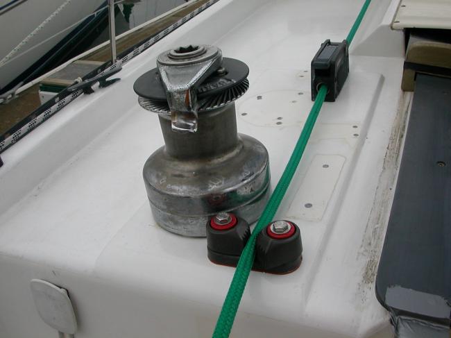

I've attached a pic of my set-up. The traveler triple is a concoction of a flea market double mated to a flea market single. It's held up four years now in the winds of SF Bay's "slot". At the boom, I've added extra bails to distribute the load over a larger area. FYI, the improvement on hand-pulling the sheet with my larger ball bearing blocks (as in the pic) as compared to the standard fiddle and center pin blocks that were on the boat when I bought it ... very really noticeable. I virtually never use the winch for sheeting. See also the second pic for the cockpit control. The green mainsheet leads back to the helm. (This pic was taken soon after my modification. The faired old holes are painted over now.)
