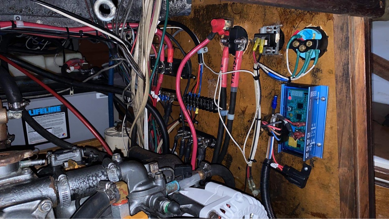

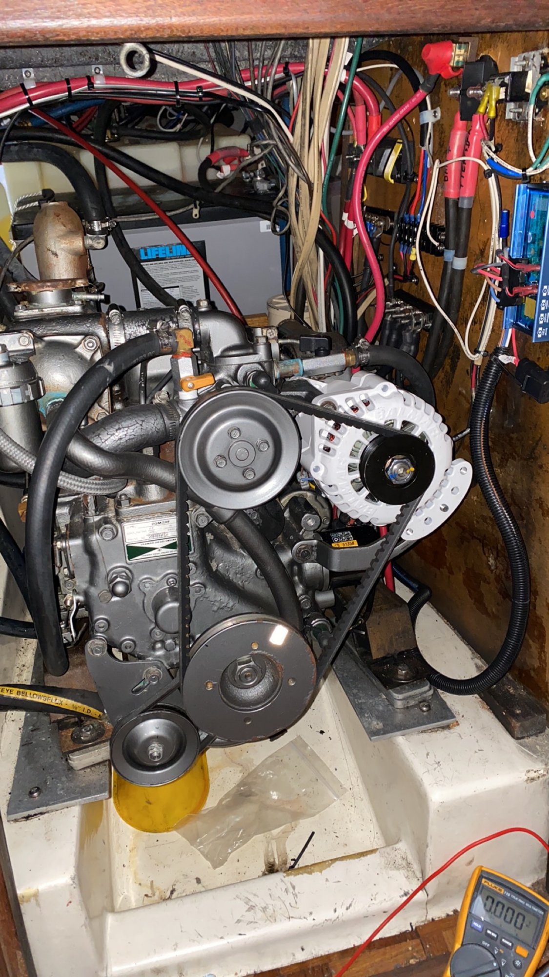

I pretty much did the same thing previously but opposite. I made the bulkhead into two pieces and made the rear removable from the original access hatch back. The forward section isn’t going to be moving being all the electrical systems I installed on it.
Im thinking I’ll take it on from the rear sides and if I don’t have enough room then I’ll remove the fuel tank for more room. I installed the platform and fuel tank about 3 years ago when my original tank leaked and saturated the whole thing. The pictures are the “work in progress “ I still needed to i stall the SG2000 battery monitor shunt that went next to the regulator and under the battery switch.
