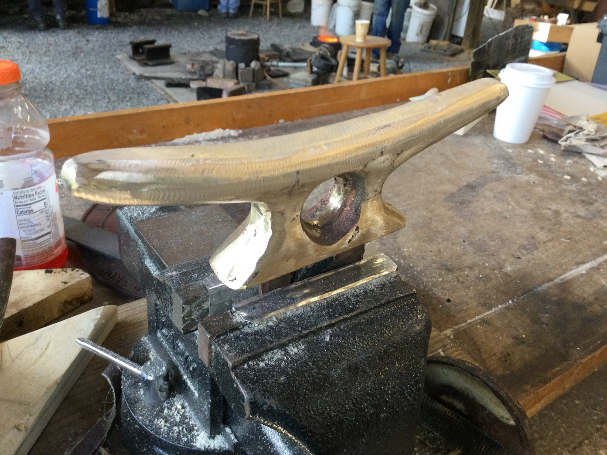

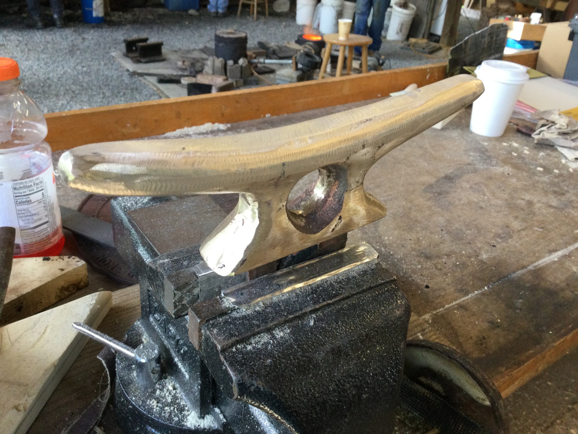

A common exercise in machinist training used to be to make a cube (with fairly tight tolerances) by hand, using only files. And that's with steel! So you could definitely get quite a good flat, true surface on a bronze cast cleat, that way.How are those bronze cleats finished so they bolt to the deck ?

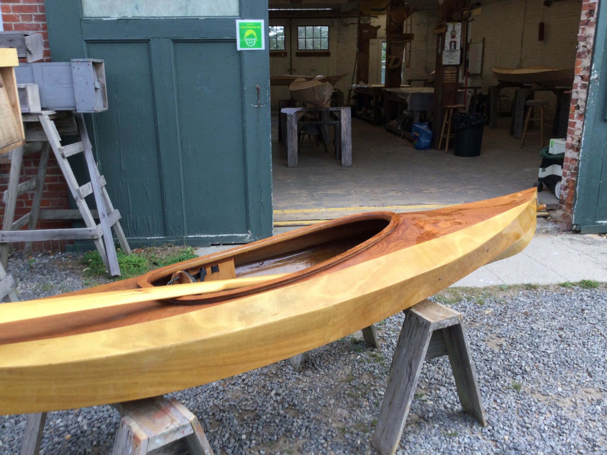

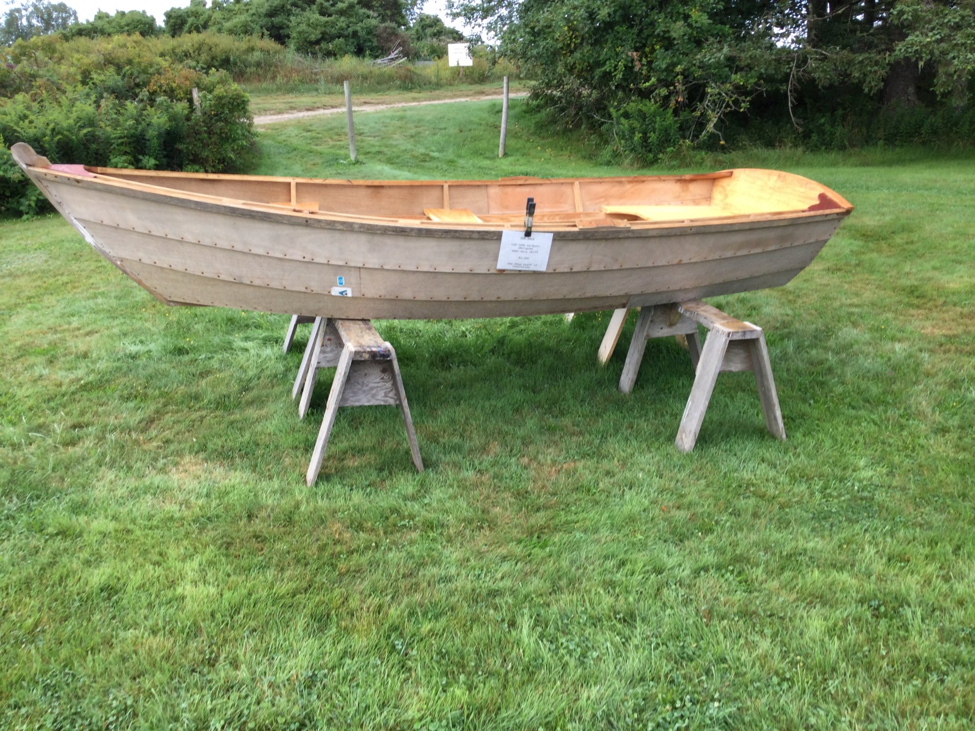

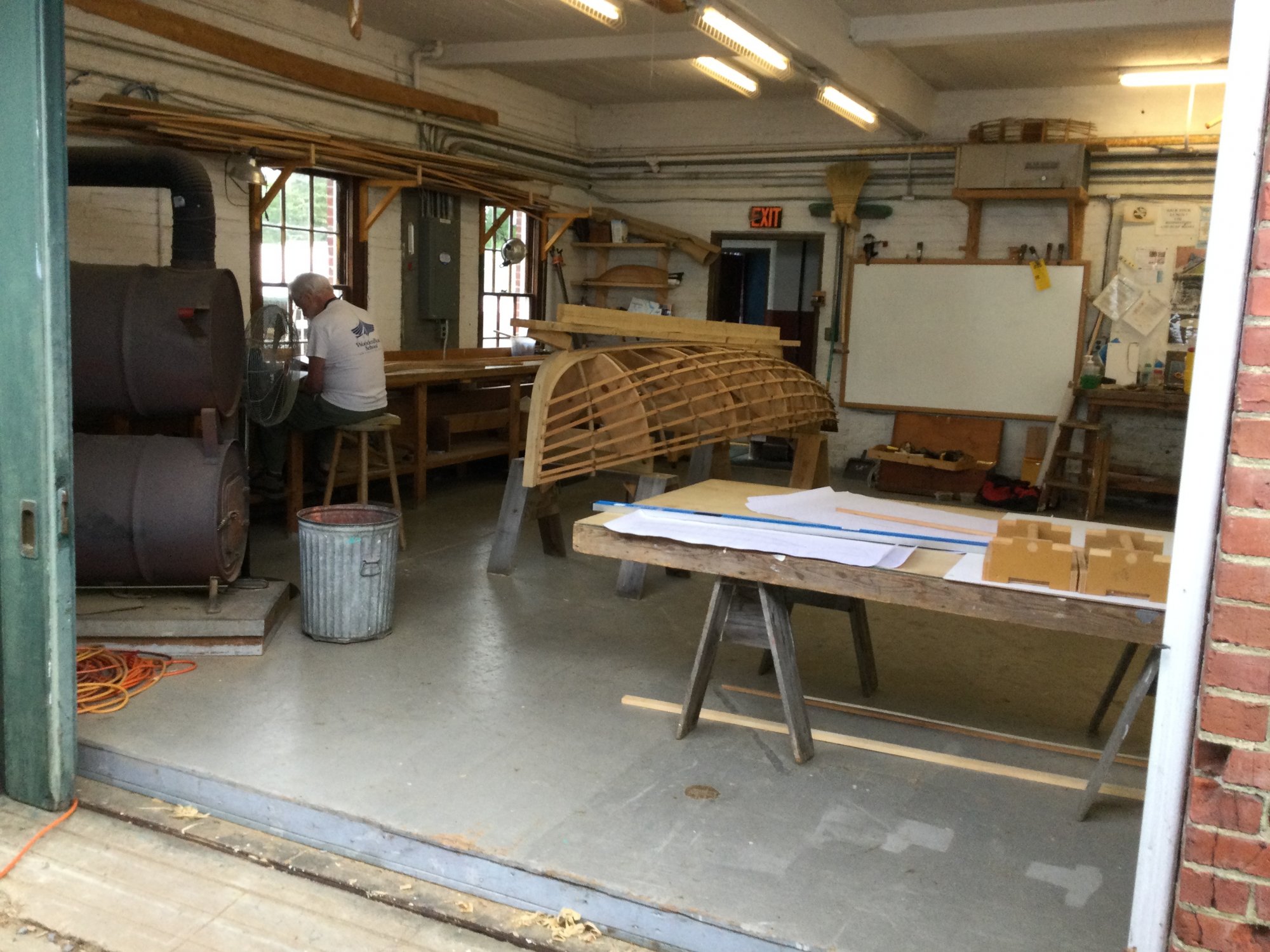

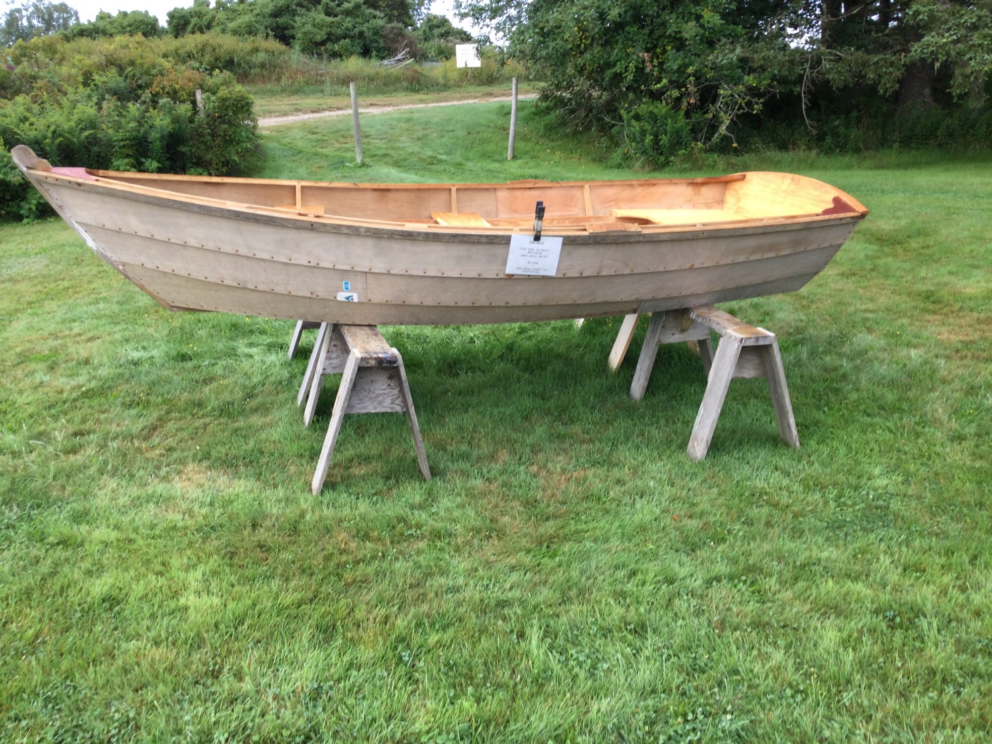

Build a dink! There's nothing like rowing the boat you gave life to around. I highly recommend it. Check out the offcenterharbor website. The kits make much less of an ordeal.. I’m here at the Wooden Boat School, so tempted to build one.
Yup. Doable with a file, a straight edge, and a gauge. Do they still do that project with new machinists ?So you could definitely get quite a good flat, true surface on a bronze cast cleat, that way.

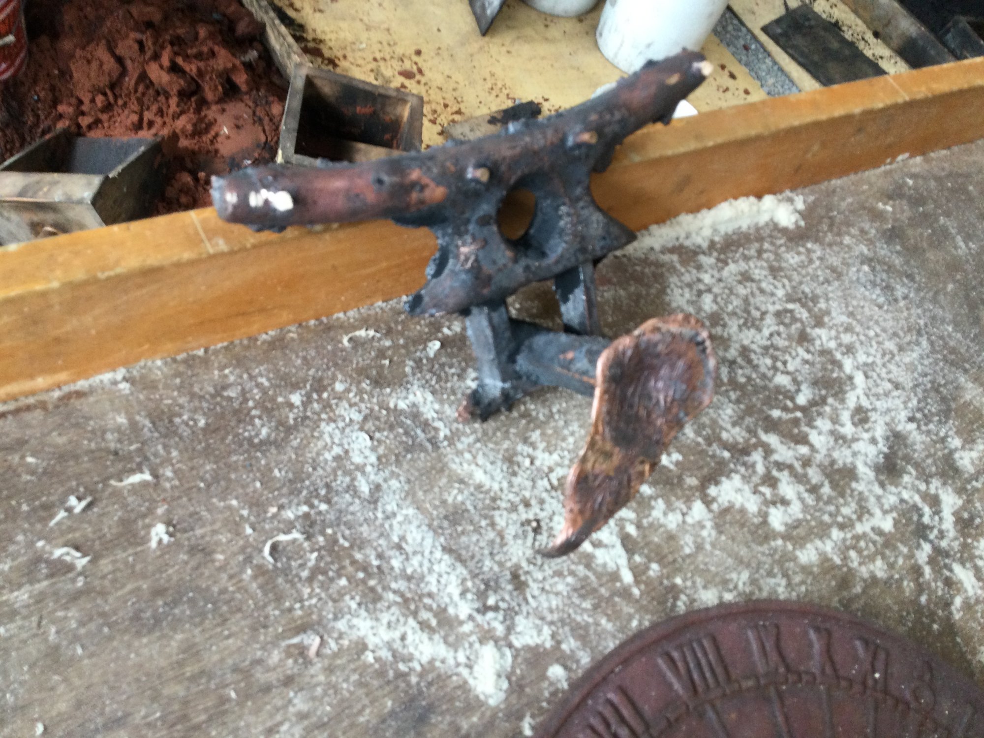

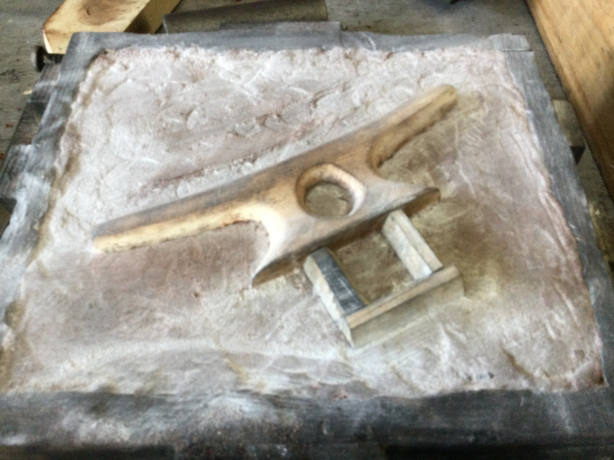

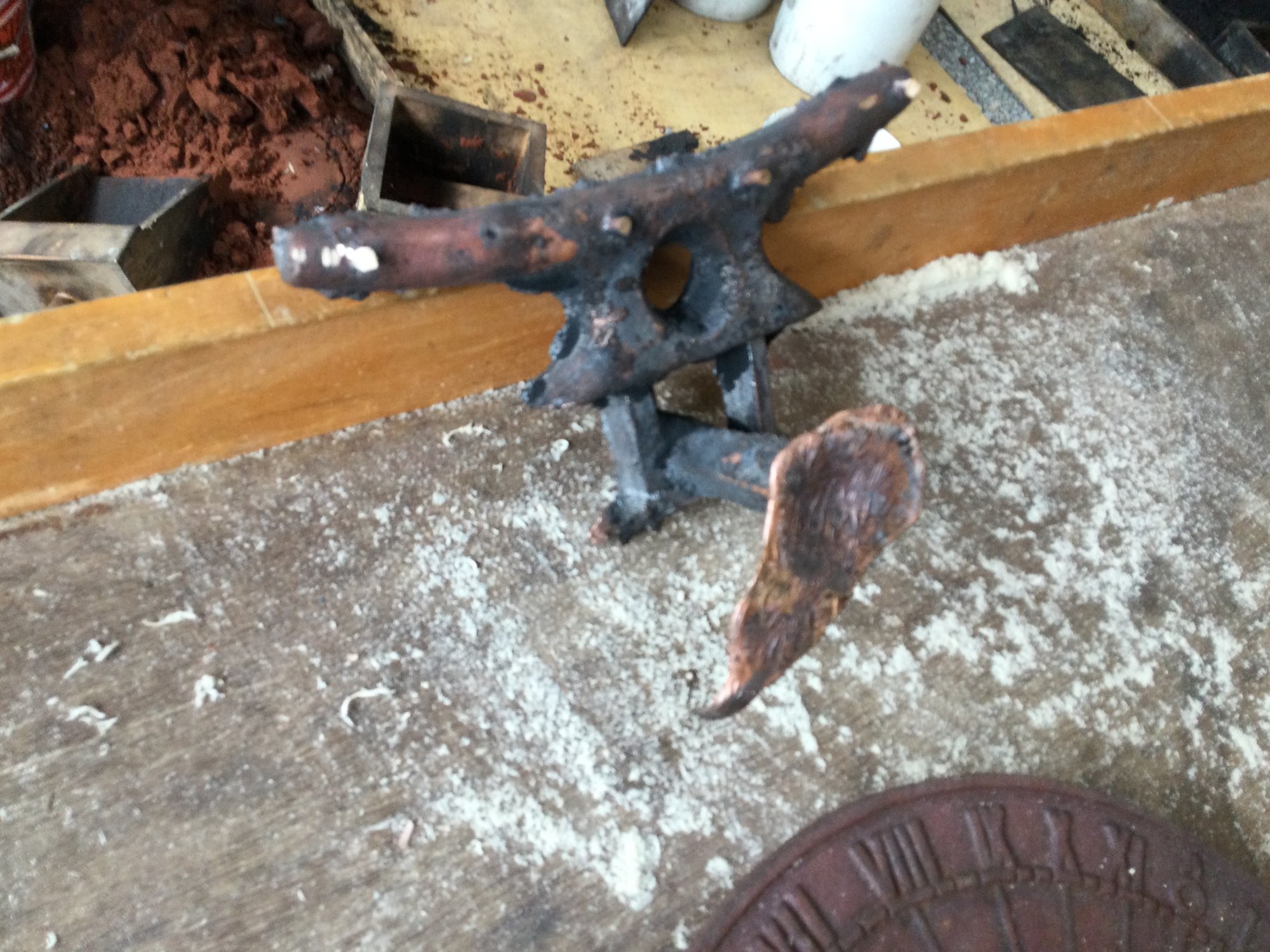

I think that's correct. They are the sprues. Hexagonal because that is what the wax or whatever pattern was. Beefy for good dense casting and to limit shrinking while cooling. It's likely they can be re-used in the next casting.. ...Based on the small photo, what is there appears to be hexagonal ?
I am guessing that that is simply the passage for the molten bronze...
