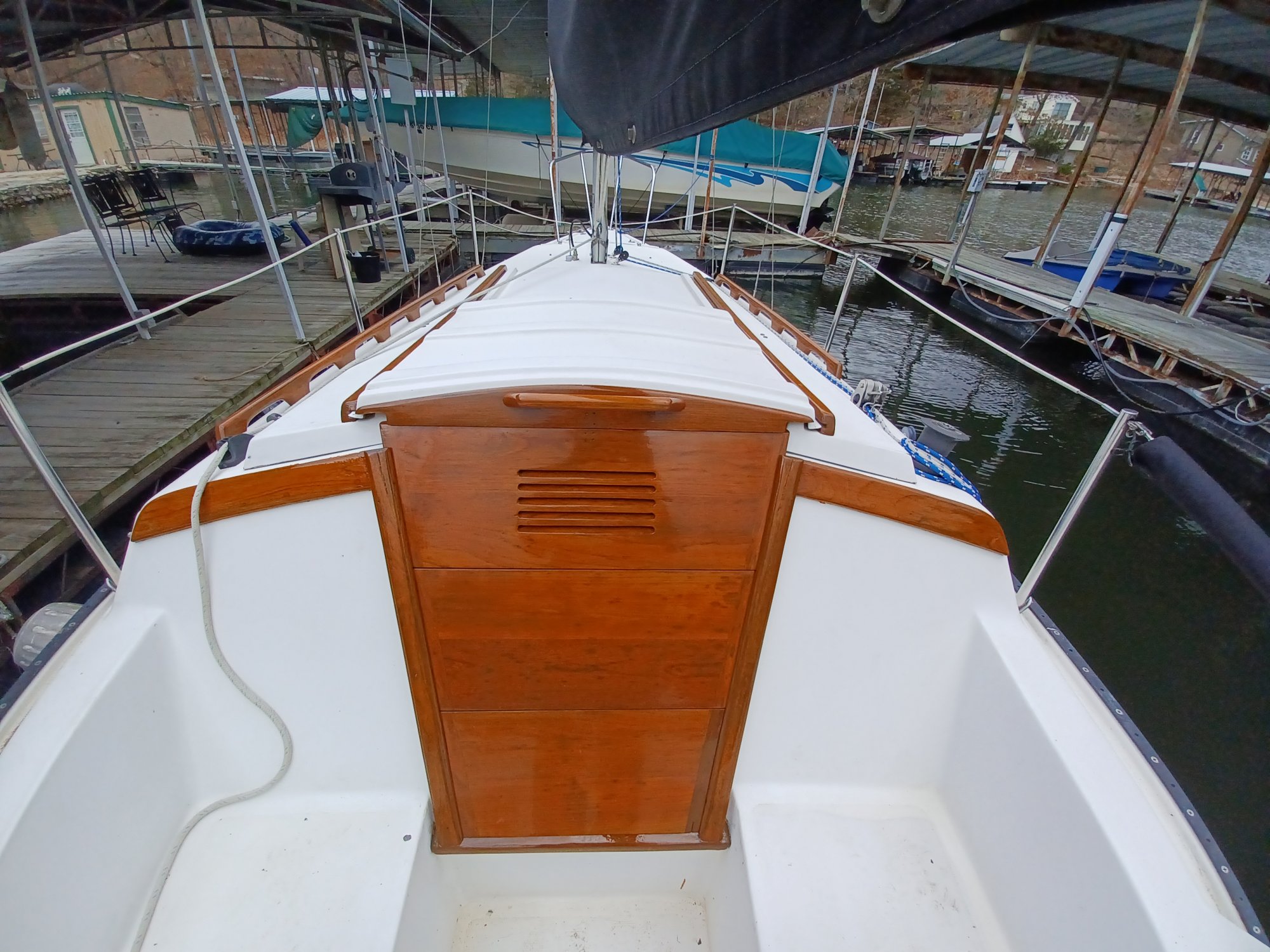

i have a 1981 Hunter 30 and sure that the products have advanced alot since then. That being said what products have the most success nowadays for outside stains/ and those for inside the boat other than teak. And for the outside food I see some that have a polly type hard coat is this correct and is it genarlly the best options?
