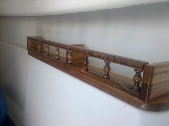

If you are looking for a lower cost hardwood the works well outside try Sipo it looks like Mahogany but is less $$$. should be able to get at any hardwood/ woodworking store like Woodcraft Supply. I teach woodworking class at a woodcraft and would be happy to help if i can.
May 26, 2010
14
Macgreger 26s boise,id
you can also look for African Mohogany also less $$.
thats what i made thiis holder out of.
the rails are from home depo just stained first then finished with
system three marine finish.
