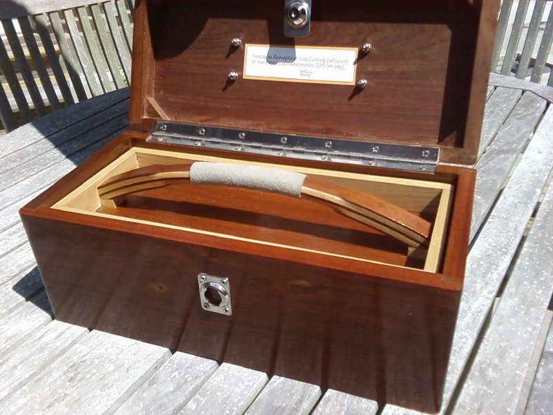

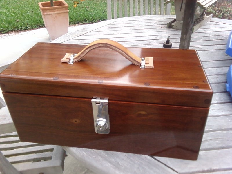

10,216
IPE looks OK
An example of what the IPE can look like. This is a hand rubbed tung oil finish on the sides. The unfinished wood is the underside of the lid.

I am guessing this is more of a jewelry box than a rusty wrench tool box, very nice.

Troutman, It was a gift mostly made by a dear sailing friend who's since passed away.. He was pissed that I didn't put tools in it.. but yes, it is a treasure on display in my garage without rusty tools in it. The only part I made is the tray..
