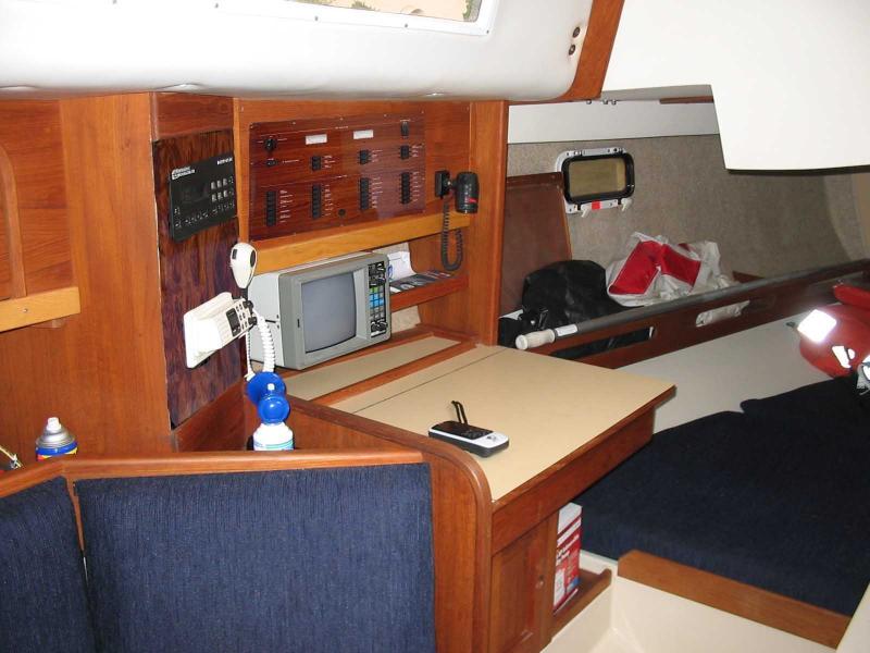

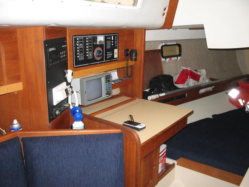

Removed old stereo & loran system from panel. Two big holes in black plastic panel, would like to replace panel with wood. Where can I send this out, also the switch panel I'm thinking would look nice in wood. Thoughts? Suggestions? Thanks.

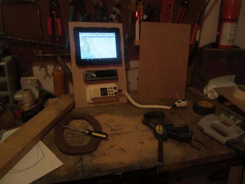

Boulter lumber is closed today, but I had a cabinet end piece lying around to practice or see if this will work. Easy enough. The plastic was 1/4" lumber same thickness, only one edge will need finishing, I'll only need to match stain, or come close. The switch panel can probably be done with a veneer., I'm moving slow but will update with photos, labels powerpoint sounds like a good idea. Thanks all for input.

So Boulters lumber ripped my piece of marine grade ply needed for job, reddish mahogany veneer seemed to match wood closest, $25, in for dime...so I practiced cutting VHF/Stereo holes on my (practice) cabinet end piece. Now that I have an idea and template, I'm ready for the next few steps, trying my plan on the actual piece. My new set-up is a space for i-pad, stereo and VHF below, with wood back. Feel free to criticize/compliment, (with google and a SBO fraternity I can do anything, including open heart surgery) and so I am moving on...

Bill, As far as color matching. I used Teak Marine Plywood from Boulter (I got a 1/4 sheet and cut out pcs. for my needs) and I applied Min Wax Poly Shades Pecan. After a few coats with light sanding in between, the color matched. It got slightly darker with each coat. I then put on a coat of Min Wax Clear Satin Finish. It came out great. I was replacing some vertical paneling in the galley area. I then coated the rest of the galley area wood with the Min Wax Clear satin.

Very impressed with Boulter lumber...paint store tomorrow thanks for the advice... I've got a matte finish on interior wood, I think satin finish will would work well on panel. Dremel tool worked great on cutting holes, winter projects...if they're were none I'd missed that old boat.
